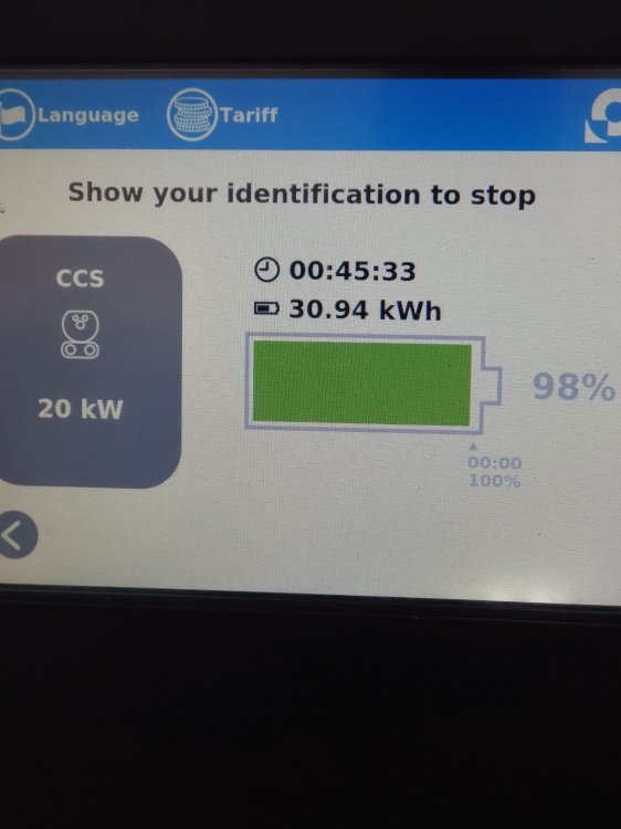

One thing that sometimes needs doing in the cold, which i had to do 3 nights ago was go make sure the charger head is properly in tight. Plugged in when warmer or dry or wettish, then when the temp drops it is just not quite fully in enough. There will be those charging last night at minus 10 in Scotland and much colder than that around the world. Heading off to Tomintoul later if the road from the south is open. Will not need to charge there which is hit or miss at the best of times, but might need to charge someplace if i take an alternate route home. Head to Aviemore or towards Aberdeen. Tesla Superchargers.

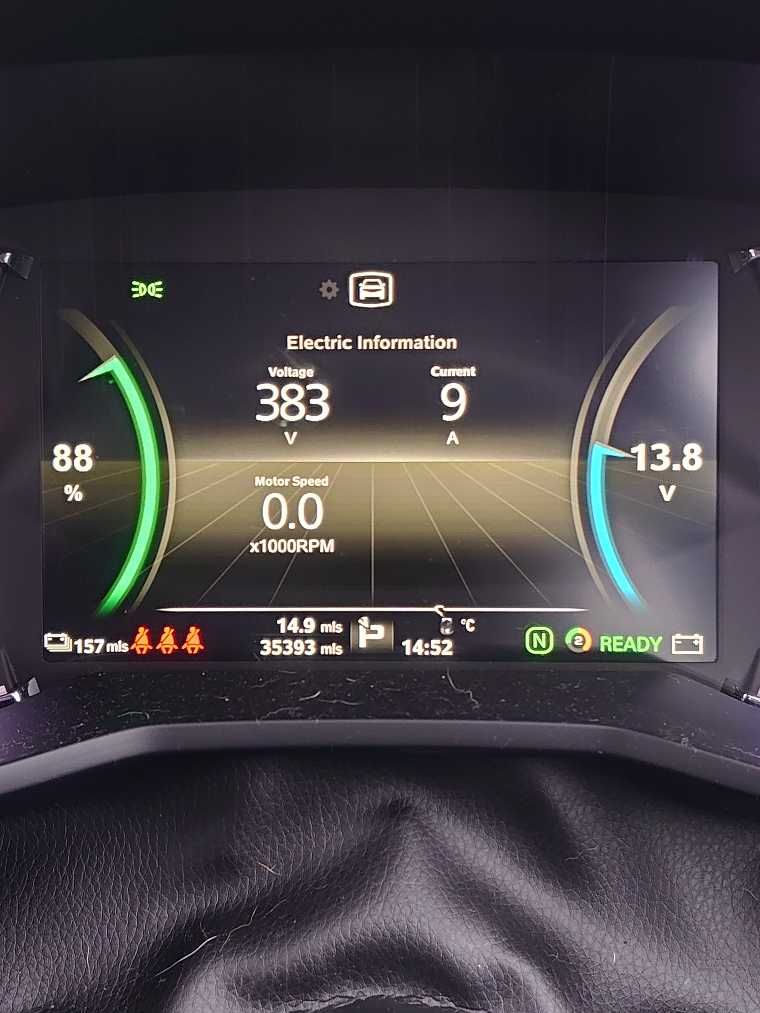

I have my Renault 5 Evolution model, 40 kwh battery nominal, 43 kwh actual, repkacing the good old Zoe which was 52 / 55 kwhs battery size.
Here in middle England where we do not get much sea temperature moderation we had -5c at night and not really above zero by day.
R5 and Mini showing 120 mile range when charged to 80 to 80% OMG.
Just charged the 60 / 65 kwh Scenic abd that is showing 165 miles at dawn.
Trip to stag do in Bournemouth is going to be a challenge as is about 130 miles cross country or 160 miles using faster motorway and charging stops not great in Dorset and Wiltshire. Challenging.
Edited by lol-lol

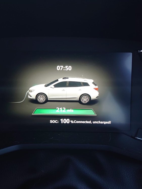

2020 MG5 EV 52.5 kWh (48.8 usable.) @ 100 % and minus 4*oC showing 177 miles recently and good for 165 miles. & when charging at over 95% on 50 kW CCS chargers can be charging at 20kW.... Old technology. No phone app, no useless info and easy to use controls. Even the Sat Nav surprised me how good it is. If the battery needs charged up fully then just as well to do so if needed or maybe needed to be sure to get safely to your destination or the next charger and allowing for possible diversions on wintry roads. Below not at low temps, but the charge speed can be the same when cold. 100 plus miles added in 45 minutes on a 50 kW max charger.
Edited by Evolution13

@lol-lol Warmer but torrential rain and AC and Demisting screen on all the time.@ 14 V here and usually 13.8-14.1 V shows & then at 14 V steady. It would pretty much do 160 miles at this state of charge. 89%. Voltage 383.
