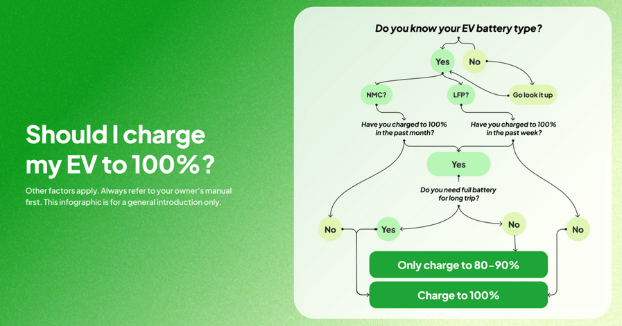

I too did research before buying an ev
Screenshot 2025-11-24 at 12-52-37 Should I Charge My EV To 100% How It Depends On Your Battery.png
Use it to do what you want to. Charge it appropriately if you need 100% and are using it it's not really a problem
In the earlier days, most experts warned that using fast charging (DC) leads to more degradation over slow charging (AC), due to heat and plating at high C-rates. Especially in the cold.
In real-world fleets, the picture is more nuanced. Recurrent’s 2024 analysis of ~13,000 Teslas found no statistically significant difference in range degradation between cars that fast-charged most of the time and those that fast-charged rarely.
The more practical rule: avoid extremes (very hot, very cold, or very high SoC), and don’t waste time forcing DC from the 80 to 100% unless your trip requires it.
