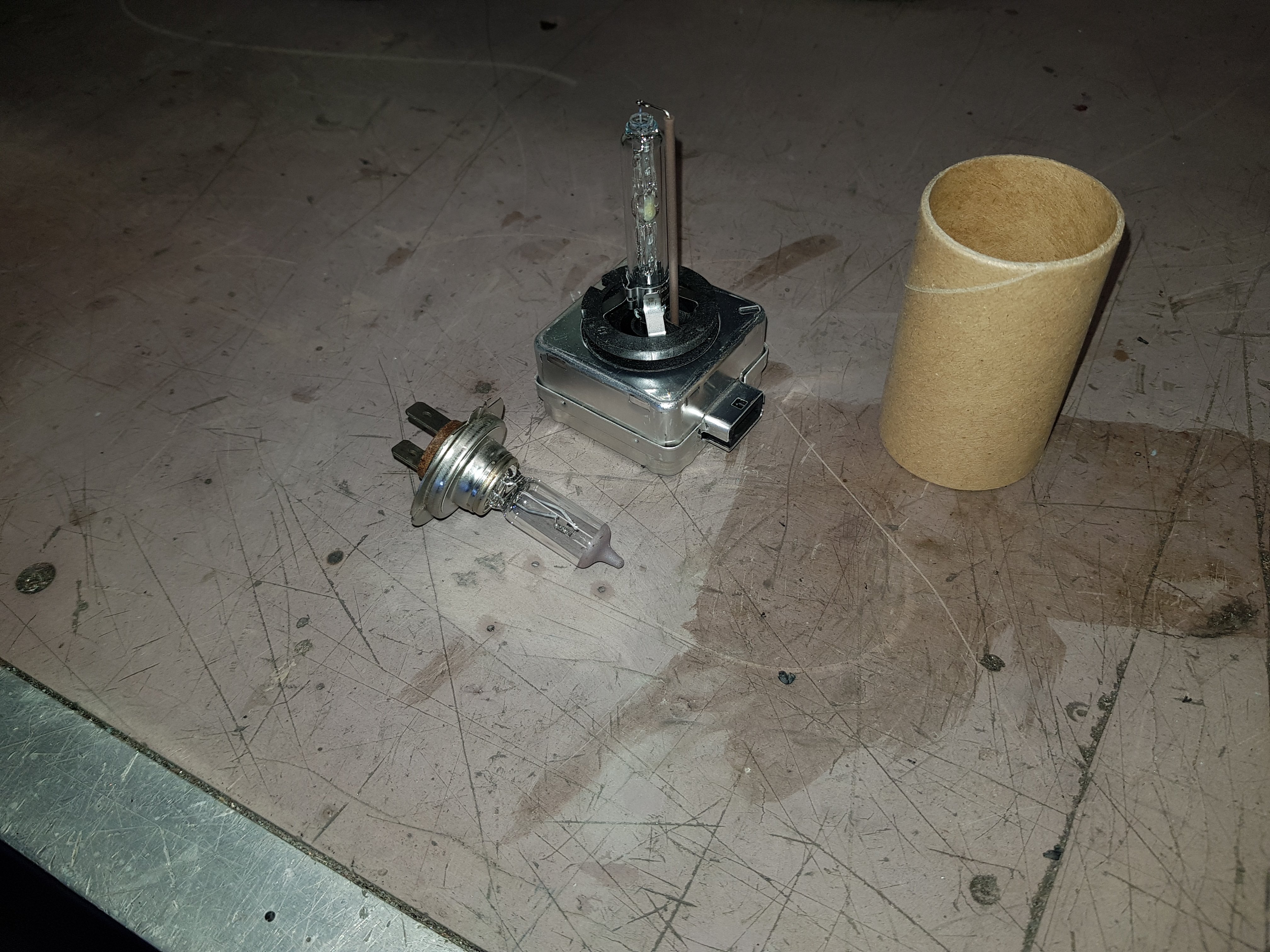

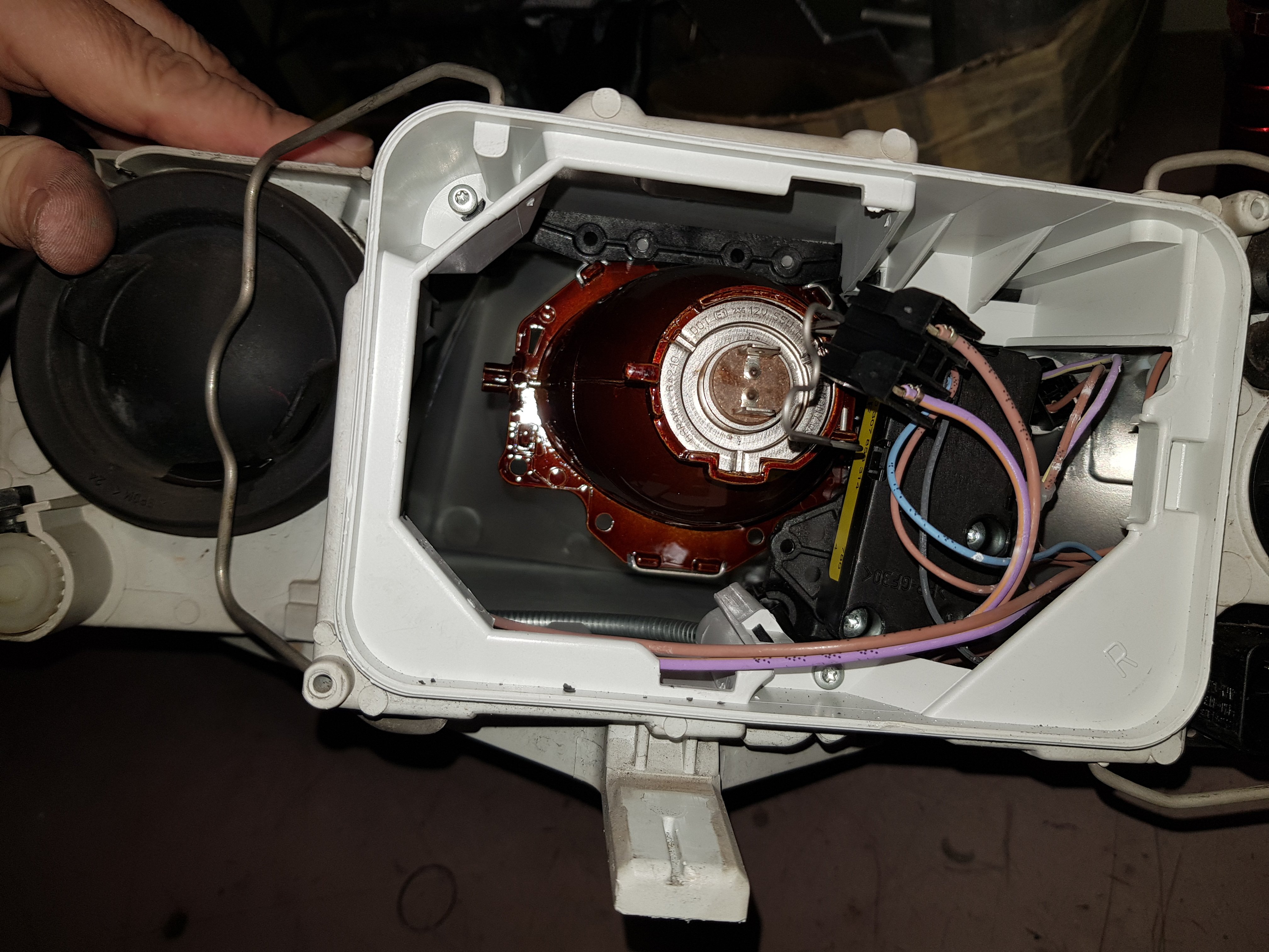

Well wants and bought some new H1S xenons lights to go in  pulled the old lights out to be greated with normal   headlights.
