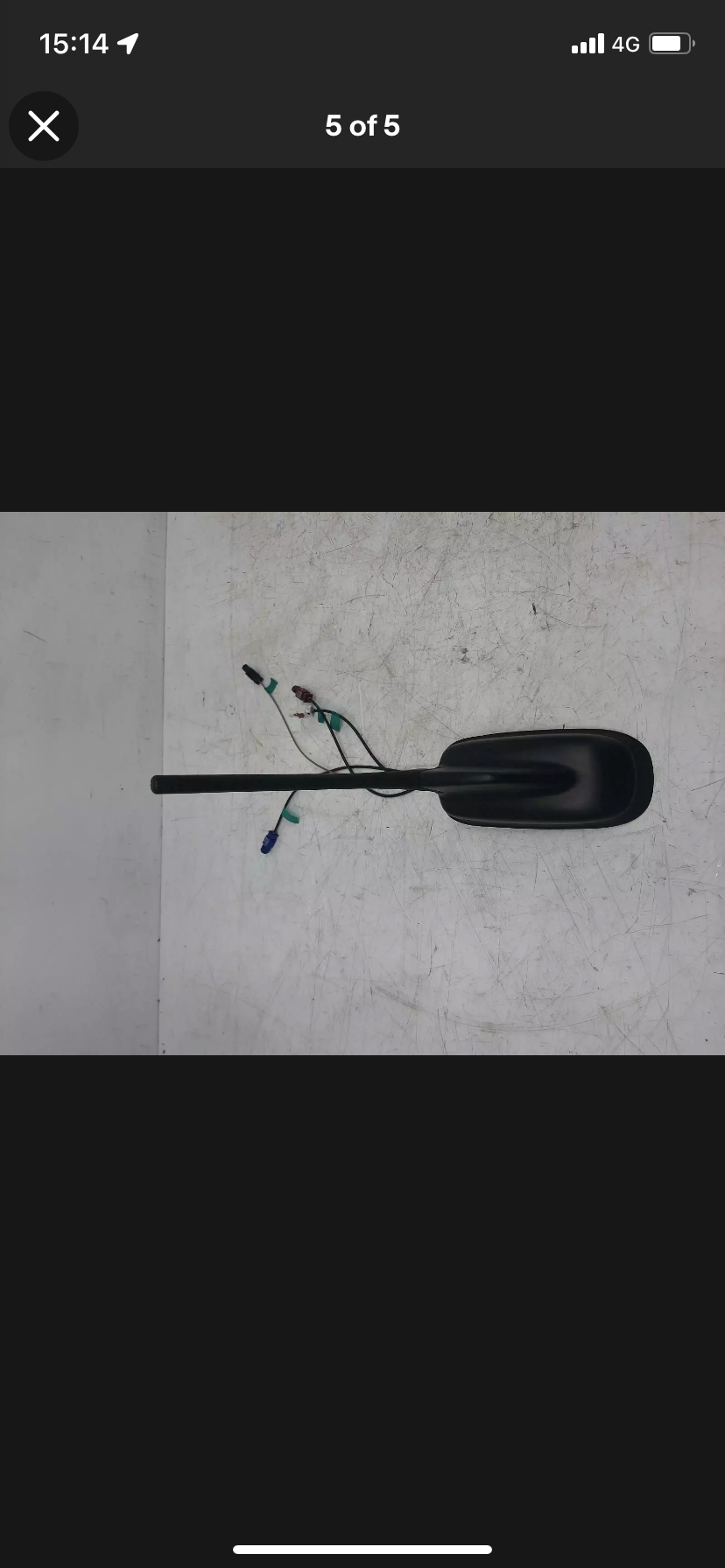

The head unit I’m looking at comes with the below aerial which looks like a fin? Unsure if it’s genuine. I’m guessing I’d need to find longer cables to extend them to the HU?
yes you would need longer wires for "each" signal from the Antenna you want to add, so:-

Got the unit now, bluetooth and DAB, plus it came with the aerial linked above. Thinking I may as well fit that and save having the DAB aerial on my windscreen. Finally got it unlocked but need to fit a microphone still.
Will I need GSM?
I’ve found these cables which I think are correct? Is 3M enough?
https://www.ebay.co.uk/itm/234560222806?mkcid=16&mkevt=1&mkrid=711-127632-2357-0&ssspo=dReLuv63TW6&sssrc=2349624&ssuid=ODyeQu5OSBq&var=&widget_ver=artemis&media=COPY
You don't need GSM, there is actually no connector on the RNS unit for it, it's for when you don't have an RNS unit with built in bluetooth and you have a seperate bluetooth module, "some" of them have a GSM connection, but to be fair in the old days you needed it more, mobile phone coverage is so much more superior today, really not required anyway.
The link you posted is for 2m, which is def not long enough, I personally think you need around 5m., approx 1/2m across roof from aerial, then 1.5m down and along the edge of the roof (above doors) then 1m down A pillar to behind dash, then 1.5m across up behind the dash etc with some to spare behind the radio. It always better to have to much.
You def need this connector for the unit end , cannot remember if its male on the aerial, I think it is, so this would do I think (please check your connection plugs)
