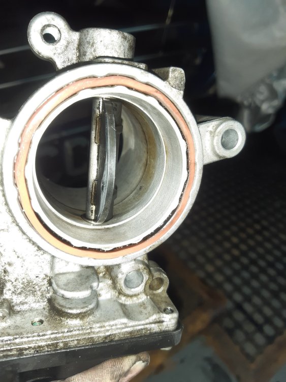

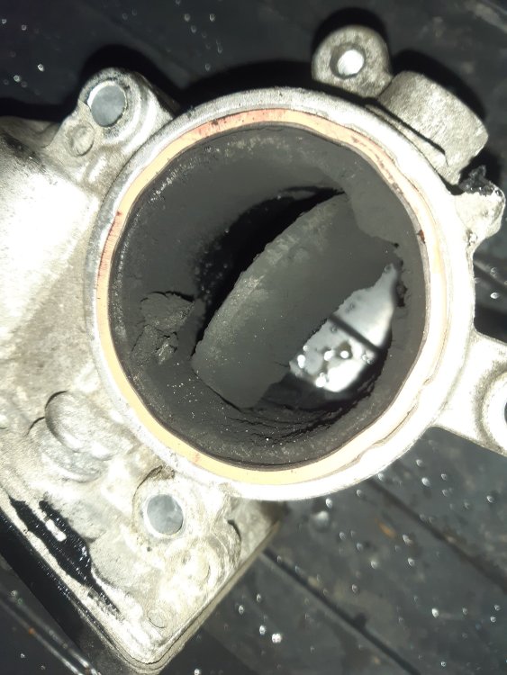

However the tick over was still quite lumpy and the error code P0121 Throttle Position Sensor was back. So I took the throttle body off to find it was filthy! Though hardly surprising with such a high mileage. I used a plastic scraper an old tooth brush a piece of Scotch Brite and almost a whole can of carburettor cleaner and cleaned the throttle body. The lumpy tick over was still there for a few more days until it settled down and the fault code has not returned. Reading up some more what I should have probably done was use VCDS and re-coded the throttle body to return it to its factory settings to stop the lumpy tick over straight away. The throttle body self calibrates to compensate for any slight variations which it must have done when it wasn’t closing properly before I’d cleaned it, and now its calibrated itself back to where it should be.
You can turn the pipe from the egr  that goes into these to stop this happening again
Here is a well explained  How To from the forum
Yes I have seen that post. Though would deleting the EGR be a better long term solution? I've had so many cars over the years that have had EGR related issues which to me seems to defeat the whole reason for having them in the 1st place if your engine isn't running as well and cleanly as it could.
