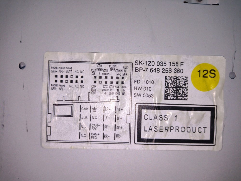

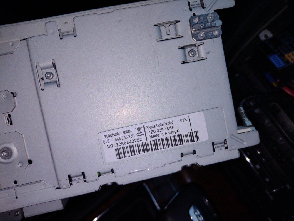

I’ve taken it out and it’s a Blaupunkt. Sticker pictures attached.
What different versions are there and do they have different capabilities?
Is there a model number like RNS3xx?
I’m considering “9W7” modules.. incidentally why are they referred to as this as I can’t see that numbering on the ones I’ve looked at.
My priority features are hands free phone calls and audio streaming. Control via the HU is not important to me as I can control via the phone itself. I don’t have maxidot or MFSW.
