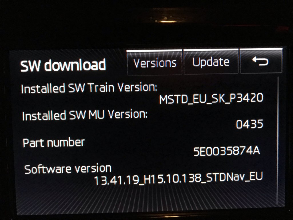

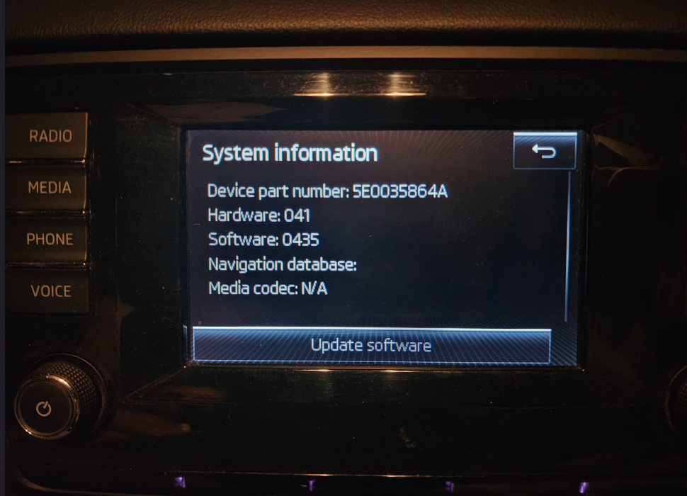

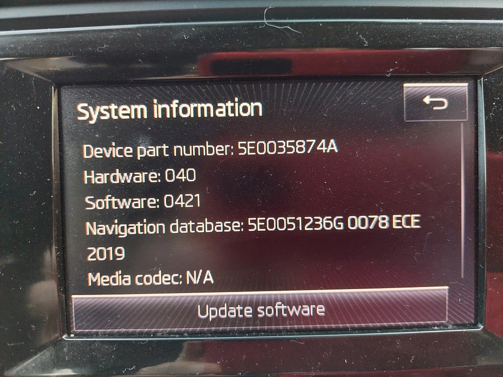

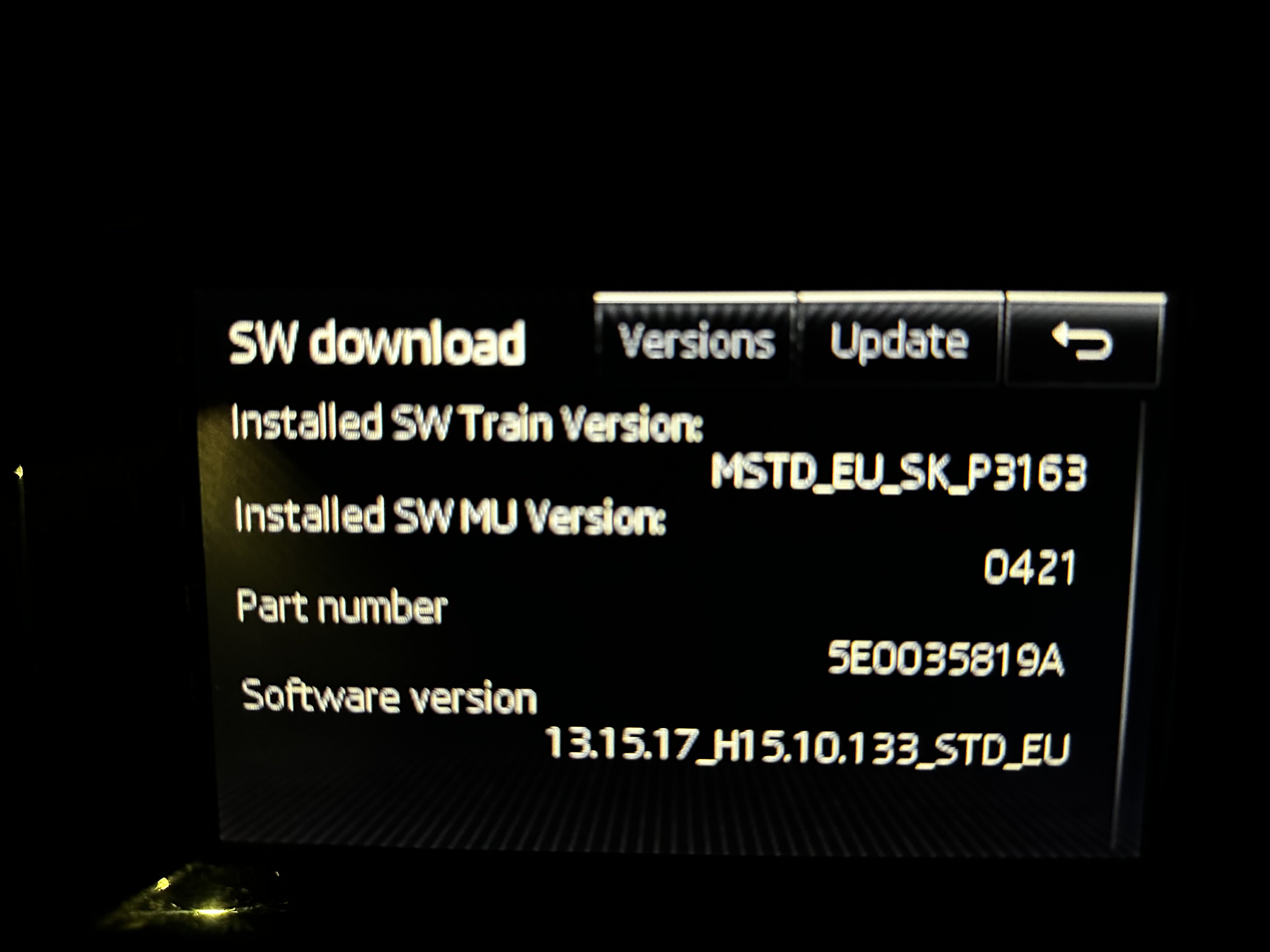

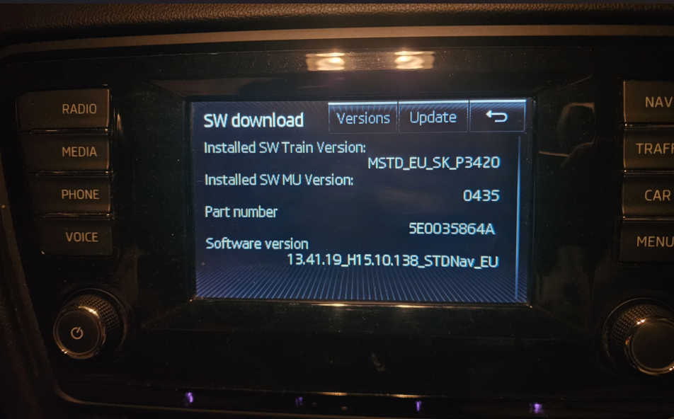

Check and Confirm what sort of unit you have.
Press and Hold Menu button for 5 seconds. Obtain below data as pictures and refer to another source to obtain the correct and appropriate files for download.

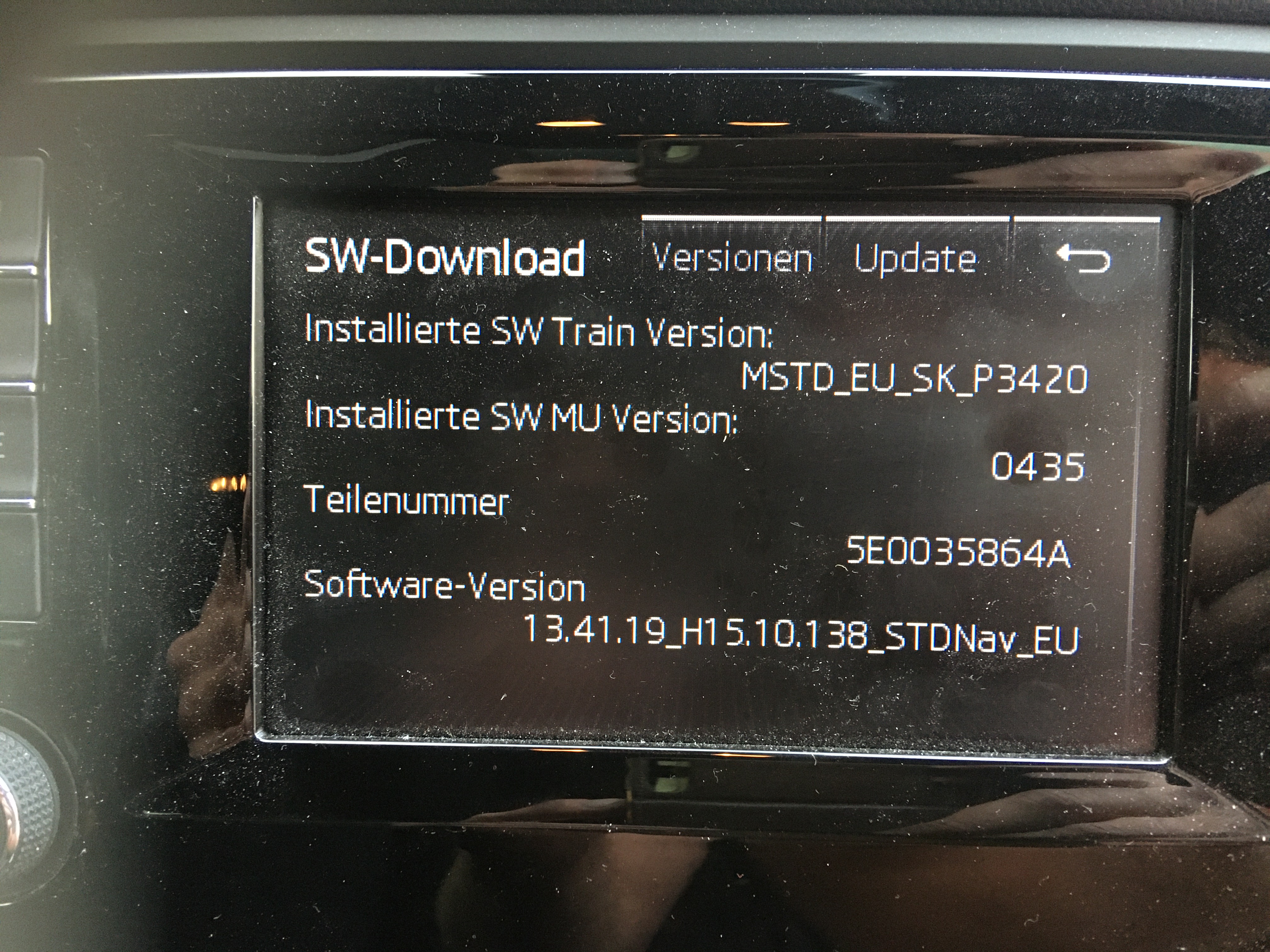

Format an SD card as FAT32 (mine was 32Gb). (Use a clean one not your SKODA one)
Using 7Zip extract the contents on to the SD card.
    --- This should leave 3 Folders and 1 Text file on the SD Card.
With the car ignition off remove any inserted SD cards CDs and USB media.
Insert SD Card containing the Firmware Update in to slot 1
Attach battery pack \ charger confirm it is working as expected.
-----  TURN ON IGNITION ONLY  -----
-----  DO NOT START THE CAR  -----
-----  ENSURE LIGHTS ARE OFF  -----
-----  ENSURE AC \ FANS \ HEATED SEATS - ETC ETC are all OFF  -----
Power on the ICE unit
Press and hold Menu button again for 5 seconds
Choose Software Download Versions
Select Update
Select the source (SD Card) [all others will be greyed out]
Select the Release version detected
First the Metadata will be validated
Press Start
A note is displayed say how "The update may take longer than 60 Minutes to complete and not to start the engine or interrupt the process once started" is shown
Click Next
The appropriate code will copy from the SD card to the unit
The Unit will now restart and then download and restart multiple additional times (About 15. I lost count).
     (Up to this point the process will have taken approx. 20 mins)
The Software update process will now create a "Mirror Copy" (multiple horizontal lines showing a copy percentage against each of them)
When each line has finished its copy and reached 100%; The Unit will reboot, upon resume it will start on the next line
The Unit will start another set of multiple Software downloads and restarts.
The Unit will restart again
When the screen Titled Software Update Result is displayed
Click Update Summary
Review the updates applied and return to the previous page.
Click Close
If displayed Cancel the Diagnostic Tester warning to check for error codes. These will however be visible to your Dealership upon service have them cleared for best practice.
The Unit will restart again. [For the final time]
Once the update has finished wait 5 minutes for any last background processes to complete

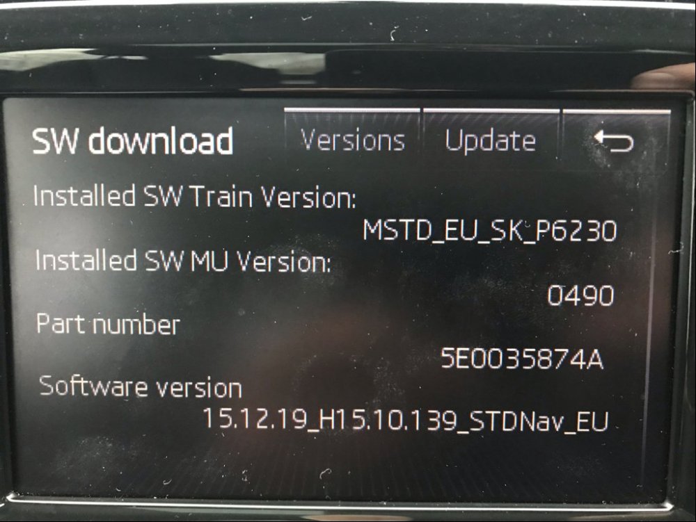

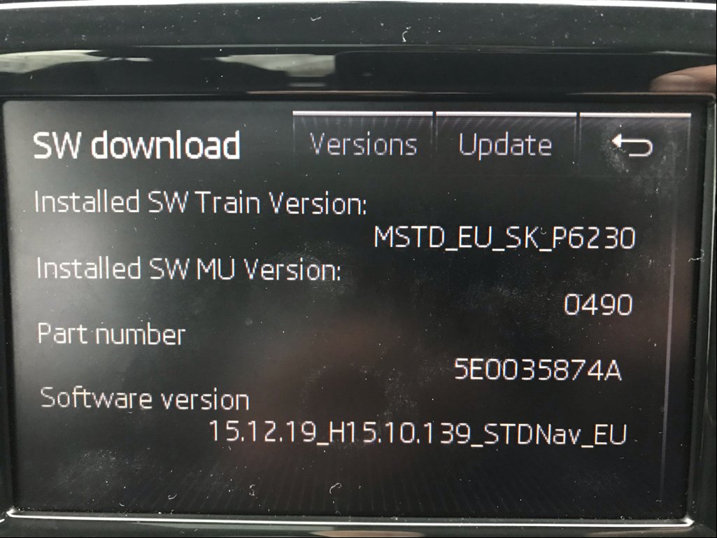

Press and hold Menu for 5 seconds to confirm the new version is running. (Now expected to be 0490).
I Started at 12.05 and following the above my update was complete by 12.48
Issues in 0435

Status in 0490
Touch Screen 100x better
DAB radio now works like DAB Radio (I live in a not so hot spot for reception.)
Playback from SD card fixed
