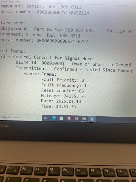

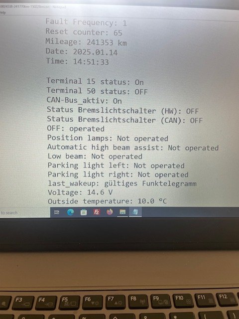

  5. Hi I have 2 codes after a VCDS check, one for climatronic and one for control circuit for signal horn, hopefully the pics are ok. Anyone have any ideas to resolve them? Thank you.

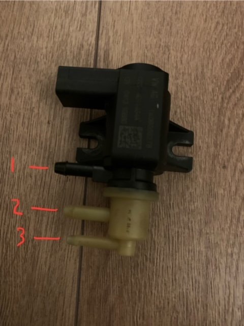

  11. Ok so I have the pipes in the correct position, does a replacement N75 need coding or anything via VCDS?
  12. Hi everyone, I have a 1.6tdi CLHA and asking if anyone can clarify what pipes are correct on the N75? at the moment mine are 1- to the air intake 2- to the actuator 3- down to vacuum pump (I think, it does split via a T piece) thanks.
