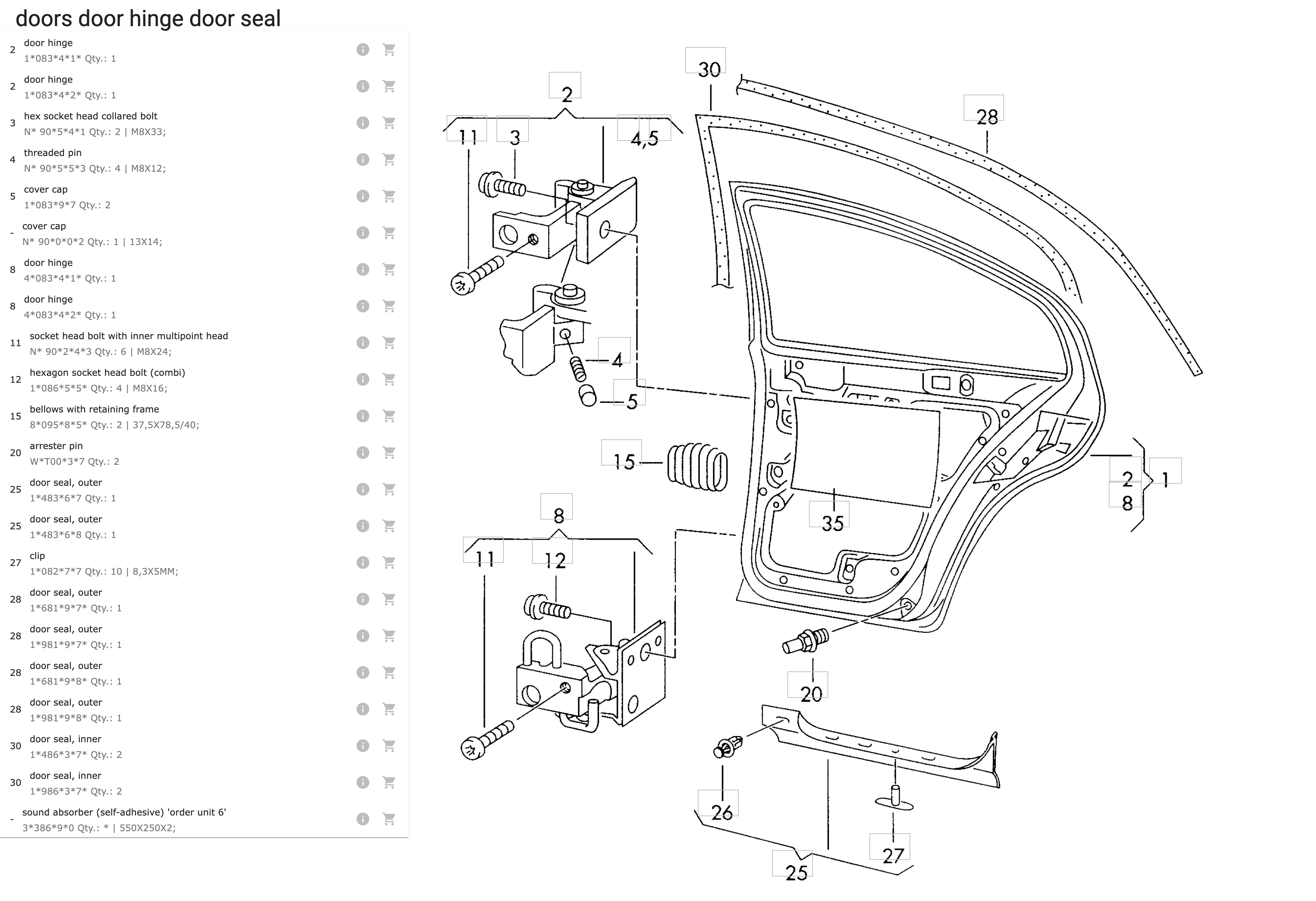

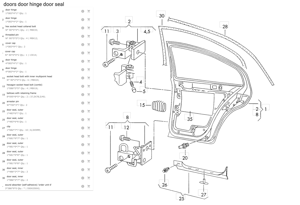

7 minutes ago, Evil said:
Searching for part numbers for all the wet weather seals for the rear doors at the mo, carpets are wet so I'm just going to replace the bloody lot...
1923058814_Screenshot2022-01-14at19_47_53.thumb.png.a19bcdc452bd94dc6226c7a5dee2965e.png

Rear carpets are limited options surely...
Door seals and/or that plastic film stuff behind the door cards... I'll just replace the lot if I can source it and it doesn't cost me an internal organ.
1500gauge clear plastic (damp proof course for building) and some scissors will make a set of membranes. some duct tape around where you need to make holes for door pull bars etc to reinforce them.
i used pvc pipe jointing compound as an adhesive to stick it on, just make sure you dont leave a gap.
