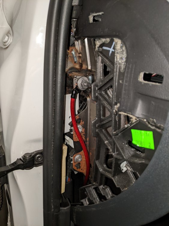

How about behind the end of the dash panel? It pops off easily enough
Brilliant, thank you! I was dreading popping off more panels but this one came off real easily and was readily accessible.
