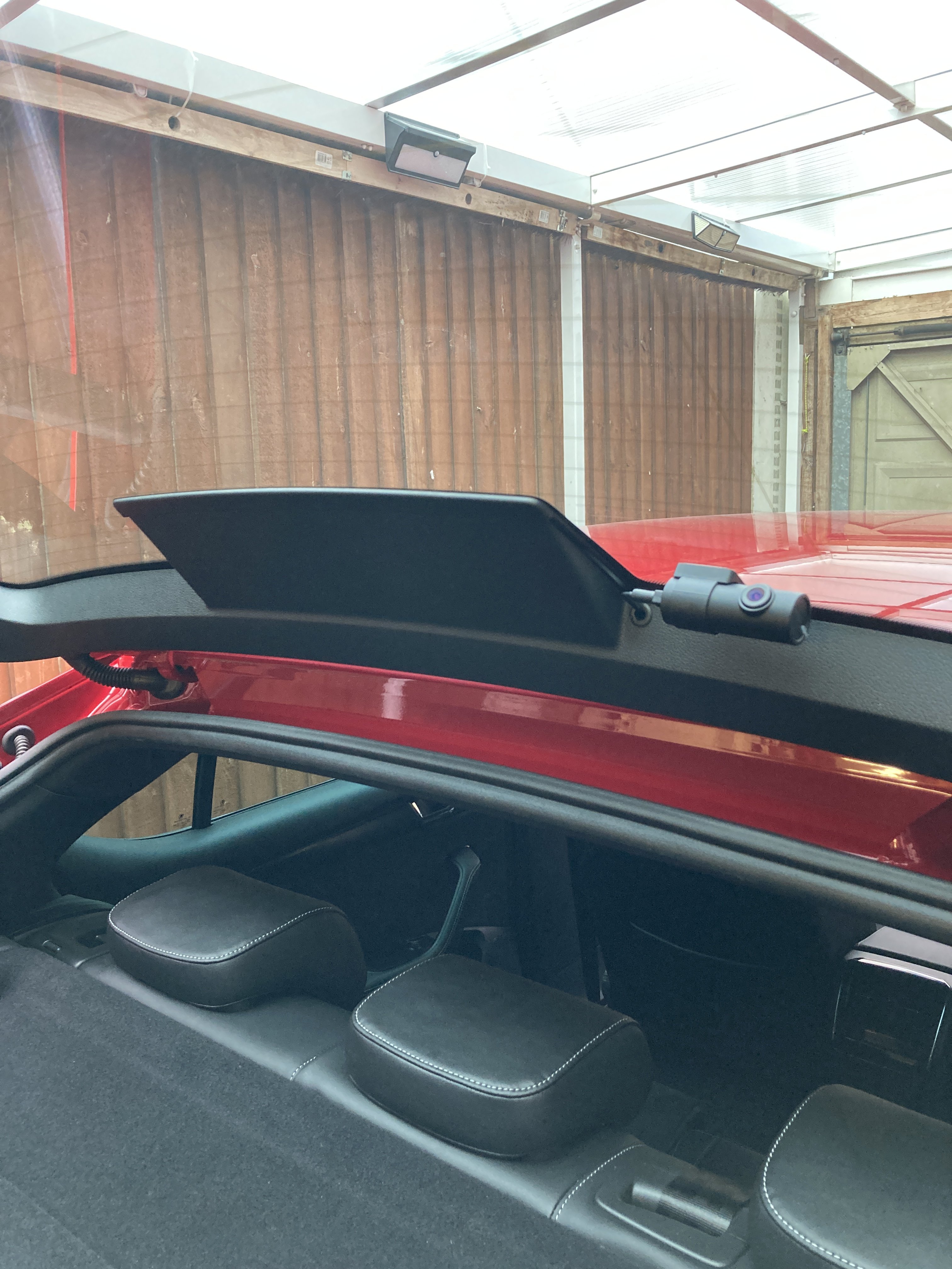

I have an iV with front and rear Blackvue cameras. I had Blackvue cameras in my Yeti and Citigo and this camera system came out of the Citigo (DR750S-2CH). I don't have the battery/park monitor.

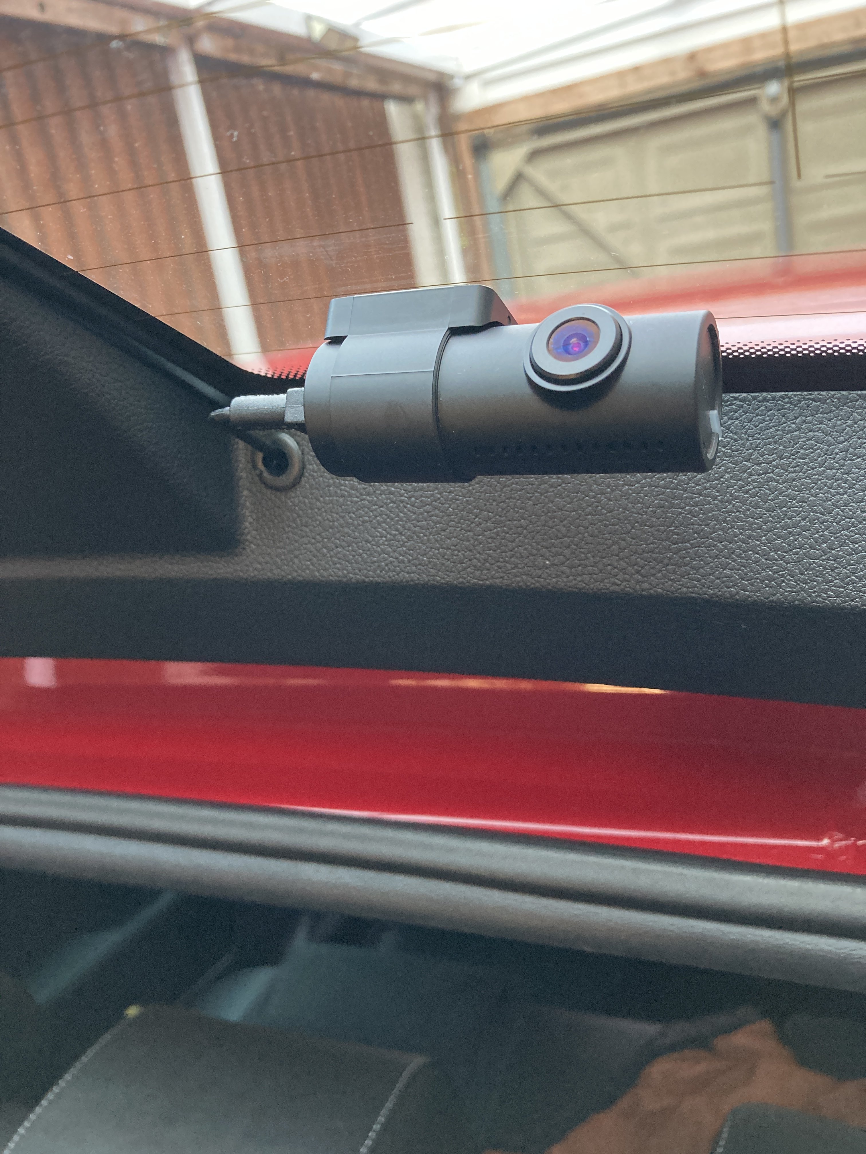

Initially, I had a cunning plan to run the rear camera cable through the headlining but decided that wasn't going to be much easier than running low down. In the end, the front and rear camera cables ran down the A-pillar to a piggyback fuse in the main fusebox. Lead to the rear camera then went down the nearside of the car and slipped under the plastic door sill cover all the way back. Then up behind the trim by the rear seat and into the C-pillar cover. Using a long cable-tie as a puller, the cable eventually went through the left wiring 'grommet' up into the tailgate and thence to the camera. The camera is mounted on the right hand side of the high level brake light and works perfectly - and can't be seen in the rear view mirror.
I've not had any problems with the cameras working or the cameras causing any issues with the rest of the car.
