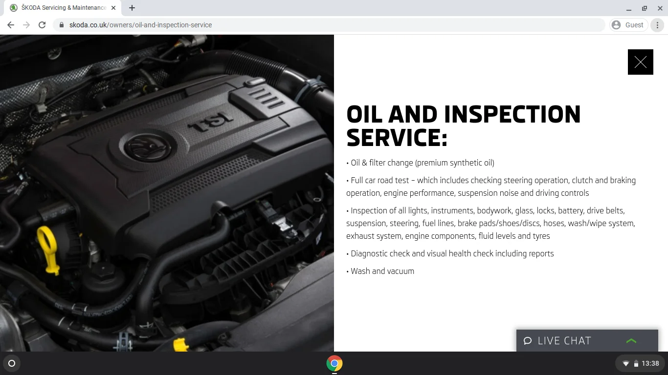

You get Independent VW Specialists with All the gear and more than ideas.
Licensed Equipment that get the TPI, Recalls / Service Campaigns and that can even do warranty work and update the system with service / maintenance work done and not just Inspection service / extended scope yet Haldex, brakes or DSG never touched and done when they should be.
Likely these independents have  Ex Main Dealership Techs / Master Techs that were fed up doing the little work a Main Dealer Service actually involves.
So a good Full Service History with receipts and Invoices for stuff actually done is better than a FMDSH that just shows that there was servicing. That is for people wanting a well looked after car. WBAC/ Cazoo etc might just want FMDSH which does not mean they were serviced to the manufacturer's recommendations or guidelines.

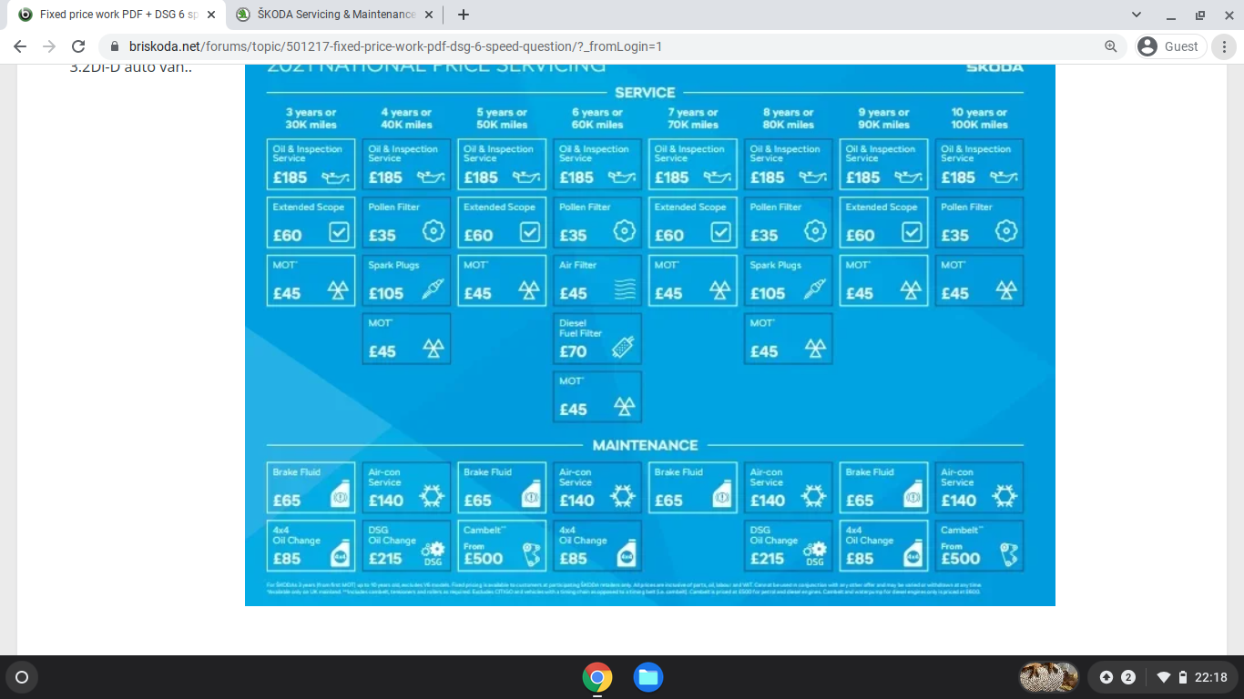

@DannylachampDoes that plan have All Servicing coverage then.
Pollen Filter @ 2 years & 4 years.
Brake Fluid @ 3 Years & 5 years.
Haldex Serviced @ 3 years.
AC Servicing.
DSG Service @ 40,000 miles.
This is just an idea of what Skoda UK shows as the servicing from year 3 on.
The DSG is not at 4 years it is @ 40,000 miles.
