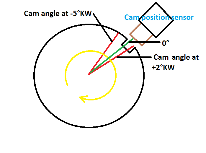

  5. Hi @SailorBob74133, Have you learn what mean the positive values? Is it good or is it bad? I also checked mine and intake 1 phase position is 1.5 degree. Also I found this on another forum. Which says few positive number mean it is all right will correct its position but if that positive number is too high(65 degree) that means chain installed incorrectly. Note: I am not sure about this info but this is what I got on internet
