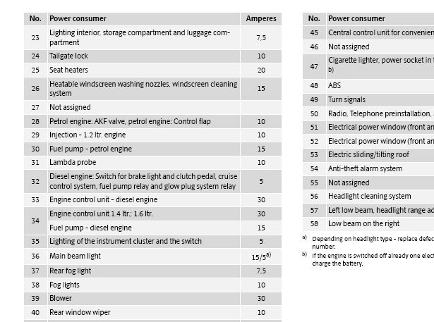

There is a listing in the owners handbook suggesting this has a dedicated fuse - no.37 - which may be a good starting point. I would then suggest using a multi-meter to check for voltage at the contacts in the bulb holder, as a visual check of a bulb is not really accurate enough - have you actually tried a different bulb. The next move is to check if you can remove the switch and power the light with a piece of wire bypassing the actual switch contacts, someone such as Wino will hopefully be along soon to advise on terminals.

I did check the fuse, it is whole. But I will use a multi-meter and try a different bulb.
