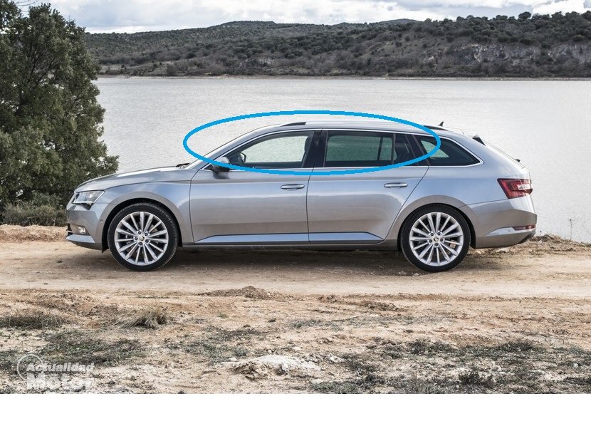

Window rubber moves and lifts chrome tailgate strip.
As I say in the title, the upper rubber of the front window moves backwards and makes the chrome strips of the upper part collide, causing them to collide with each other and lifting the rear one.
They ask me 375 euros for each of them in the Official Service. Does anyone have the workshop manual to know how they are removed and how to put new ones?
