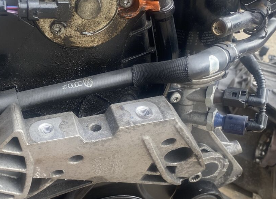

Maybe I can help with a rather good photo from an ebay listing:
I would say it doesn't matter at all which one is removed to check the oil pressure, they appear to connect into the same gallery.
I had a 2011 and I didn’t remember the 2x switches,,,! Anyway, good photo. I’m intrigued why two switches into the same gallery? I could understand at 2 different locations say pre oil filter or post or somewhere else on engine!
Thinking One is probably a temp sensor.? Could check by unplugging..
edit. Seems two oil pressure switches set up at different pressures. Possibly one for idle to 2k rpm, other used above that.

Yes Pete is correct in that photo,just under/near the oil filter.one on top of each other with brown on top abs blue under it,there are 2 oil pressure switches.

Yes OK. I can see the blue one says its set at 2.5 bar. But as Pete discussed it won't matter which one you test out of.
