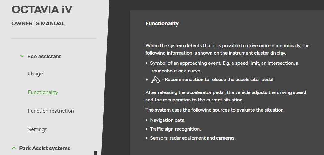

I don't have an IV (I am contemplating one at some point) but I was interested in how the auto regen works?
I as understand it (screenshot from manual below), as long as you specify the right options, it uses the Satnav and sign recognition etc to figure out what the situation is ahead and then sets regen levels accordingly. So I guess if you're coming up to a roundabout, the regen is quite strong?
If so, it's interesting as it means you do need to keep the Satnav up to date to make the car function properly?
If you just ignore updating the car Satnav, and use Google maps or whatever (as I suspect many people do for navigation purposes) , the car presumably won't drive as efficiently?
OctyIV_Manual_202008_Recuperation_EcoAssist_Functionality_Screenshot 2022-07-18 184901.png

The system in my IV works completely different to my e-Golf.  It is much more sophisticated, although not consistent.  In my e-Golf in 'B' mode (highest regen setting), I know the more I take my foot off the accelerator, the stronger the regen and quicker we slow (used around town only.  I use no regen on the motorway, free wheeling which improves range).  In my IV and in 'auto' mode, as you pointed out, it uses systems listed above to evaluate the situation and therefore determines how much regen to apply.  Although clever, in every situation you are not aware beforehand of how much regen the car will apply and I find I have to apply the brakes myself much more and in some cases, harder than I would usually.
The sat nav doesn't need to be programmed for the car to use.  I don't programme the sat nav for driving around town for example and I have come up to a number of roundabouts with no vehicle in front and the car recognises the roundabout from the sat nav I assume and applies a higher portion of regen.  However there are roundabouts on my route which the car doesn't recognise and applies hardly any regen.  I tend to find the system works better if there is a vehicle in front where the radar also helps to determine the amount of regen in order to keep a safe distance.  Although, again it sometimes is a bit dumb and may not apply regen hard enough meaning I have to put the anchors on to stop the car going bumper onto bumper.  Inconsistent as I mentioned, which is why I tend to set the regen on 'high' giving me more control as I lift my foot off the accelerator.
Don't get me wrong, it is a very clever system.  Regenerative braking is like marmite.  You either like it or you don't and coming from ICE vehicles, those who go down the gears in a manual gearbox will probably adapt to this feature easier.  Others in an auto may take more time to get use to it.  My wife drives an auto and loved the one foot control using regen on max in our e-Golf.  However I don't think she would like the inconsistency the IV gives when in 'auto' mode.  In 'high' or 'low' setting, I think people will adapt easier as there would be more consistency in how much regen is applied with the driver controlling this.
I hope this helps.  Another thing to note, is unlike a lot of the other features in the vehicle, once the car is turned off settings applied tend to go back to it's default mode.  However the regen setting remains as set by the driver as part of the drivers profile which is nice.
