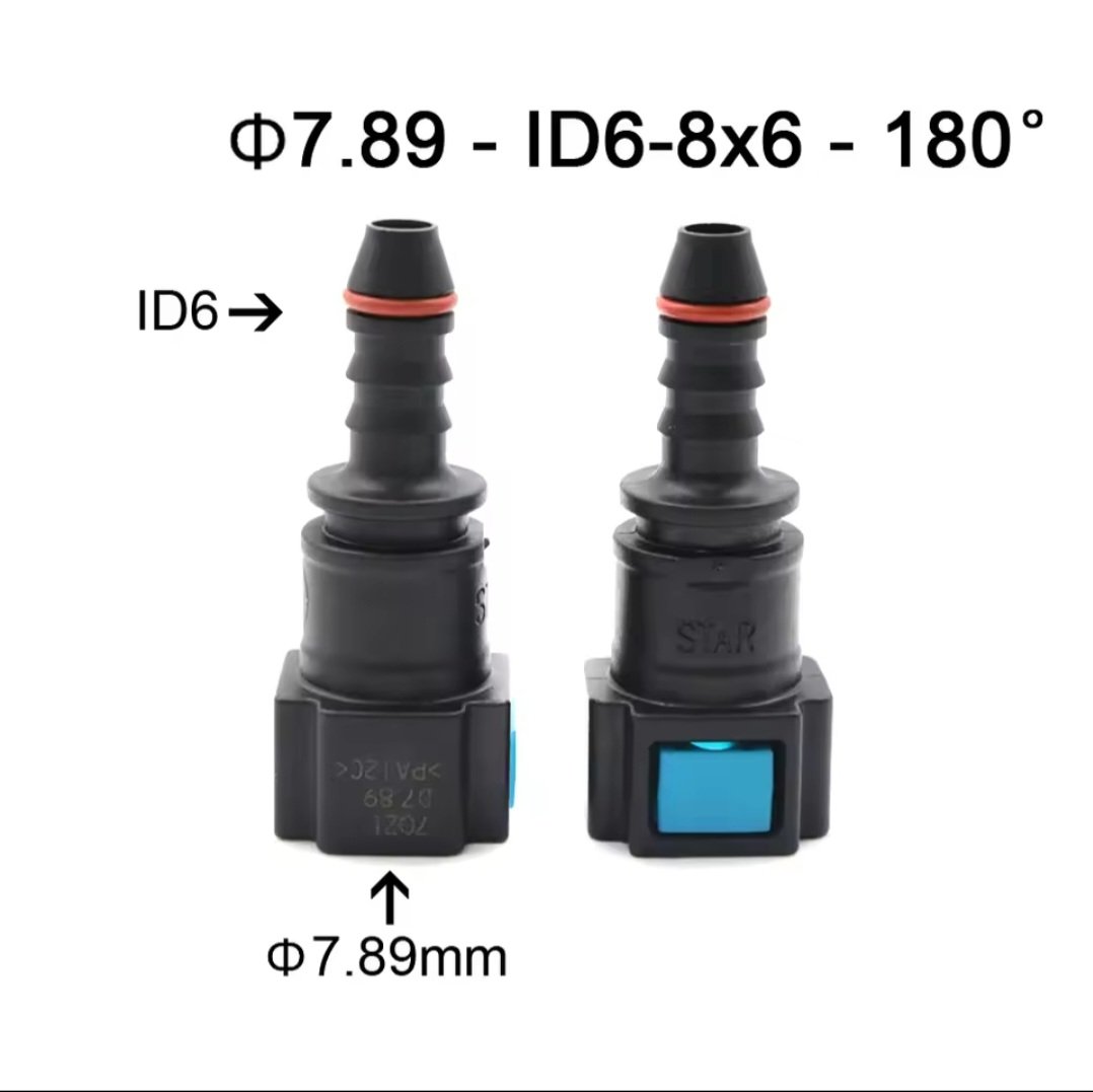

I was thinking of adding a fuel filter to my 1.5 tsi in a Skoda Karoq, simply insert it somewhere between the low pressure pump pipe and the front of the engine, measure the pipe diameter, buy 2 adapters, drain the fuel so it flows out of the pipe and blow it out with a compressor so that it doesn't catch fire when heated with a hairdryer. All of this is universal. filter, fittings, pipes..
