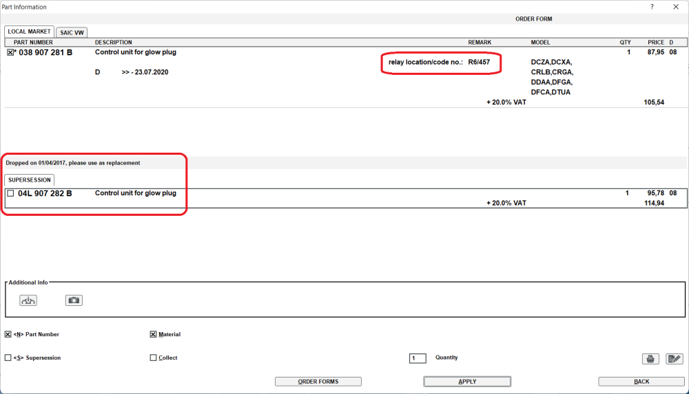

J179 Glow Plug Control Unit also known as a Relay
Sits in the E box in engine bay
Pay attention to the part ordering, as you can see, it was dropped on 01/04/2017 for part number 04L 907 282 B
Brilliant, thank you!

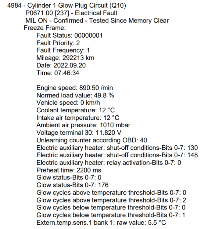

Hi Everyone.
I had this error this morning...4984 - Cylinder 1 Glow Plug Circuit (Q10) P0671 00 [237] - Electrical Fault
I read, somewhere here in the forum, that one of the plugs have a different size... I just looked up Bosch (as I heard they are the factory installed ones) an even the full set has the same sizes... Is this a wrong info, if not any, OEN part number for the "one"?
thanks in advance.
7 hours ago, QubiDK said:
Hi Everyone.
thanks in advance.
3 are the same, the 4th has a pressure sensor and is a hell of a lot more expensive.
I do believe cylinder 1 is a standard glow plug though. Cylinder 3 has the pressure sensor.
EDIT: If you can supply a vin/engine code i can tell you exactly what ones you require. Also OE fitting is Borgwarner, Hidria, NGK or Bosch
