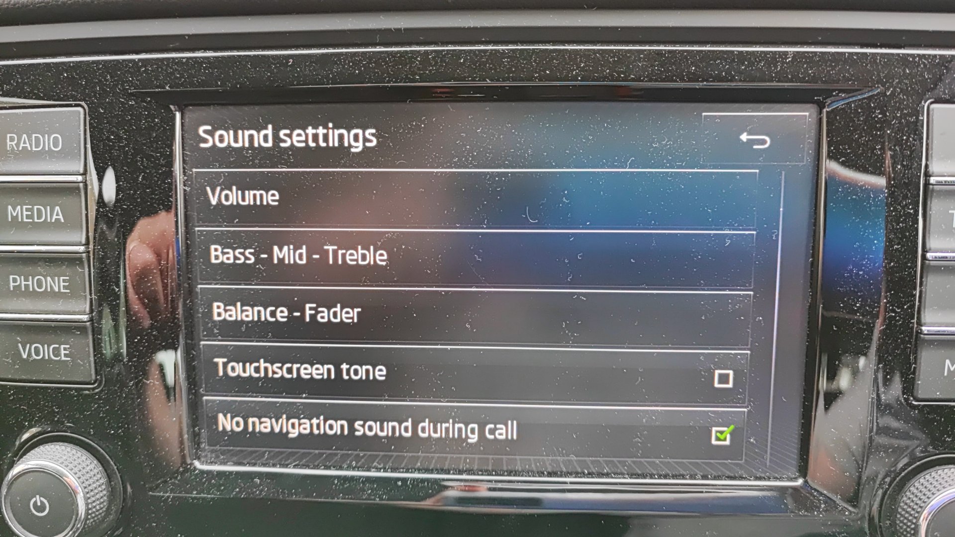

Check someone hasn't messed with the stereo fader control and it's possible the CD changer/AUX input share the same connector which is perhaps loose.

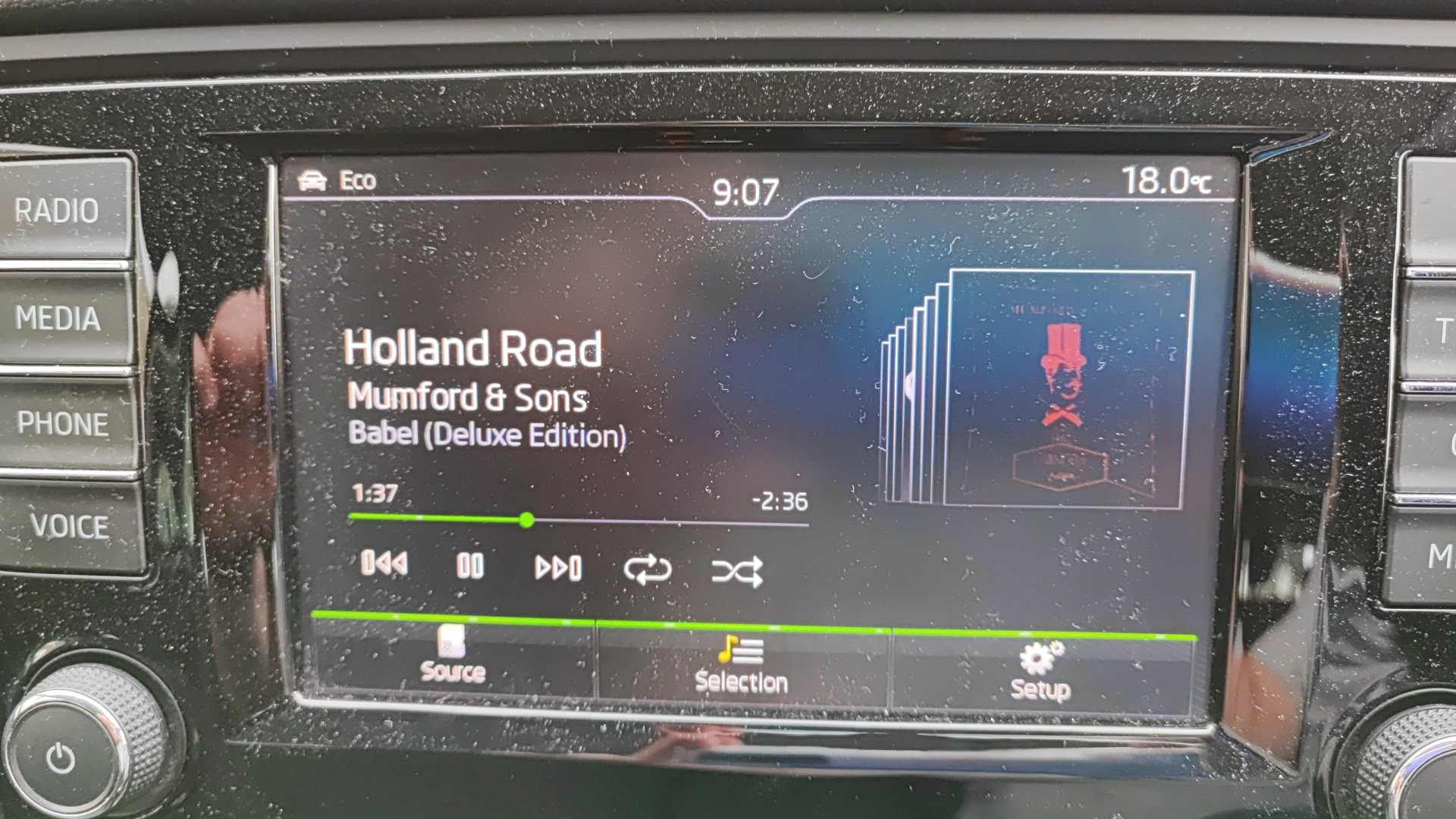

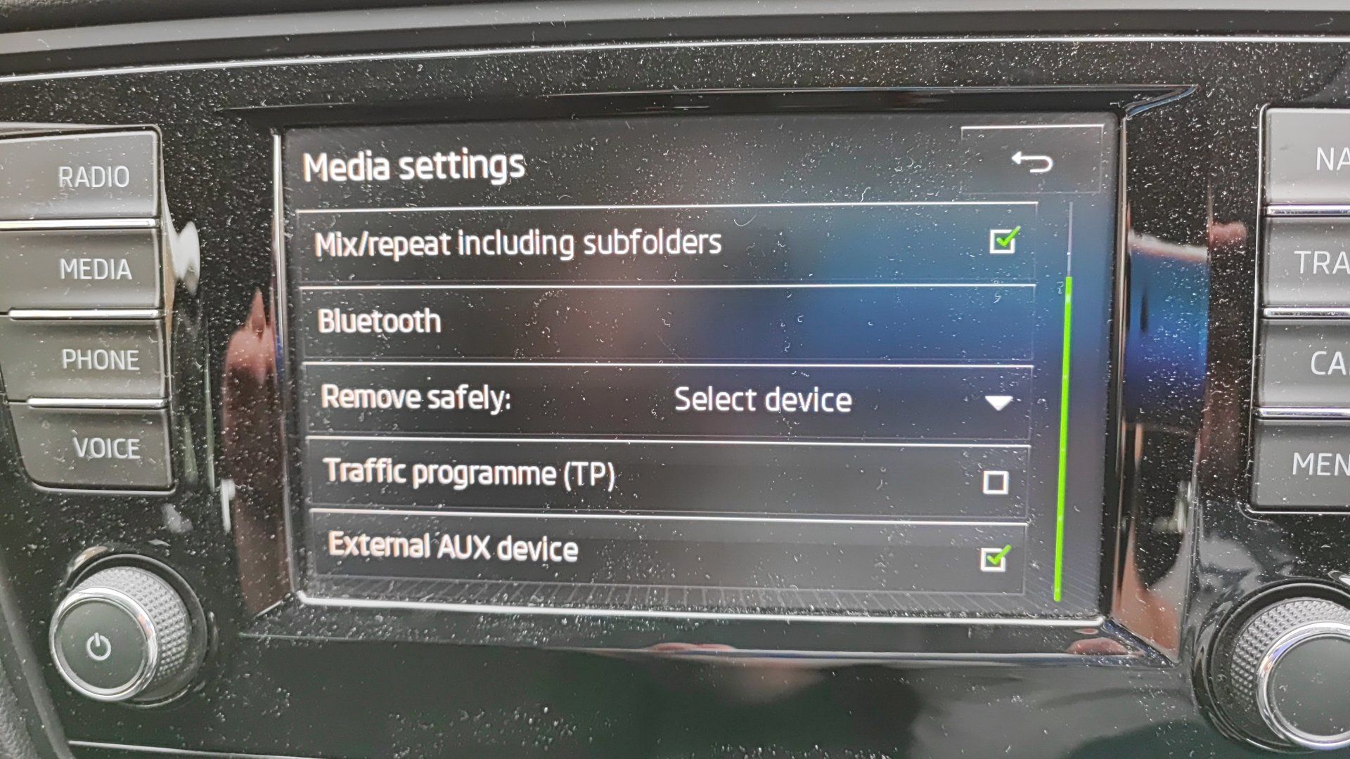

I would need to check in the car, but I think there's option on menu to disable Aux input's.
Pressing setup
Gives you access to tick/until external Aux

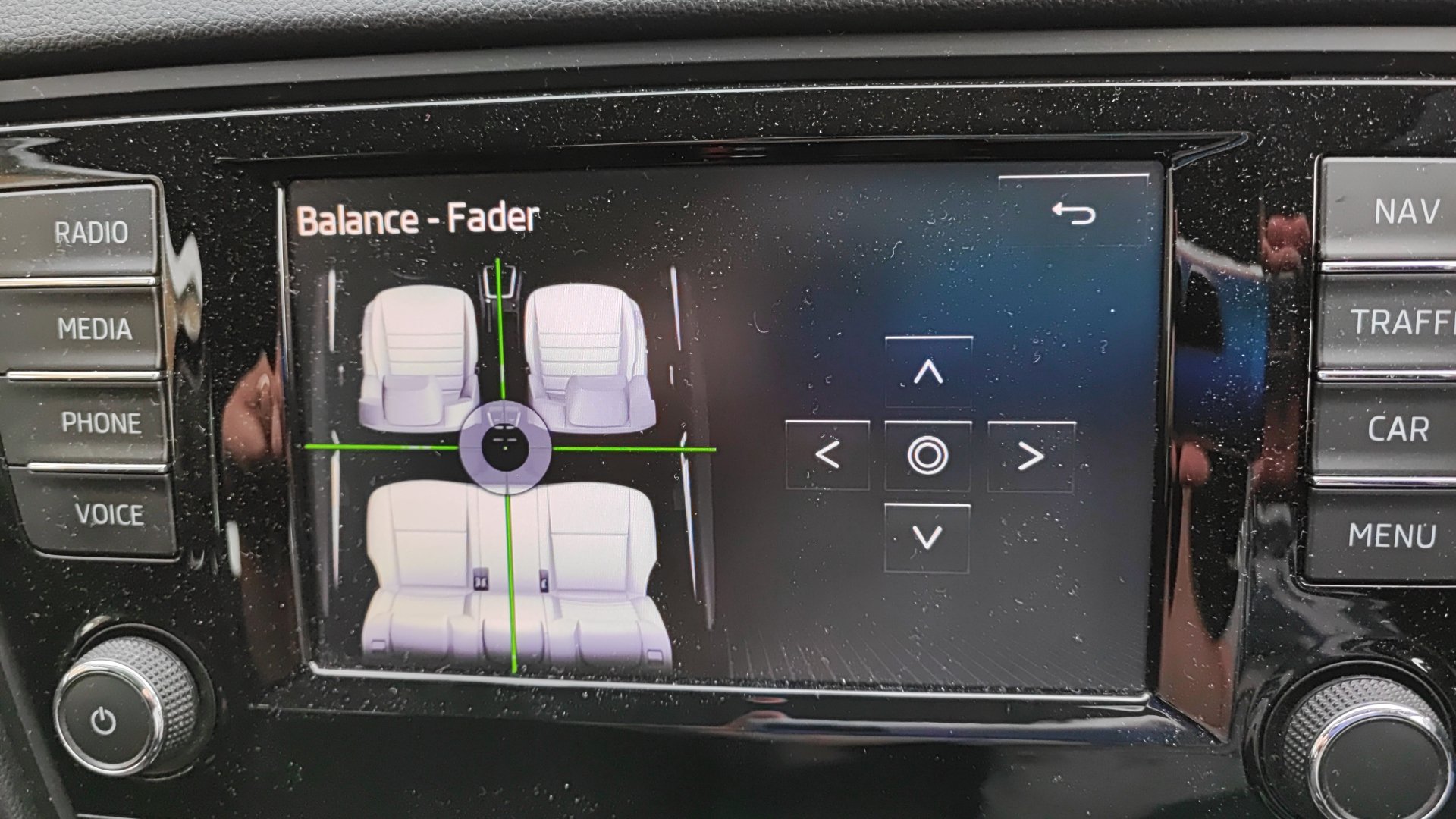

This is the balance-fader to check
Drag circle to desired location
