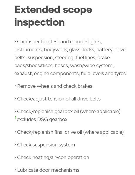

Long story short, my '67 Plate Superb is booked in for its cam belt & water pump With Bristol Street Skoda, Derby to the tune of £600. It's 5 years old so understand it needs to be done. Last year in September I opted for a Major Service with them, at around 47,000 miles. The DSG  gearbox oil was done in March '21, also with them.
They're now quoting me £245 for a service (extended scope) as well as £65 for a brake fluid change, however with the car only having only done 6.5k miles since the last service, surely it only needs an interim service?
Surely I could just take it to an independent and have an interim service and brake fluid change done for a fraction of the cost?

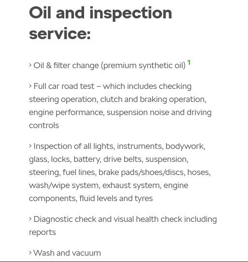

Its hard to say what would of been done in a major service as its more of a marketing gimmic now.
You only get a oil service and an inspection service. Everything else has recommended intervals varying from 10k/12 months to 80k/8 years.
What was actually done during this major service and just make sure they arent redoing it basically.
If you want an Oil & Filter service annually or between Variable / Flexible services then get that.
If you want to change a Pollen filter yourself for under £20 then do that.
If you want the Brake Fluid tested for H20 then get that and do not change it @ 3 year then each 2.
If you want Servicing & Maintenance and brakes serviced then maybe find a good Independent.
According to the itemised receipt, they completed an oil change, replaced fuel, air and pollen filters, and completed a load of visual checks.
This year have it set to variable / flexible servicing so 18,000-20,000 miles / 24 months then you get it serviced annually or when ever you want.
They are putting it on fixed so 365-372 days / 9,4000 miles.  No need to have it set at that, it gets Long Life oil at the service.
If thats the case then a brake fluid change may be due. The £245 service you have been quoted is simply an oil and filter as well as lots of 'expensive' visual checks which generally are the same checks they do on all the services.
The Manufacturers Recommendation / Guidelines is the Brake Fluid changed at 3 years and then each 2 years so the 2nd Brake Fluid change is due.
Maybe the first was not done.  An Independent might well use a Brake Fluid Tester and see if there is H20 and the Fluid needs changing.
Good idea to have it done, but then a good idea to have the brakes serviced pre or post winter as well.
Independents might do that, Main Dealers do not unless paid, they say with Extended Scope the wheels come off.   Maybe some do take them off, but then what do they do, LOOK.

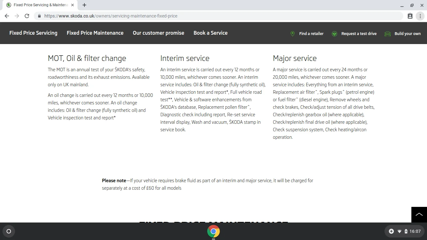

3 hours ago, Hdsn555 said:
08/09. service indicator saying 27 days for service I believe.
Well, you are in scope for a fixed interval service then because of the duration rule.
I think an independent specialist will do the cambelt and water pump for more like £400 than the quote you have from a main stealer.
