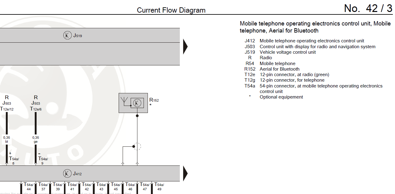

I could be wrong, as it's not clear which radio this is for on the car...
But the Radio in this wiring diagram has to talk to J412 a mobile telephone control unit, and then there appears to be a bluetooth aerial that is also fitted.
As I say, unsure that you need these, but it could be your missing puzzle piece.
J412 = 5J0 035 729 B
A how to guide, not Skoda... but to give you the overall picture of what might be involved.
https://www.mk5golfgti.co.uk/forum/index.php?topic=44094.0
Edited by varooom
no such thing needed with this unit, its all built in............your looking at the bluetooth module which is a seperate unit which is normally under the seat for bluetooth prep on the lower spec radios.
