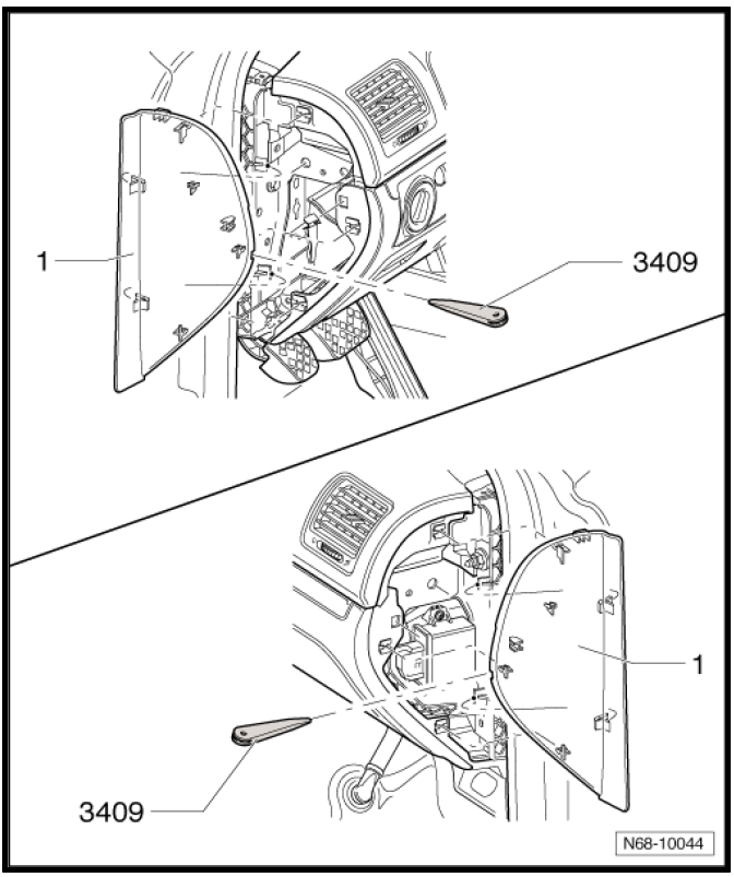

My 2021 Mk3 Fabia seems to have a switch gone inside the trim on the right hand side of the steering wheel.
I am not sure what it does but it's a lease so i need to get this back in or they will probably charge me when i take it back next year :)
Does this trim come off so i can get access as the switch is right by it . Thanks.

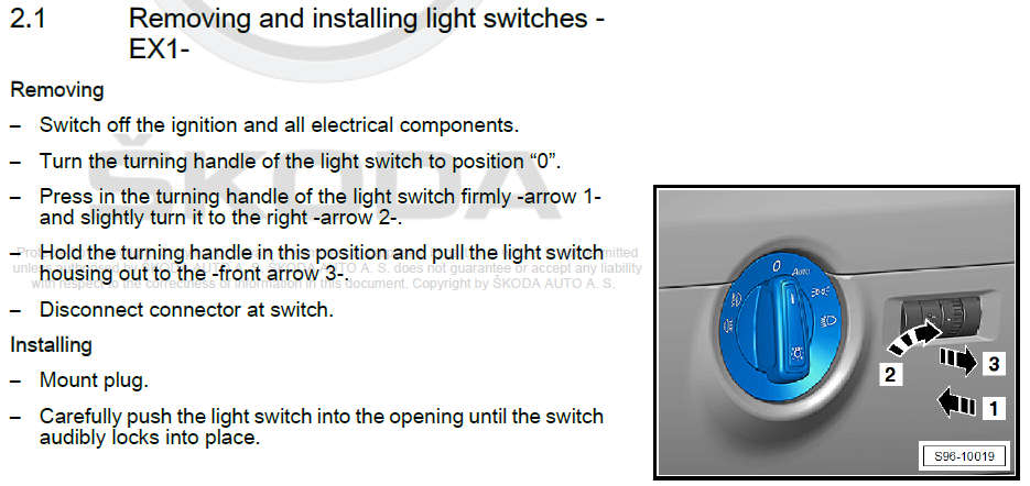

That's a nice easy trim to remove, it does have a fair few clips that hold it down fairly well.
In answer to your next possible question if it's your light switch?
Thats great thank you. I have trim removal tools so i will give that a go.

Thanks again. It popped off so easy. Managed to push the light switch in fully and run an iPhone cable too.
