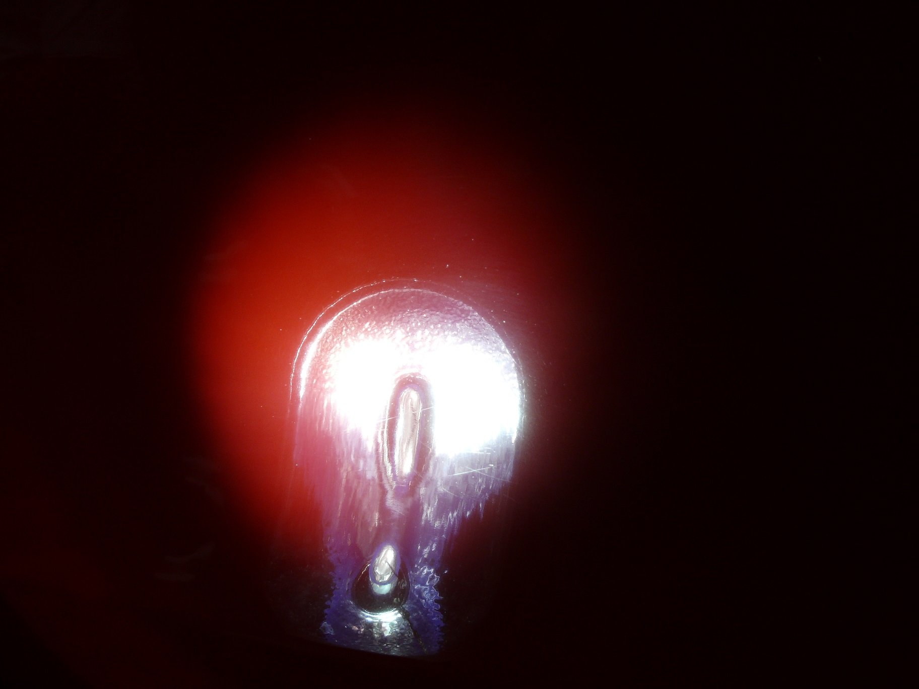

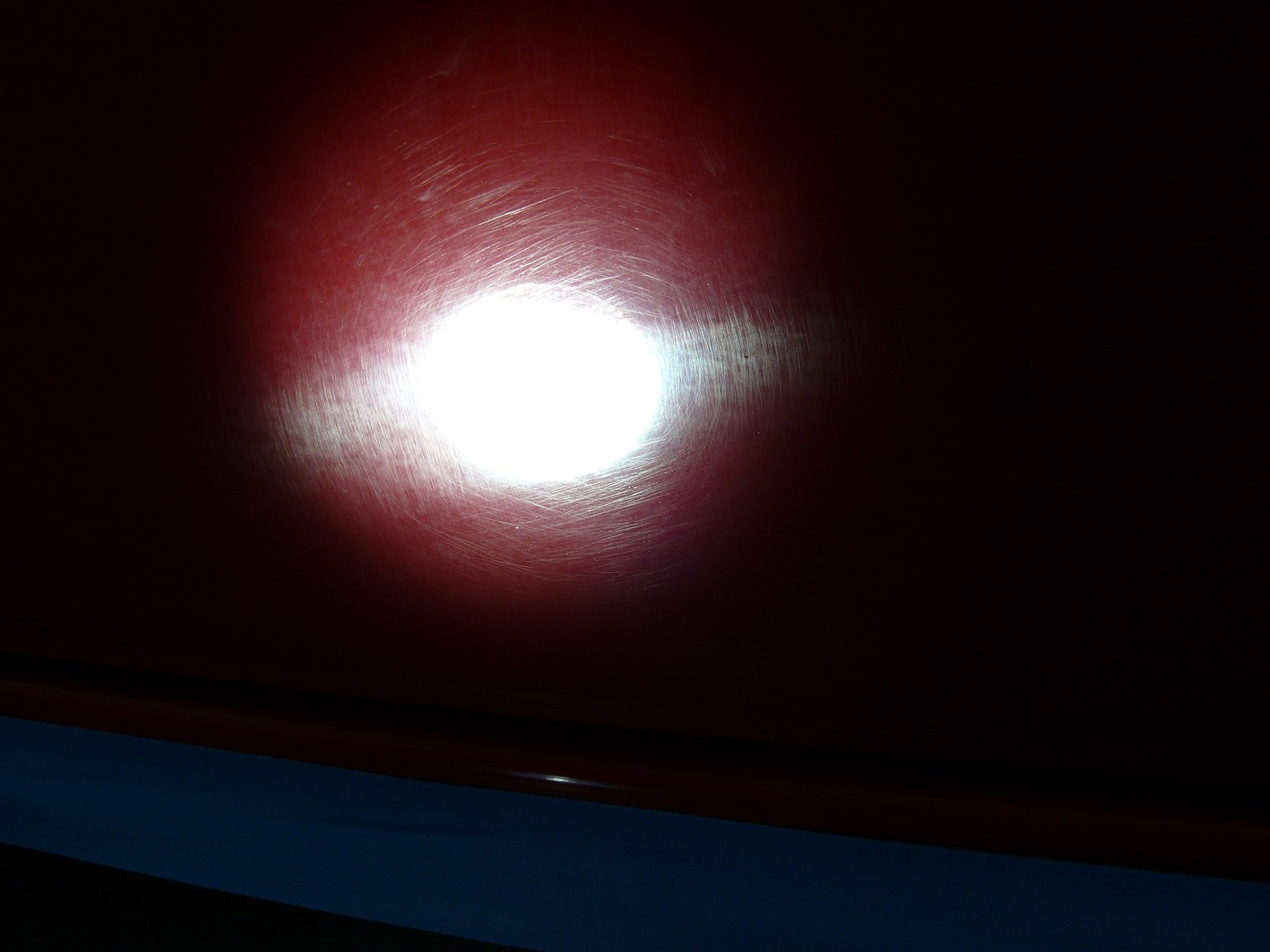

Here is a red (paint that fades to pink!) corsa I helped polish for a friend
Before you can see a load of wonderful scratches from years of bad washing
Now after machine polishing it's 95%+ improved at least

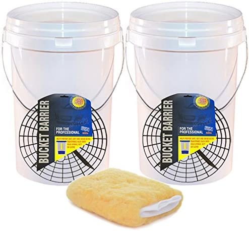

For in the middle, there are many products of course.
For beginner "kit" I would recommend 2x buckets, with grit guards and at least 1 soft cleaning mitt
The basics of the two bucket method is one bucket with your shampoo wash solution, and one bucket with plain water for rinsing your wash mitt
Then a bundle of microfibre towels to dry off the car, and some smaller ones for general use

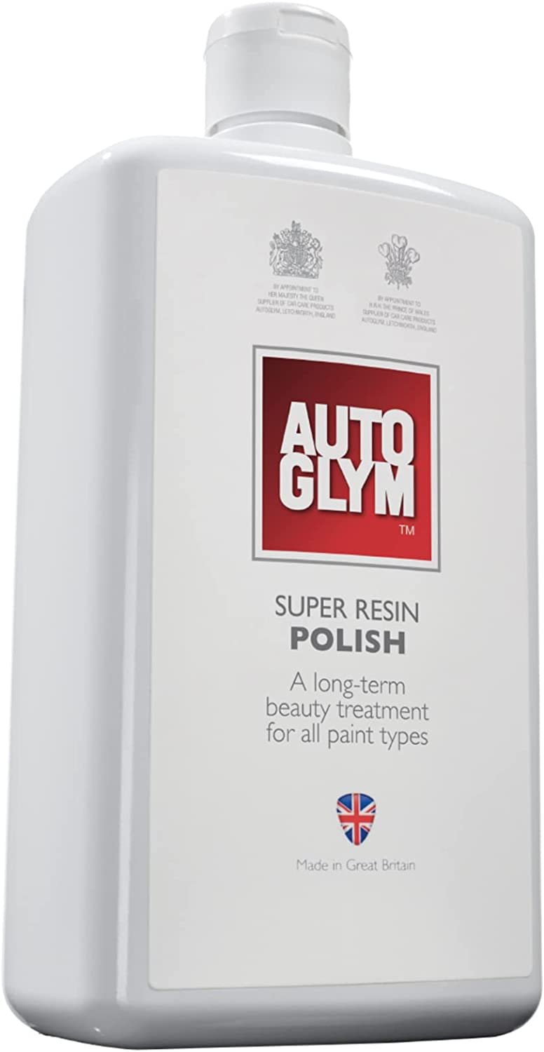

Once washed and dried, you can apply some Autoglym Super Resin Polish (you may wish to get a small applicator)
Less is more, don't use too much.
This contains fillers that can cover up the lesser scratches.
Use the microfibre cloths to remove.
After a few hours, I would say you should be good to use some wax on the car, don't wipe too hard as to remove some filler, and you should be good to maintain with 2BM washing.
Re-apply SRP/Wax as needed, ideally before Winter, and again early Spring at the least.

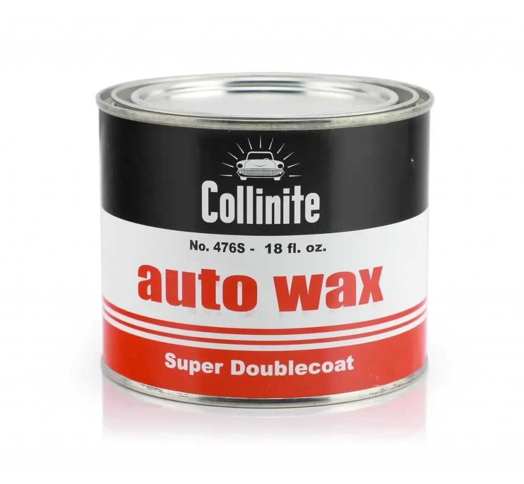

1,000's of choices for waxes.
I have used this, and still have a pot!
Rather an old school wax, has a fair longevity, I think they claim 12 months, take with pinch of salt, but it does do well.

As @varooomsuggested, the Autoglym Super Resin polish is great stuff if your paintwork needs a little tlc to remove light swirl marks.
