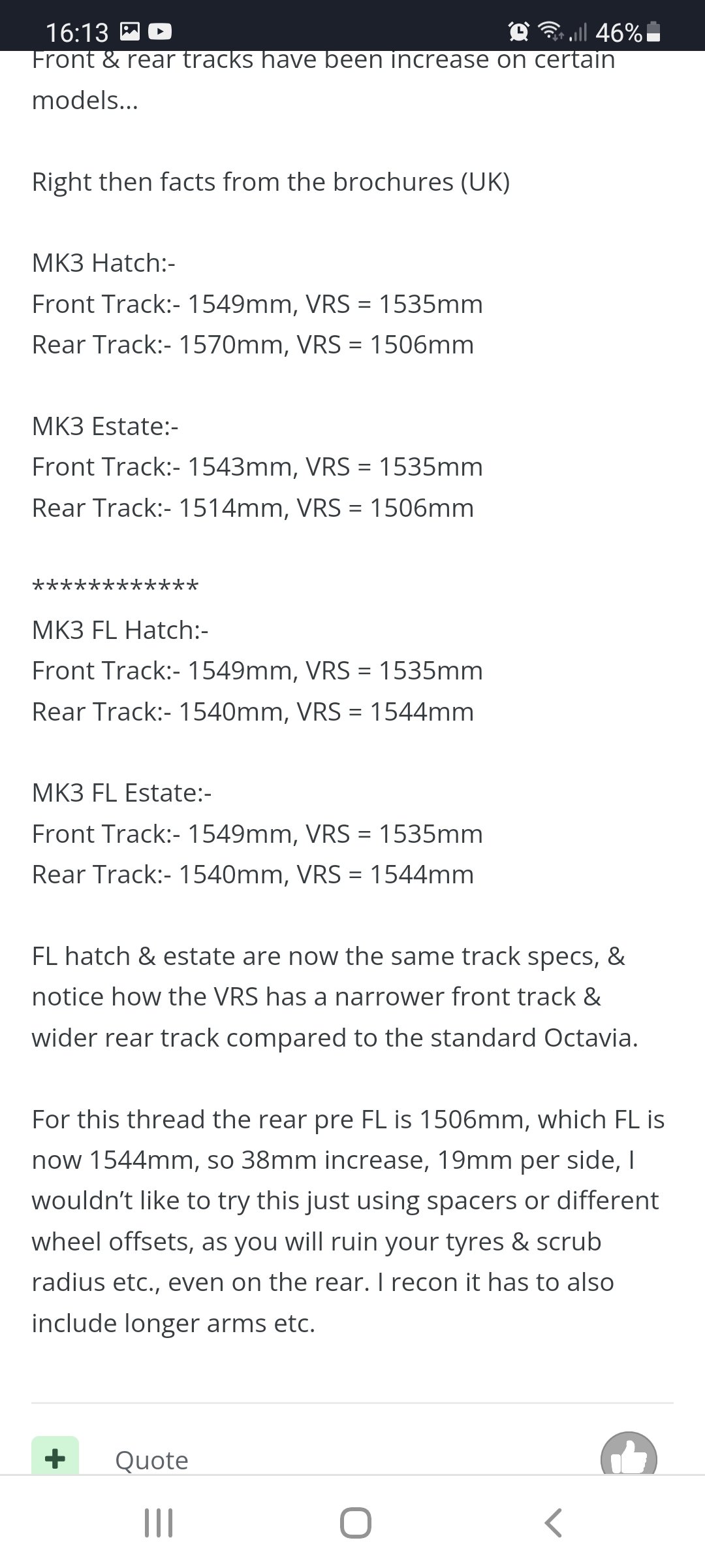

I have this which I found on here a while ago when I was doing some wheel calculations for my 245.
