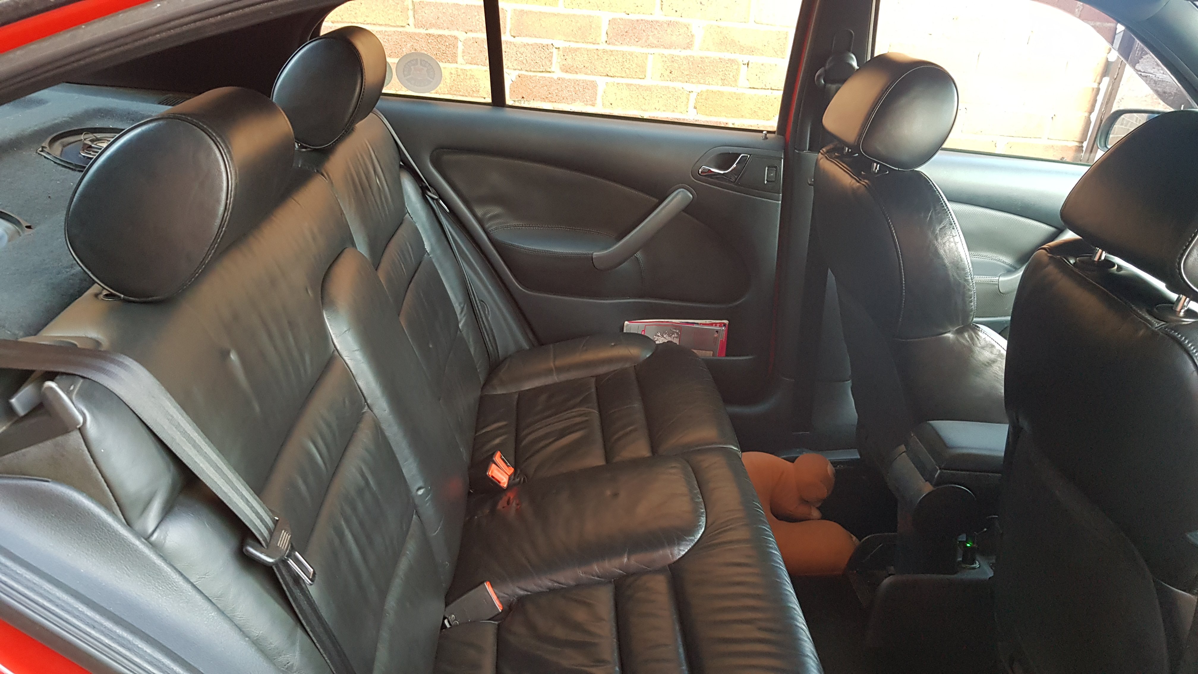

Octavia L&K in black, and you'll get black leather door cards from it too.

As above, the best would be the L&K interior. However, the seats are horrid.
If you want decent leather seats, I'd recommend the Recaro Heated Leathers from a MK4 Golf.

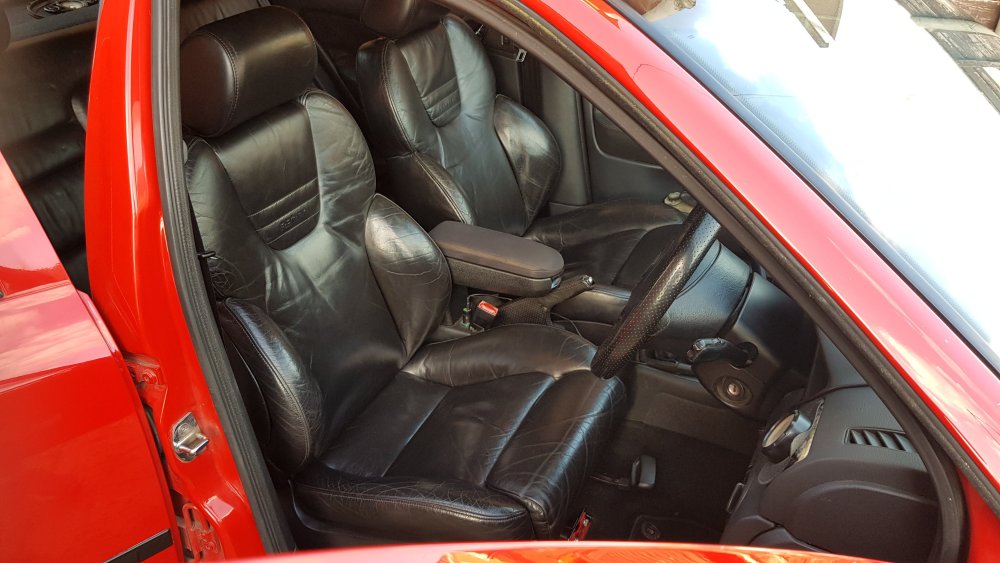

I ripped out the L&K seats and upgraded.

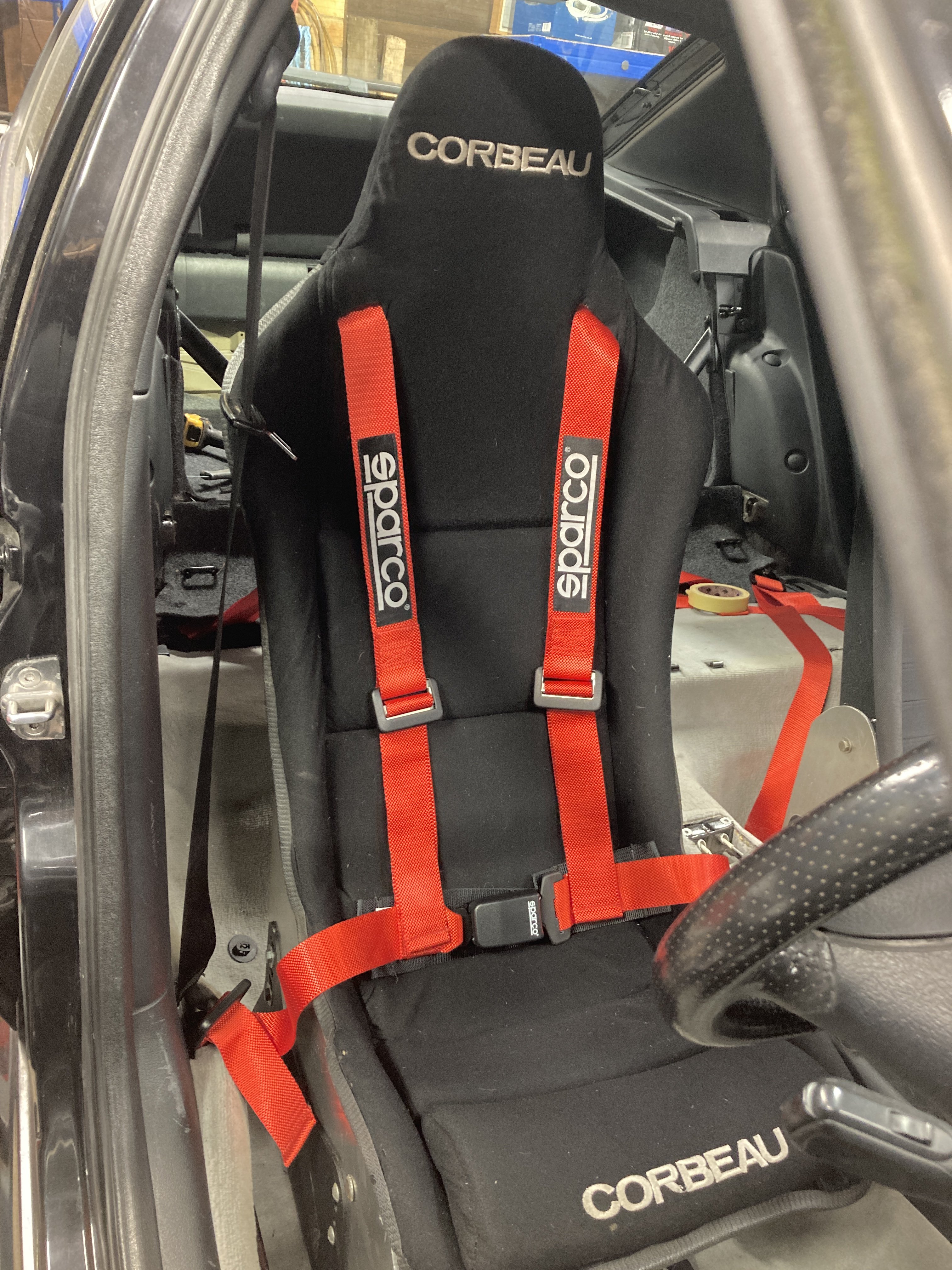

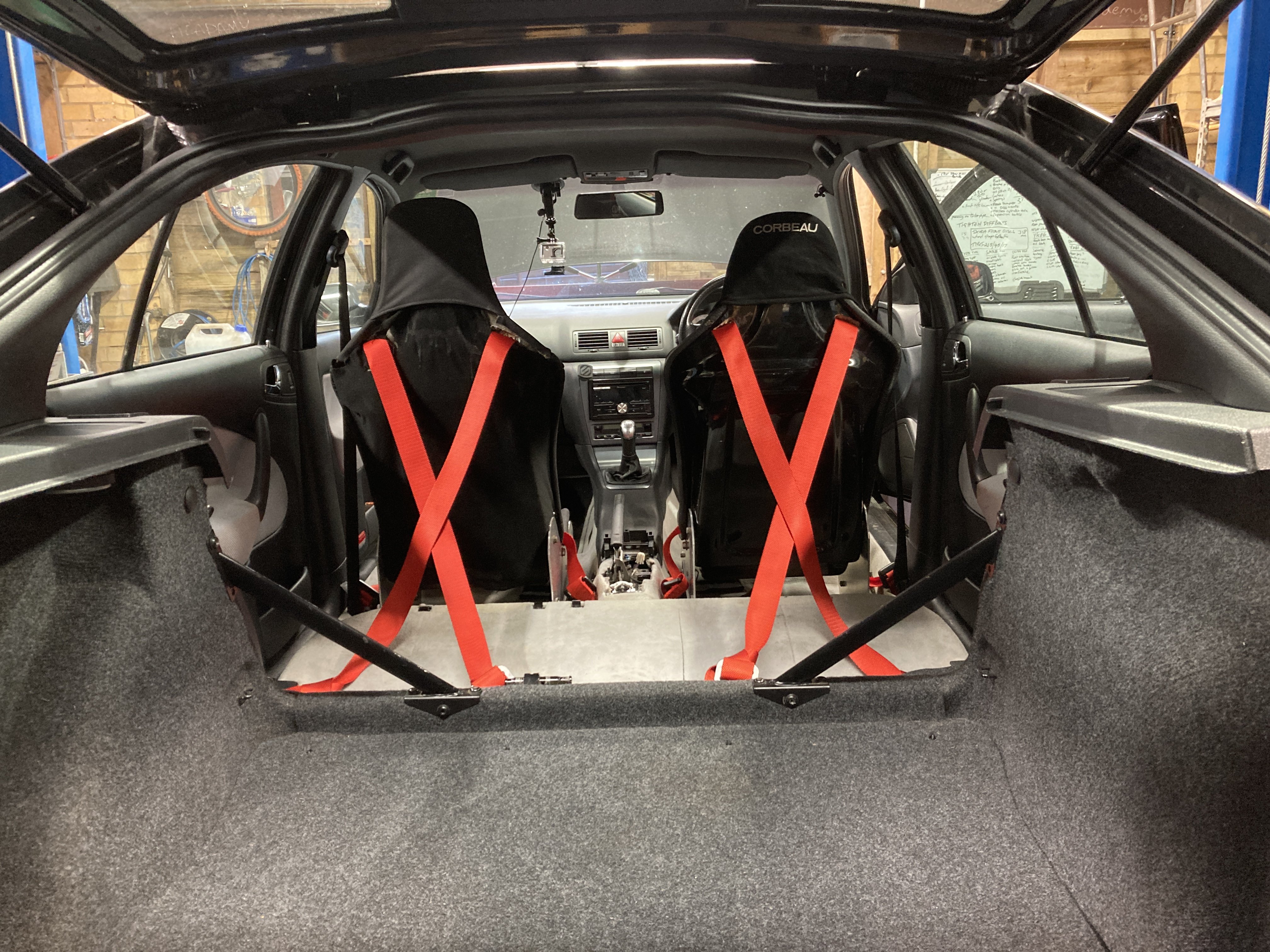

how you got some photos of the Lotus Elise seats?
Hope this works…
On 15/12/2022 at 15:34, phazed said:
Out of interest, the Lotus, Elise seats i now have fitted weigh 3 kg each!
Made me smile as I wondered how they'd look in relation to the rear seats....

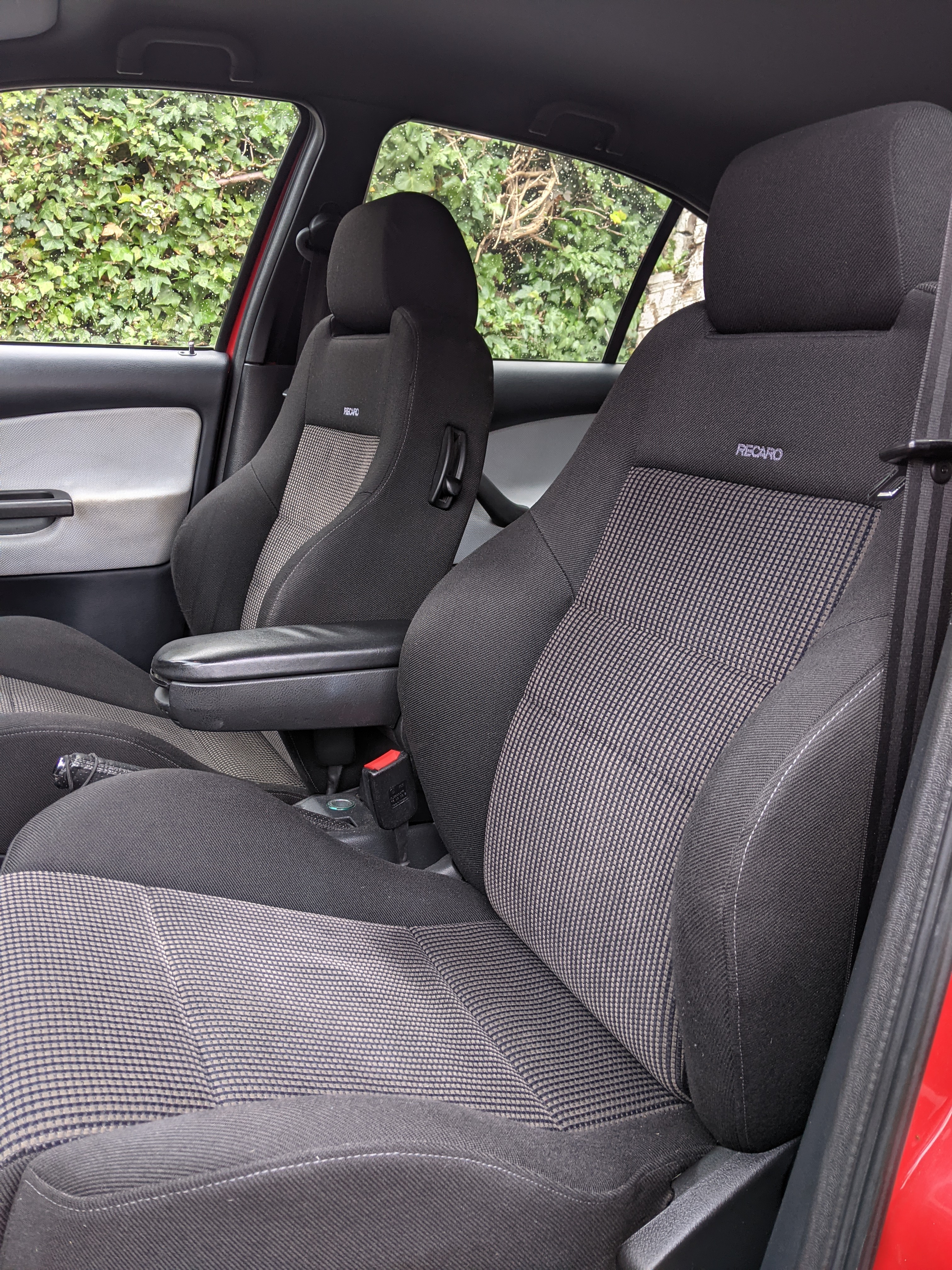

I was going to say that I looked into the leather option but in the end decided on Mk4 cloth Recaros.  They are nice & huggy plus they aren't cold in winter or too hot in summer.  They also have heating elements, I just haven't got round to wiring them in yet.
