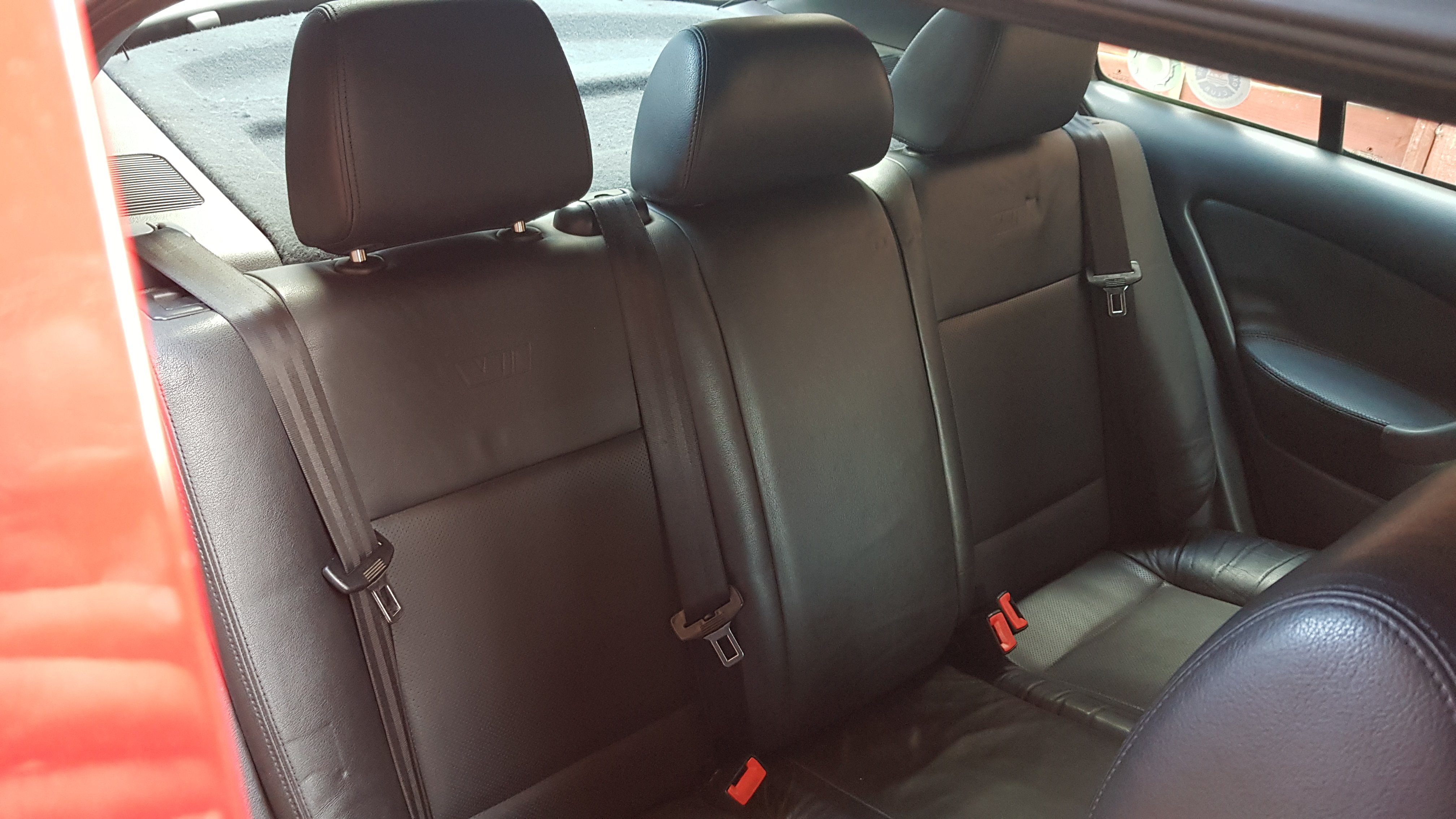

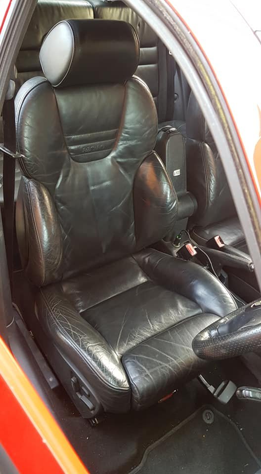

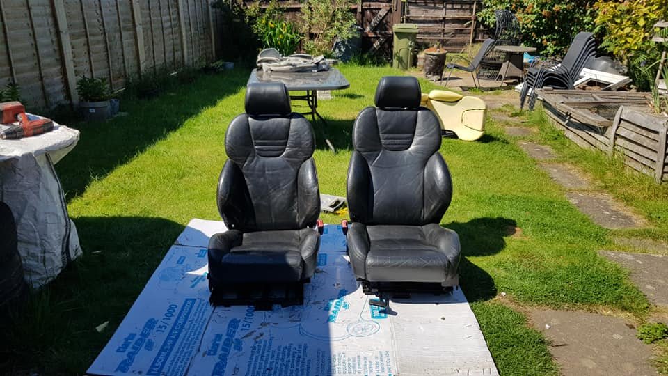

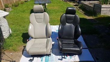

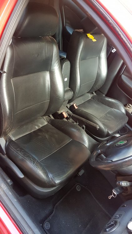

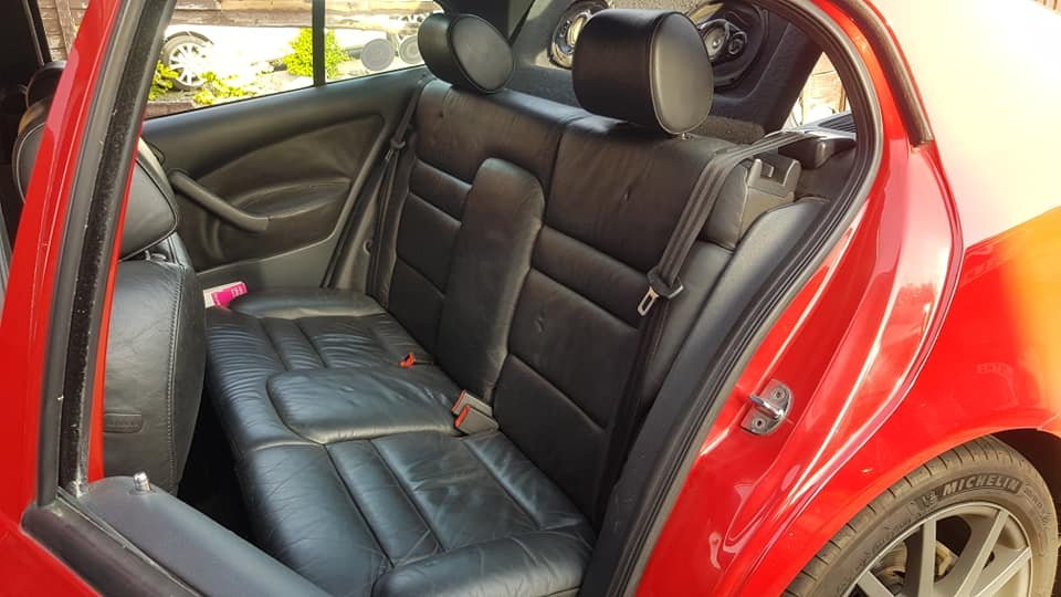

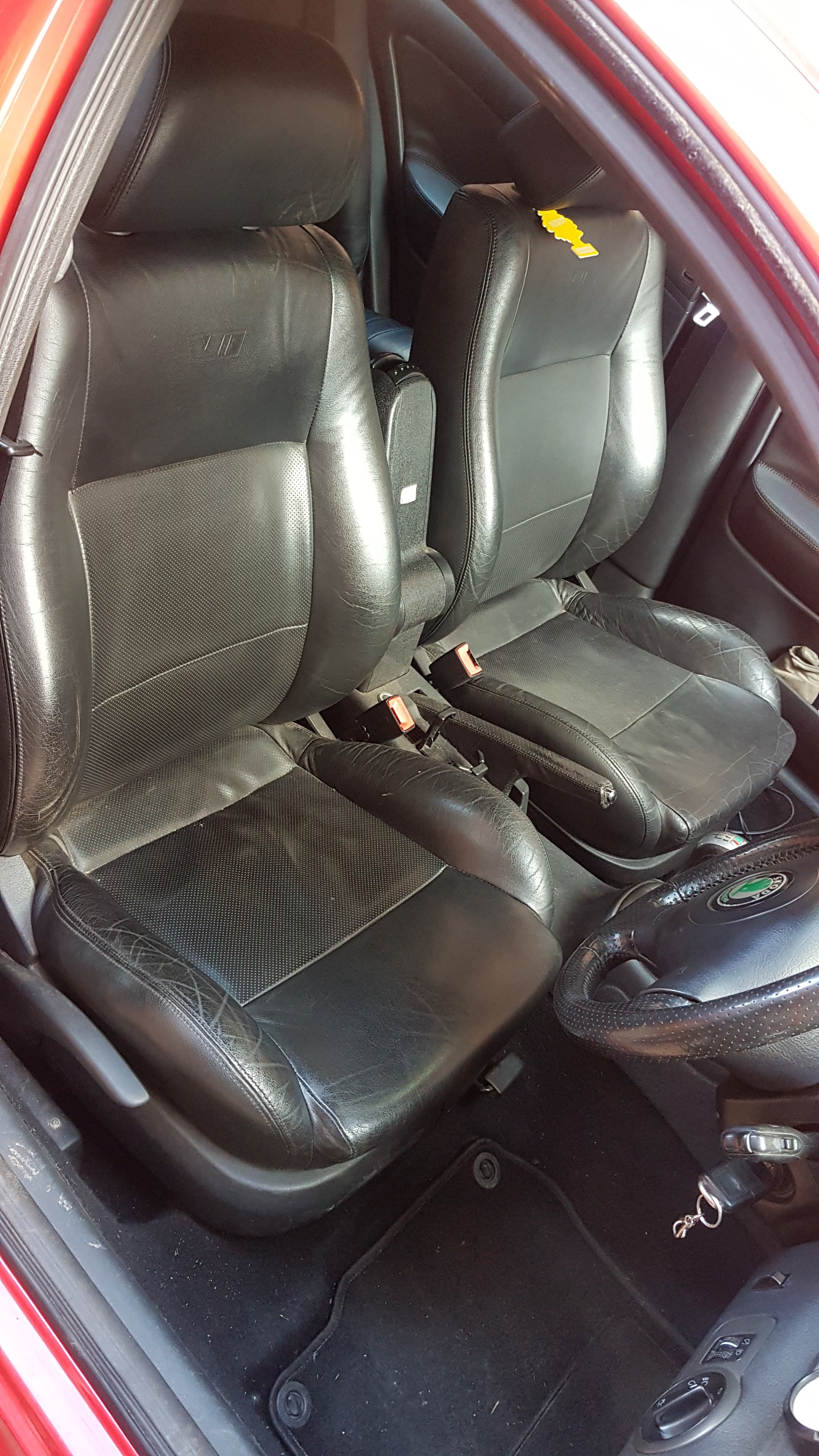

    Been a busy couple of days on the car this week. I've always liked the seats that came with car when I bought it, as they were the standard VRS seats but without the problem of always looking grubby d
Been a busy couple of days on the car this week. I've always liked the seats that came with car when I bought it, as they were the standard VRS seats but without the problem of always looking grubby due to the previous owner having them professionally retrimmed with a nice leatherette infill.
They looked good but recently I've been felling like a change to something a bit more fancy and something with better bolstering to hold me in would be nice. I wanted something that would be a straight bolt in option as I didn't want to entertain fabricating new mountings or anything silly like that, so after a bit of research, I set my heart on Audi S3 8L black leather electric Recaros. I thought if I was going down that route, I may as well get heated ones for the ultimate luxury.
Searching ebay and Facebook Marketplace was showing up that decent heated sets are hard to come. I eventually found a pair of heated fronts miles away in Darlington but they looked decent and I wasn't over busy so made the trip up and got them, (after picking up a set of rears I found more locally earlier in the day.) Got them home and had a proper look at them the next day to find that the base plates were missing so I couldn't mount them in the car. Upon further investigation, they turned out to be non heated versions, which really annoyed me as they were advertised as heated and I'd had a full discussion with the seller about wanting heated seats. The seller is still adamant that they are heated despite the photos I sent him of them opened up clearly showing no heating elements and no wiring for the heating 🤔

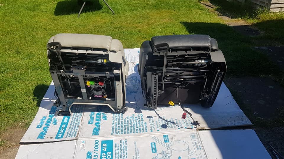

Fortunately, I managed to find an absolutely dirt cheap full set of the same seats, but in the less desireable cream colour. The leather wasn't in great condition but the mechanicals were all good and they were complete with the bases and they were definitely heated so I hatched a plan to reskin them with the black leather from the first set I bought. I was also able to sell the cream coloured rear sets on, to make the fix even cheaper, as they were in decent condition. A guy bought them to make a little sofa type thing for his man cave.

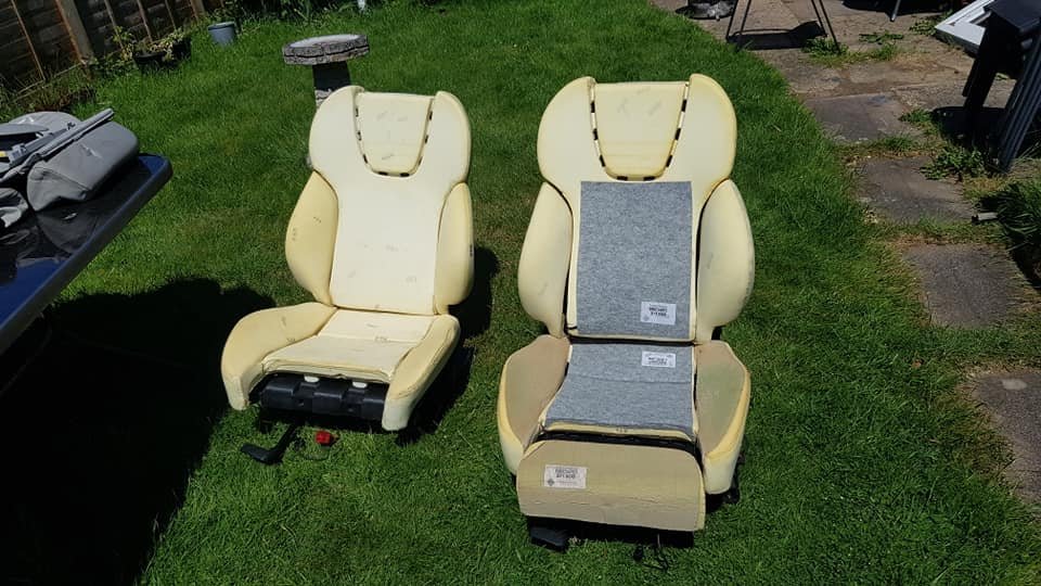

With the cream and black seats side by side, you can tell straight away the wiring differences between heated and non heated.

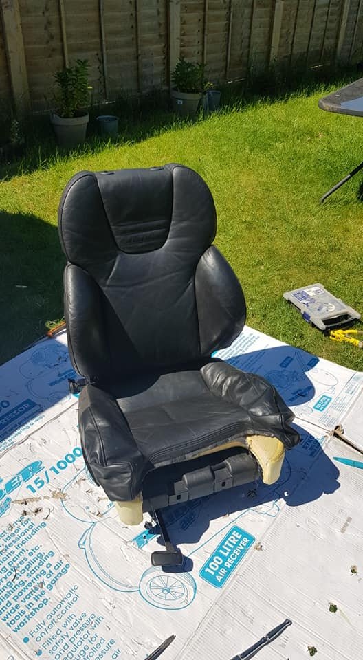

Removing the leather from the seats is essentially easy enough, just fiddly and I wanted to be very careful not to break any clips or rip the leather.
Once the leather was off both seats, it was really clear to see that one is heated and one definitely isn't. But the seller has the switches in the car, so they must be heated 🤨
Anyway, putting the black leather onto the heated seat was a case of working in reverse to the dismantling, taking my time to make sure everthing was clipped and pushed back in where it should be. My hands are now destroyed, cut to ribbons from little sharp clip jobbies, but after 8 hours of work to take 4 seats apart and rebuild 2, I now finally had a pair of electrically operated, definitely heated, black leather S3 Recaros ready to fit in the car.
Really pleased with how they turned out, all the leather went back nice and tight where it should be.

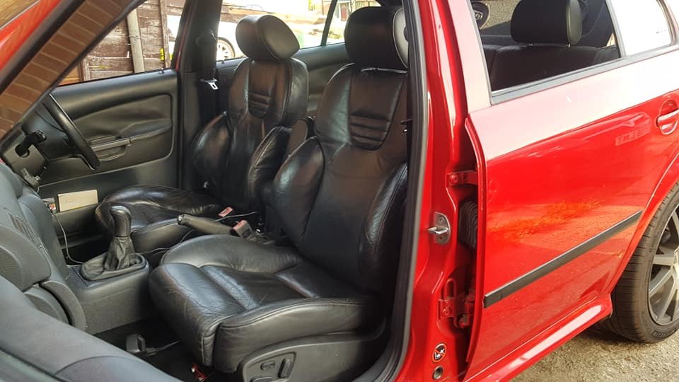

Before they could go in the car, I needed to install some wiring for them to work. The electric operation is simple, literally just needs a live and an earth so I made up a little loom with a parallel fused wire from the switched live on the relay board under the dash. Each seat then has it's own earth running to convinient bolts on the floor with all wiring tucked under the carpet out of sight. I would show you pictures, but I purely forgot to take any as I was too deep in the zone.
So, with power in place, time to bolt the seats in. Pulled a muscle I didn't realise I had when maneuvering them into position because they are a bit on the heavy side, about 37kg each I've heard. Once bolted and plugged in, it really made the effort worthwhile, they look awesome, they work and they are so comfortable.
Rears were really easy, literally just slot them in. Just waiting on a lap belt to arrive for the middle as they don't have middle over the shoulder belt like the Octavia seats. Annoyingly, one of the first sets of S3 seats I was looking at had the rare middle belt and tripple head rest option, but the front seats weren't great and the rears were missing their head rests. Finding 3 of the correct head rests on their own would be nigh on impossible and having mis-matched stuff would really bug me.
So all that remains is to wire up the heating. I've ordered a Kufatec MK4 loom which should arrive in the next couple of days hopefully. I'm going to use switches from a Golf which I'm going to mount in a panel that I shall fix into the cubby hole under the radio. In order to use Octavia heated seat switches I'd need to get a specific Octavia loom and they're very hard to come by and expensive when you do whereas the aftermarket loom and Golf switches option will give a much easier and cheaper totally plug and play solution.

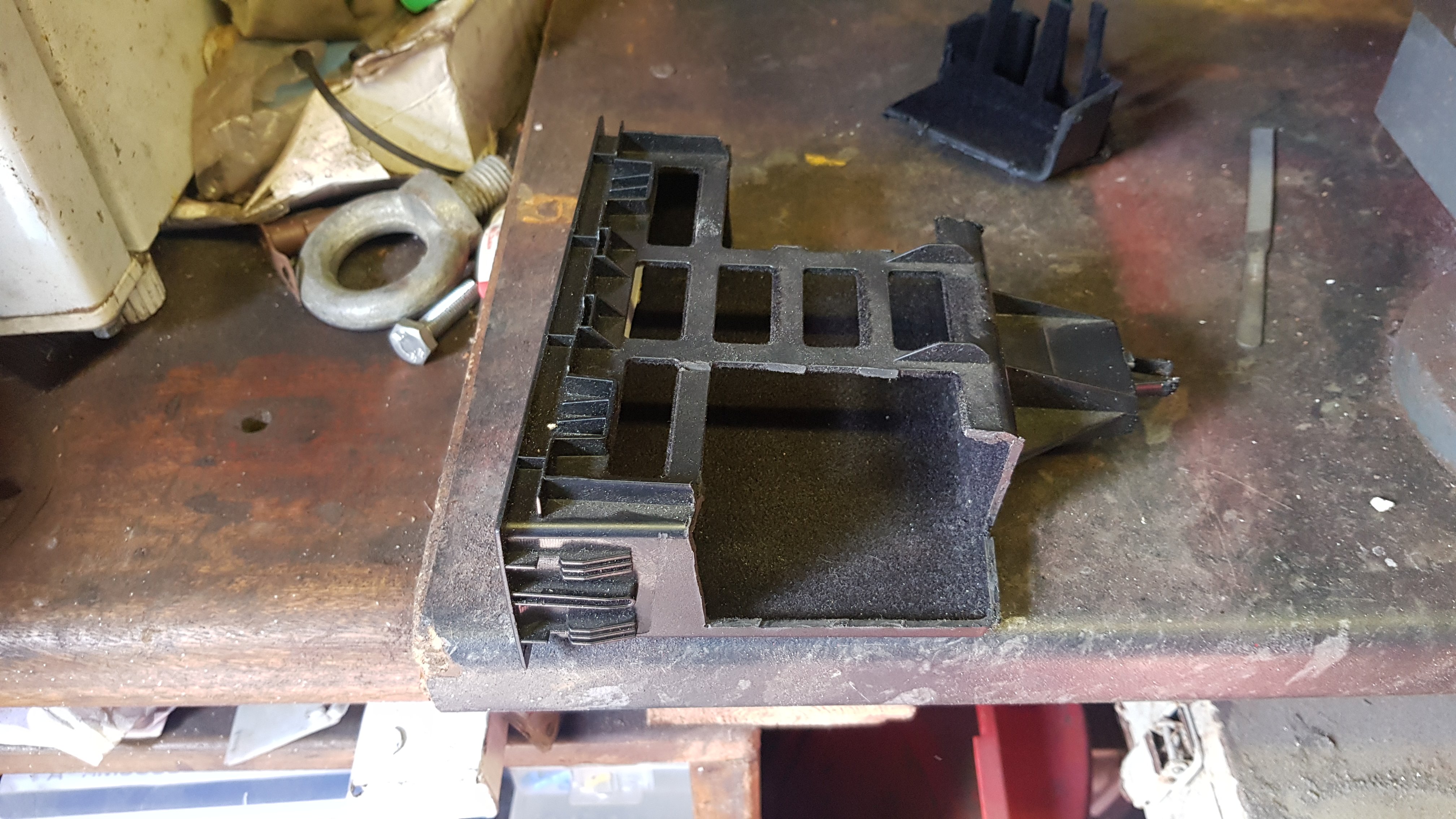

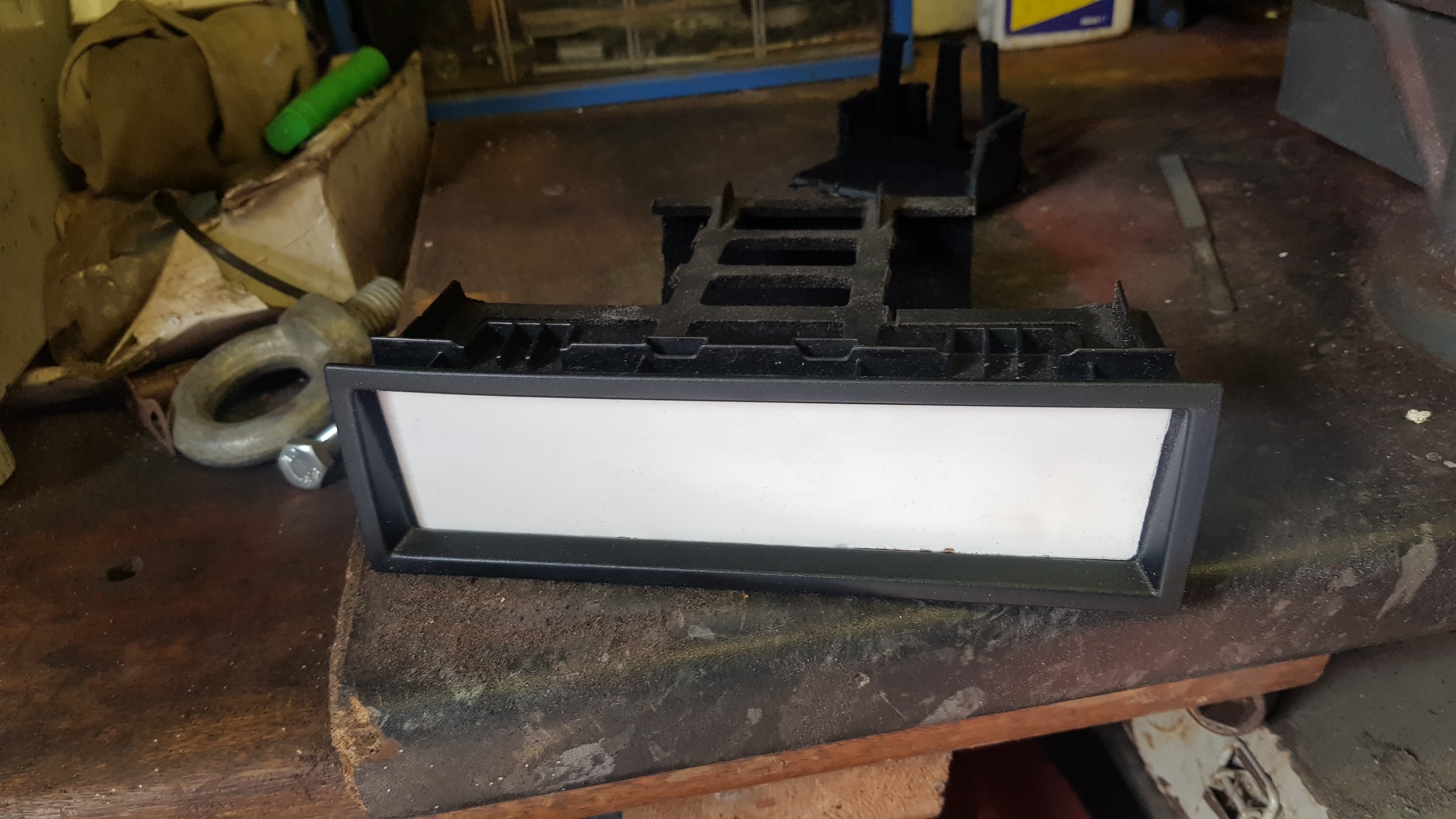

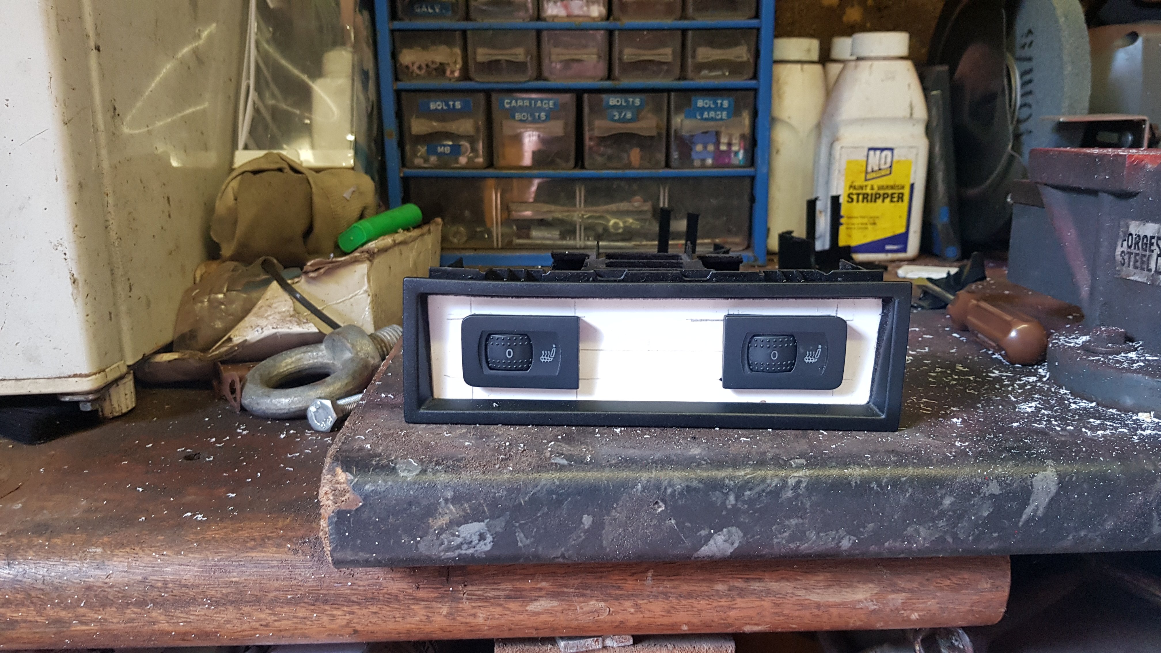

Still waiting for my seat heating loom but I'm able to do a bit of prep work for when it does arrive. I've got the mounting ready for the switches.
I've modified the under radio cubby hole by chopping a bit out the back to allow access for the wiring plugs and cut a panel which slots neatly inside it with the switches mounted through. I've ordered some silver carbon fibre type wrap so when that arrives, I can apply it to the panel and it should hopefully blend in reasonably well with the trim which surrounds the rest of the console.

Could you not use an octavia heating switch and have it in the dash next to the fuel flap?
To use the Octavia switch I need an Octavia loom and they're hard to come by and expensive when you do. It's a lot cheaper to use the Kufatec loom for the MK4 Golf. I've also used the spare slot already to mount my Parrot hands free kit and don't want to have to move that. I've always found the cubby hole useless as stuff tends to fly out so it can have a better purpose this way.

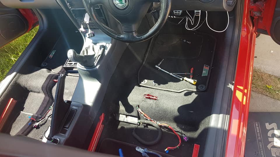

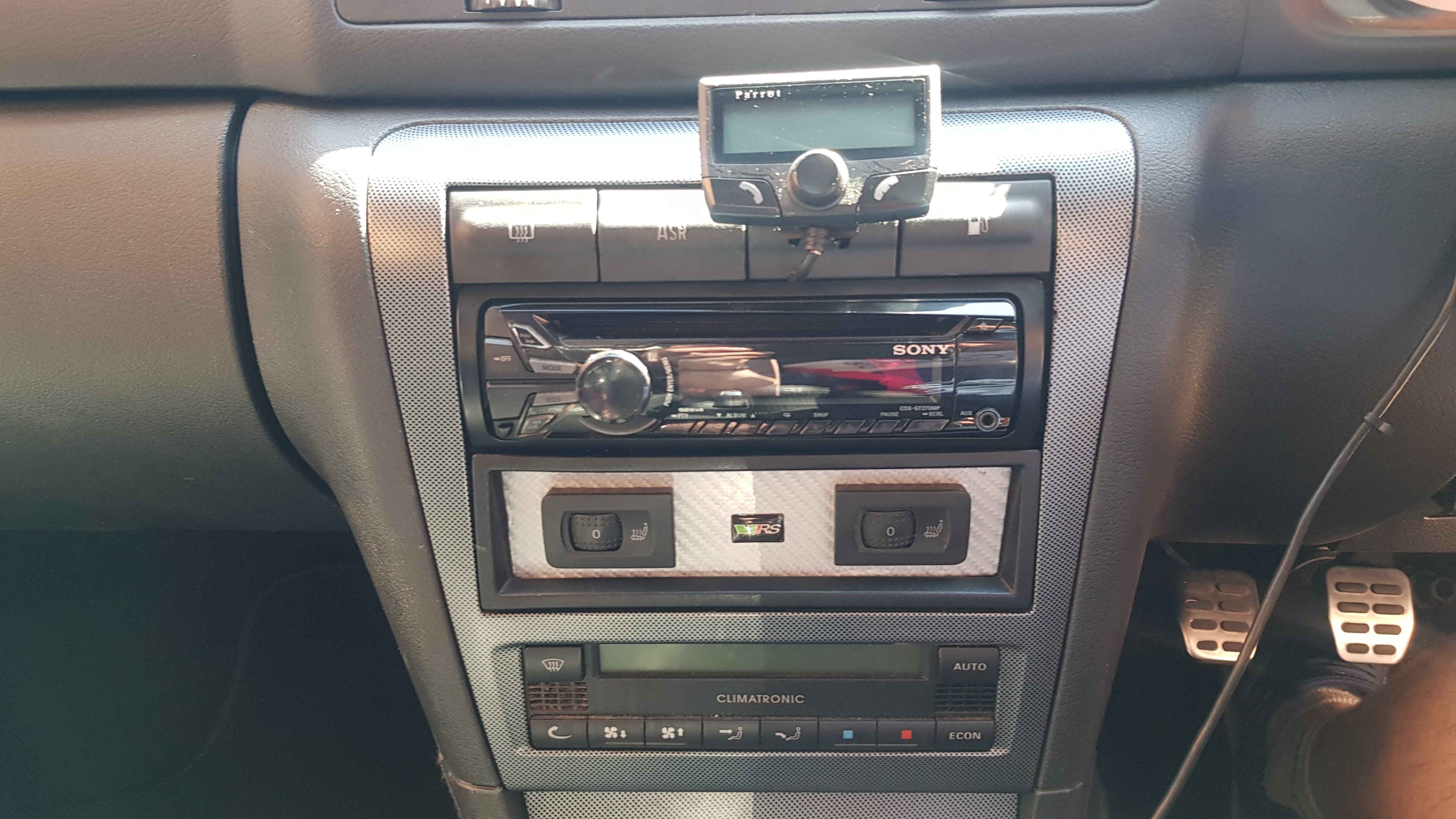

Well, my heated seat loom finally turned up earlier this week. Initially it was delivered to the wrong house but luckily the lady who had it was kind enough to drop it round.
So front seats back out, all the wires fed under the carpet and dashboard and connected up.
Everything tidied up and a little VRS sticker for a finishing touch on my switch panel.
So all done and working. Just need to wait for winter to reap the benefits :D

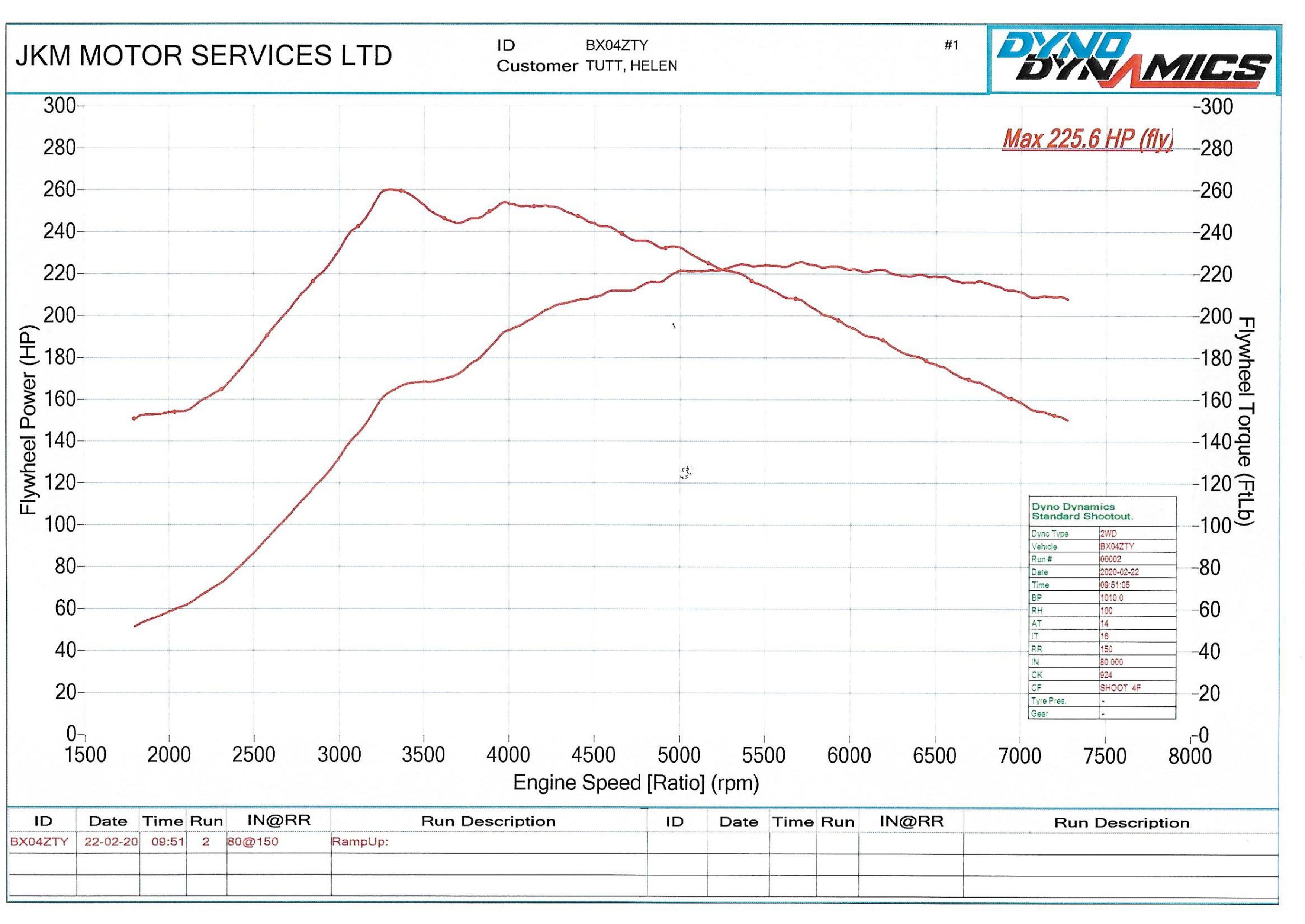

Latest dyno sheet from JKM's dyno in February

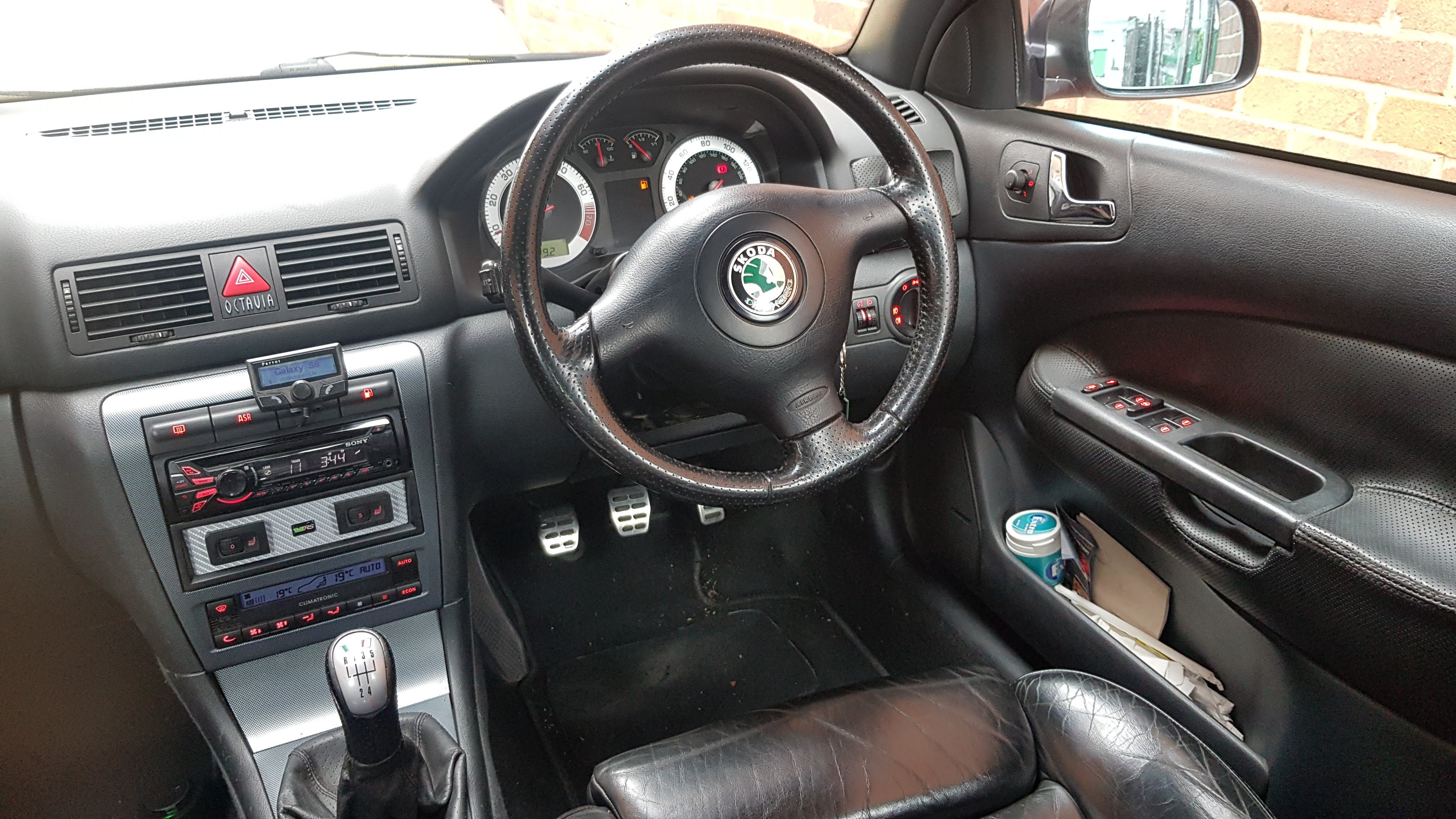

Couple of nice subtle upgrades this week.
A friend of mine comissioned me to break his car for him and I found a couple of things that I thought would be ideal to enhance mine.
First thing was a set of red illuminated switch gear. Looks so much better than the standard green illumination that's hard to see at the best of times.
As you can see, the heated screen, asr and fuel flap switches, light switch, all window switches and the climatronic unit now all light up red. Certainly fits my colour scheme much better. The instrument cluster still lights up green but it is possible to change the LEDs if you're careful with a soldering iron. I've ordered the different coloured bulbs and I've got a spare cluster to have a practice on.

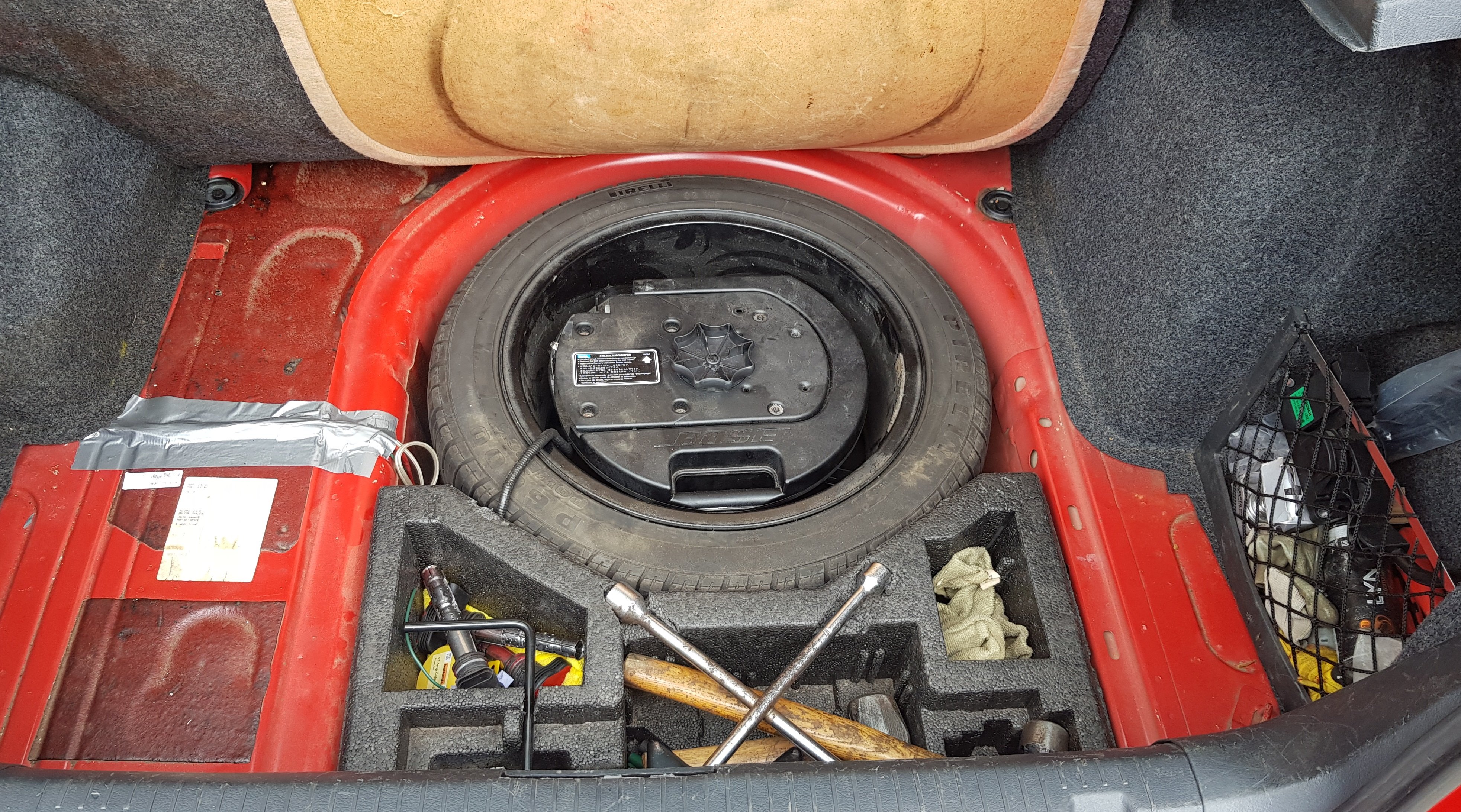

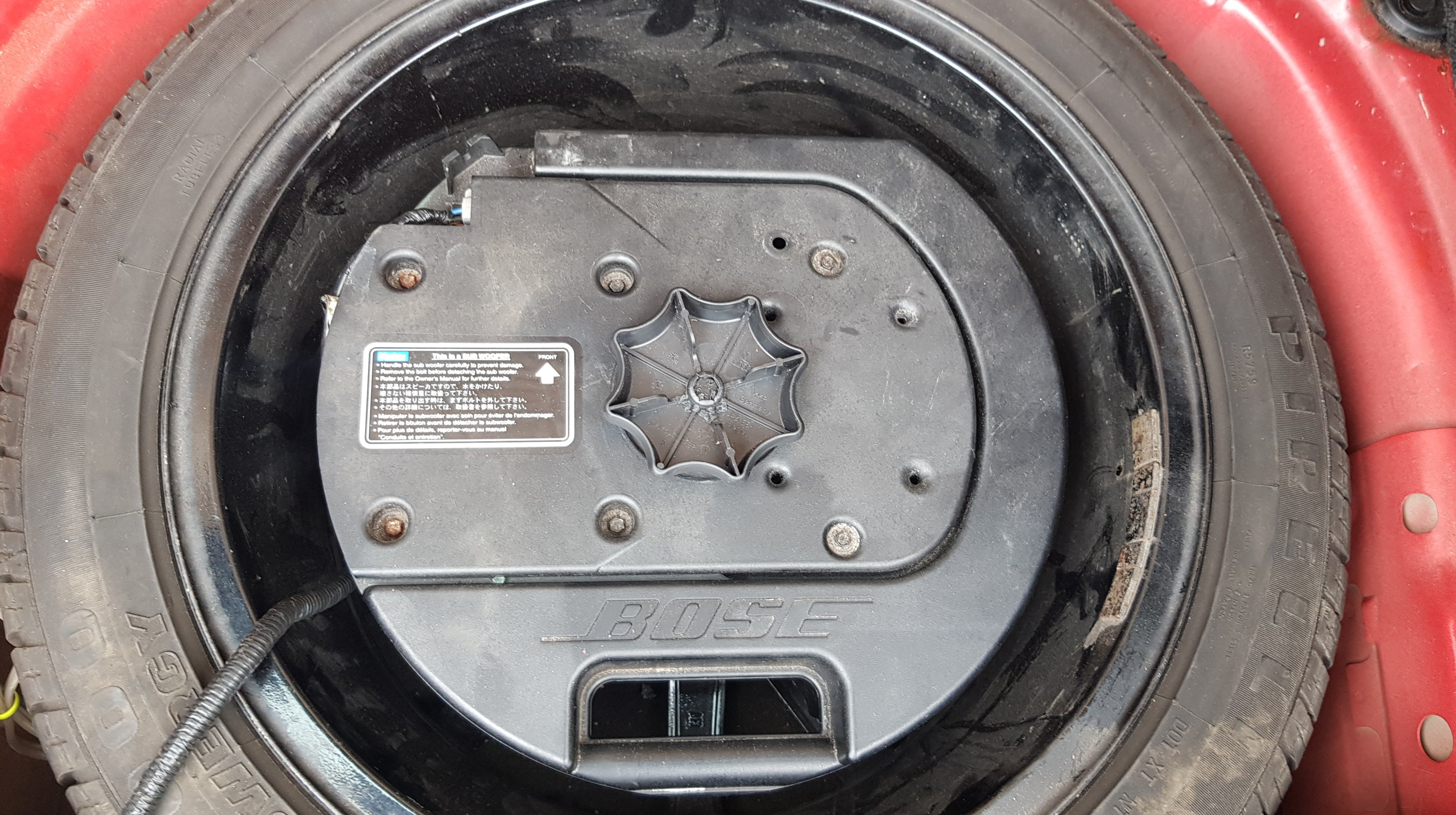

I've also recently been considering options for fitting a subwoofer, I've got 6x9s on the rear shelf but at the age of 36 I'm long past the days of massive boom boxes filling the boot so wanted something a little more discreet and practical. I came across a little Bose spare wheel subwoofer. It's absolutely ideal as it sits within the spare wheel and was really easy to wire up. It's more powerful than I expected it to be, but certainly not anti social in any way, just adds a nice bit of depth to my old school beats :D
967598251_sub1a.thumb.jpg.49ea4015f0e8a326a79f808d74d65bbf.jpg88604204_sub2a.thumb.jpg.64b7c8455805d91ce83e7386022f11dd.jpg
I just cut a little bit of the foam out of the polystyrene boot tidy jobby to move the jack into there so I can still carry the stuff to change a wheel without impacting on boot space. I also wanted the sub and spare wheel to be secure so I simply extended the original wheel holding down thingy with a length of M8 threaded rod and an M8 sleeve nut so it still all screws down into the existing hold down point.
Pretty pleased with this little mod :thumbup:

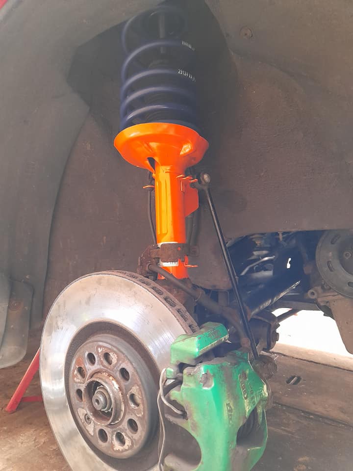

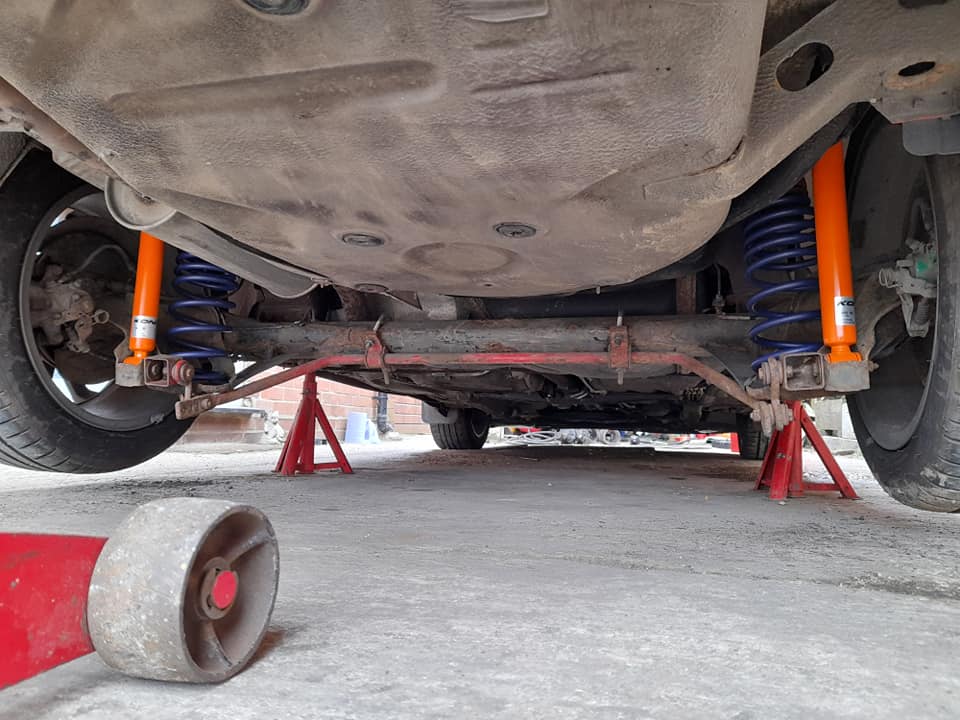

Haven't done much to the car for a while, mainly because I had to go back to work. Thoroughly inconvenient but needs must I suppose. For the last 6 months or so, I've barely even driven it, it's just been sitting on the driveway with the occasional start up. That still didn't save the old battery though, the cold winter finished that off so a brand new Bosch S4 was fitted.
It's due an MOT and service next month so time for a bit of love. Rear brakes needed attention recently as the handbrake was nigh on touching the roof before it would do anything so I gave the calipers a working over, freeing them up and adjusted the cables. The rear discs were looking past they're best so I put on a barely used set of discs and pads I had in the garage that I'd aquired from one of my breakers. All working perfectly again so that's one job ticked off the list. Also noticed the reverse lights weren't working but that was an easy fix with just a new switch needed.
I made a few quid this last month by breaking a MK4 Golf I aquired from a colleague at work so I thought I'd treat the Octavia to a nice set of brand new Koni STR.T shocks and H&R 20mm lowering springs. All fitted straight on with now issues and seems to handle nice on them, stays well planted and eliminates a lot of body roll whilst still retaining a comfortable ride.
What's the ride height like on the H&R's?
A before and after measurement at the centre of the arches showed it's now sitting 15mm lower than it was on the standard springs.

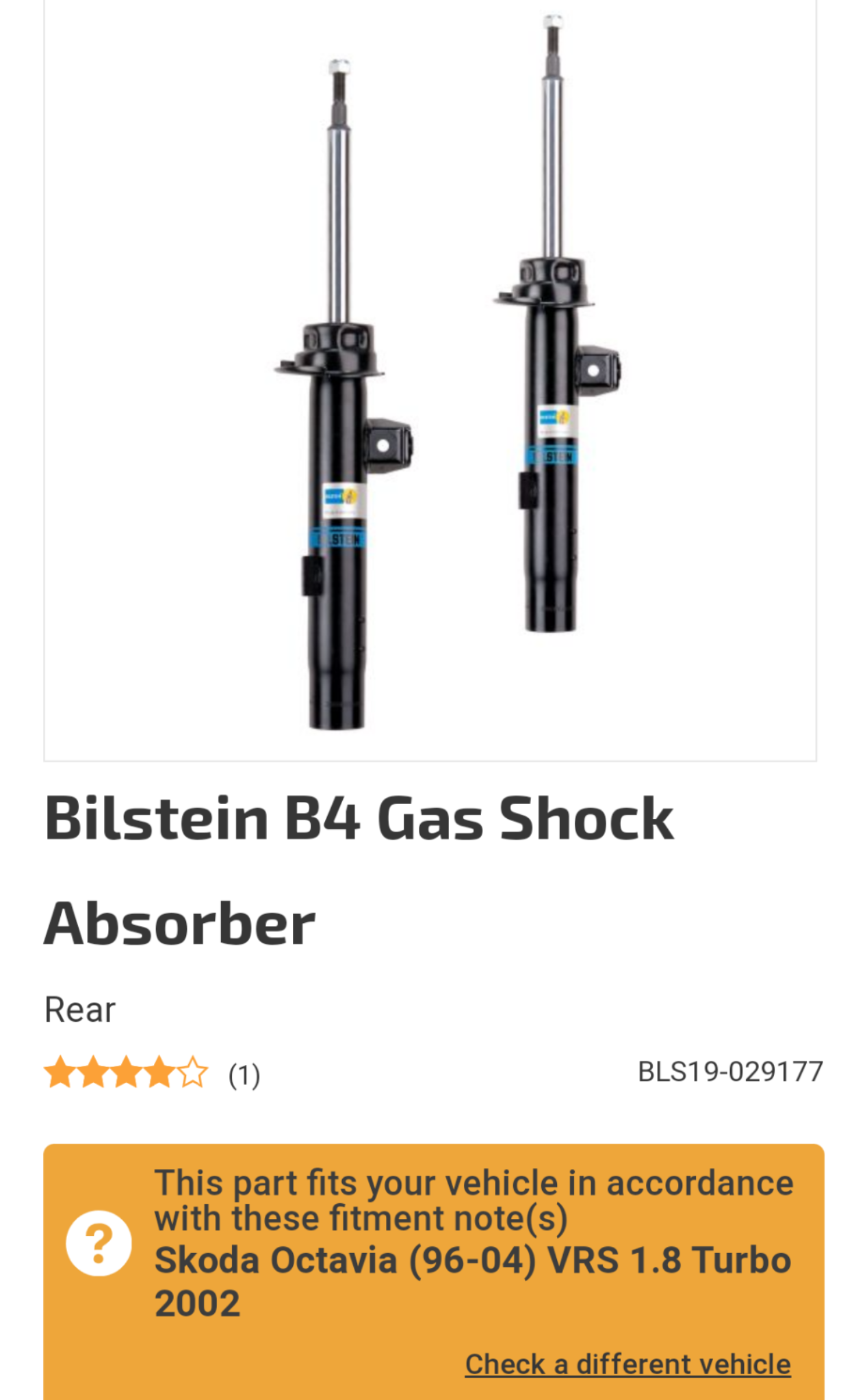

Do you know what the part numbers were for your B4's by any chance? Trying to get some for mine but a few companies I've spoken to say that B4's aren't available for the mk1.
Thanks.
Thanks.
Bilstein only list B6 and B8 for the Mk1 as far as I can see...
https://www.bilsteinsuspensionstore.co.uk/index.php
Thanks.
Demon Tweeks lists these as MK1 vRS compatible
Thanks. They are the rears which I think are the same for all mk1 Octavia models. It's the fronts I'm struggling with....
When I called Demon tweaks they told me B4's dont fit the VRS although that can't be true as nice niceyellowvrs had them on his car!
They also sell the fronts!
What part number is coming up for the fronts? The guy at DT said they wouldn't fit although the website said they would...
