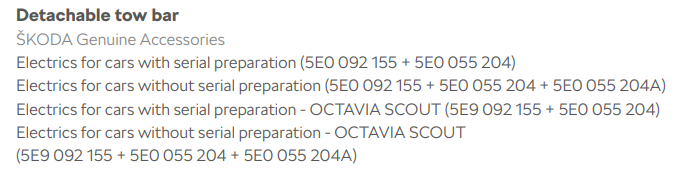

Taken from an accessories pdf:
Here are the options for your car
I have attached MY2015 for an "F" VIN
The parts are same for MY2014 with "E" VIN
Octavia 2015(F) 092-050.pdf
Beware of numbers taken from Google, the ones you provided don't always show in parts catalog.
Part 1 in document is for a fixed tow bar, and won't fit Octavia Scout
Part 2 in document is for removable tow bar 5E0 092 155 with PRCode: 7LM = Vehicle class differentiation -5E0-
5E9 092 155 is a removable tow bar for Scout only
Best follow @langers2k advice to contact a dealer, get yourself a quote (email?) and supply VIN/Registration plate to price up the job.
You can then use part list to order yourself if they send this in quote.

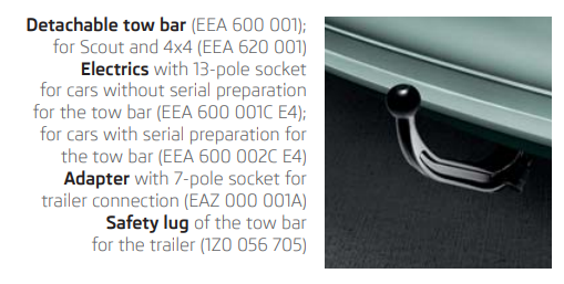

The 4x4 and Scout will likely have slight different mountings due to the rear diff.
The MK2 Octavia accessories brochure confirms it's a different part number:
I think it's also known as 1Z0092155A but check before buying.
Please note these parts are for a MK2 as that's what @greyskodahead seems to have even though this is a post in the MK3 section :)
/cdn-cgi/mirage/ca74ccc0c958c90dcfb1f2893c53ba68e43e63c06f0ba81c9f9acb2c1959ac8e/1280/https://www.briskoda.net/forums/uploads/monthly_2023_02/image.png.10916ce2cb41a5fd909bf3d61a5fc203.png
