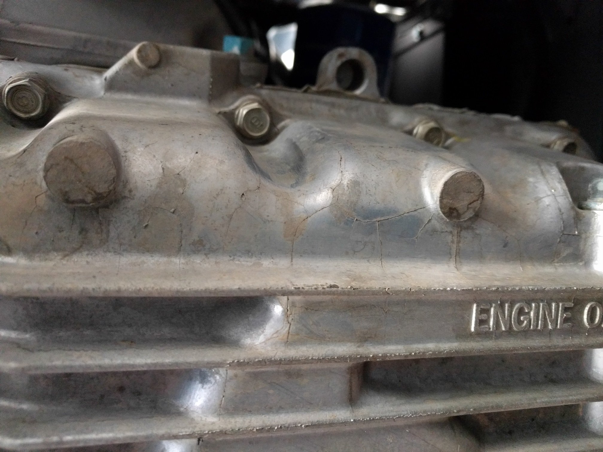

Oil Sump pan badly cracked and crazed
Photo cant be viewed, please dont assume that everyone has a Google account or is happy to give their e-mail address and password to see a photograph.
Looks more like it's got some sort of coating on that's broken up

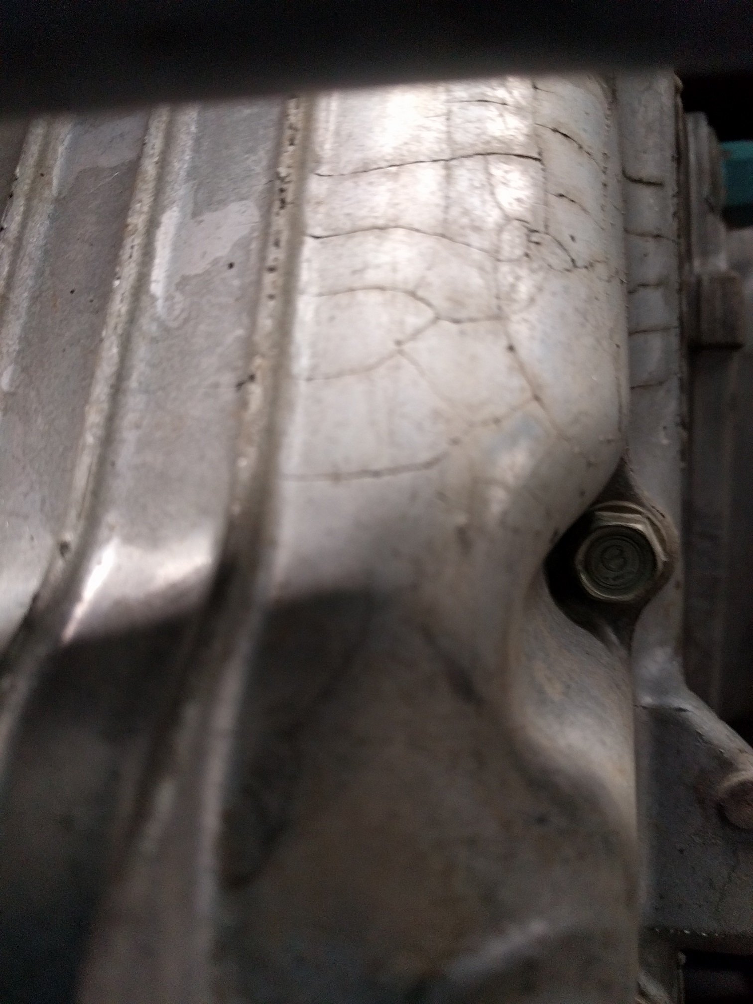

https://www.dropbox.com/s/fezhkij0e21ldss/20220915_171736.jpg?dl=0
Why the groan Jake?
If I wanted peoples views on something I would not post a photograph that could not be read.
I can view your dropbox image.

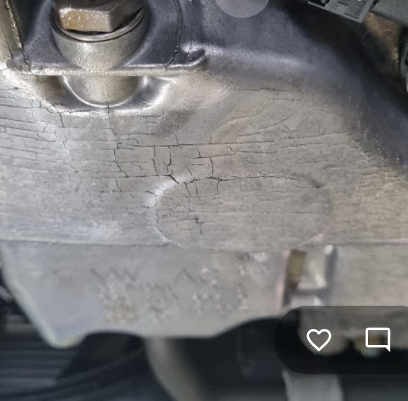

I did a look about on Google for crackled pan images, not too many about.
If this has always been this way, then here is someone's reply to this.
The reply was "That is casting flash, not cracks. Its normal."
Male bovine faeces by a main stealer!
Whilst I would not describe the marking as flash which would be found around the moulding joint line of a pressure die casting they are definitely not cracks now that we can see them in close up, they stand up in relief from the surface, shrinkage wrinkles more like.
Tthere will be a technical name for them but they are not cracks and the pan is not "badly cracked" so the comment "it's normal" is not BS.

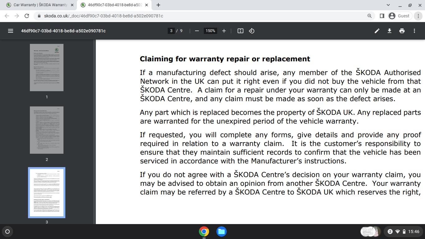

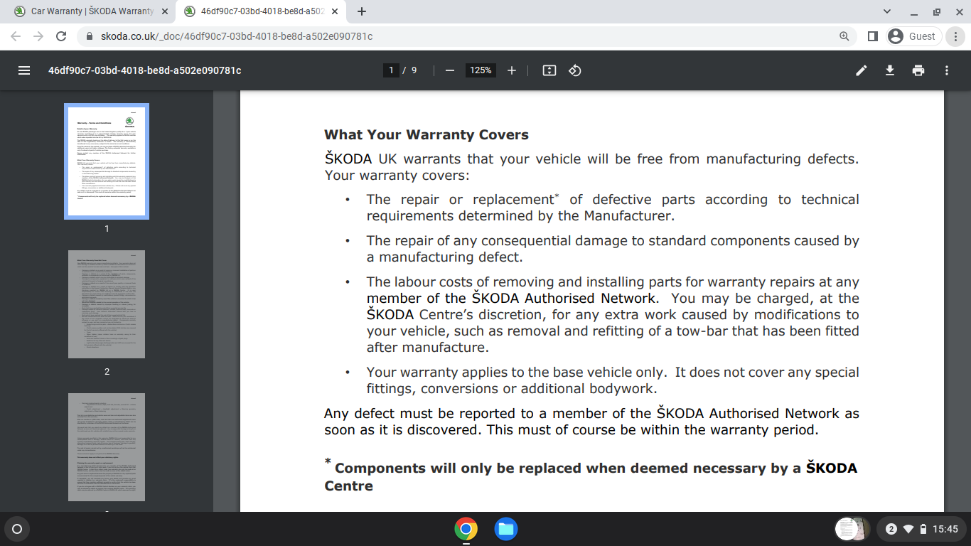

They will be getting Skoda / VW UK's Tecnical department on it, pictures, area manager inspection or any old crap they want to tell you.
Or they need to.
No re-using oil, no cost to you if a Design, Manufacturing, Material fault.  As in a Warranty Issue.
Reported to a Authorised Repairer ASAP,  and now they can do what they damn well know they need to do.
New Part delivered, if the car needs to come off the road now then a Courtesy Car.
Skoda UK can not have a car drop oil all over the Kings Highway and they know it if the sump has fractures or the risk of failing.

There are no fractures visible there, it is dry and oiltight, oil would leak from the tiniest capilliary fissure.
There are no deep canyons/cracks to expand.
1 hour ago, JakeB1941 said:
All have advised to get it repaired the quote being £361 with a re-use of the existing and new oil
I have read and re-read that, if it is not  a typo then all are advising that they should repair something on an oil pan that they claim to have never seen before and do an oil change.
If the above really is correct then they are taking you for a pigeon and exploiting your anxiety, the only way they could be repairing the surface marking would be to go over it with a linisher, £361 for an oil change and a quick polish up with an air tool, nice work if you can get it 🙄
Ignore it and them, drive your car and enjoy it!

To add a bit of weight to what @J.R. has just said, the pictures I posted earlier where from a Honda forum.
They were posted a few year's back, and nobody posted back to say their sump spat it's dummy out.

The Verdict.....l
Well done to those of you who said it was casting flash as that is the verdict from those that know (personally never heard of it) although it was apparantly quite a severe looking cast flash which to the lay person, i.e. `me` would have looked very ominous. Hey ho! wish I
had asked you guys earlier saved me a lot of grief.
It is apparantly, as someone suggested, a common condition especially on mass produced castings and is harmless.  You live and learn.
