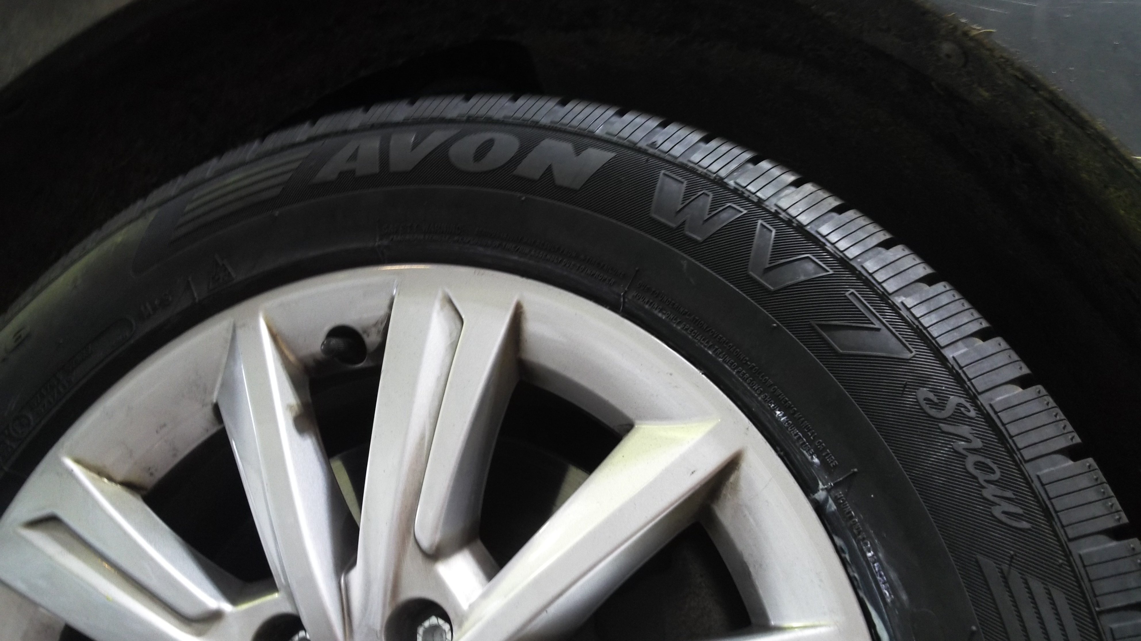

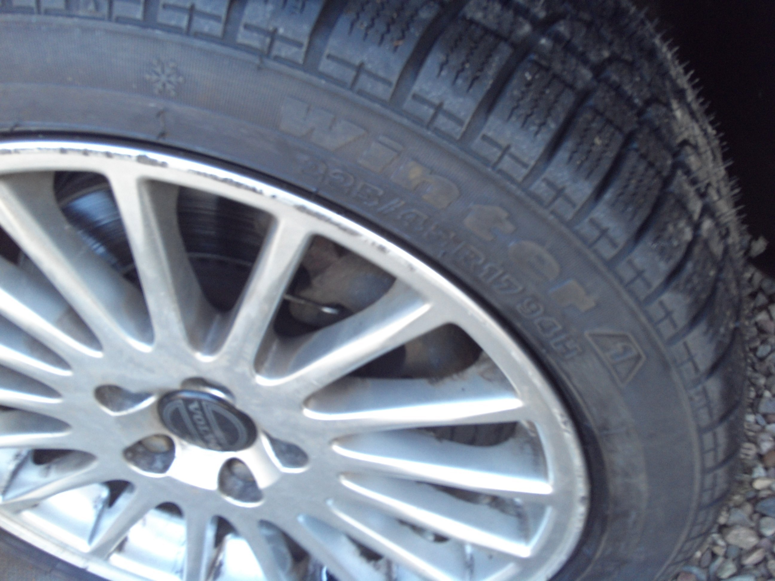

I like TIGAR tyres and have used them as i have used Kleber tyres in the past.
DSCN0331.JPG.5487eb8ac8c1f58c4646869245f2588a.JPG.2dbbca9254cd222861cc1fcdbf03fb5d.JPG.efe0e4bac14bae4286756e98f9214eb5.JPG.9c2fc8976ab7536c030465ee7f3f3c28.jpeg
5a2eec64e0886_compare2252c45R17..2152c40R17..2052c40R17026(1).JPG.ca86991f8e2e068d25e5d70ff0559866.JPG.84799fa86c96da7d58b440690aaae893.JPG.69eb0cd027f2c202d08fdb4888f896cc.jpeg
DSCN2199.JPG.30cfd32098e16a25154a4af30456981a.JPG.e51527067db144fe8bdc72e8ad5e519d.jpeg
