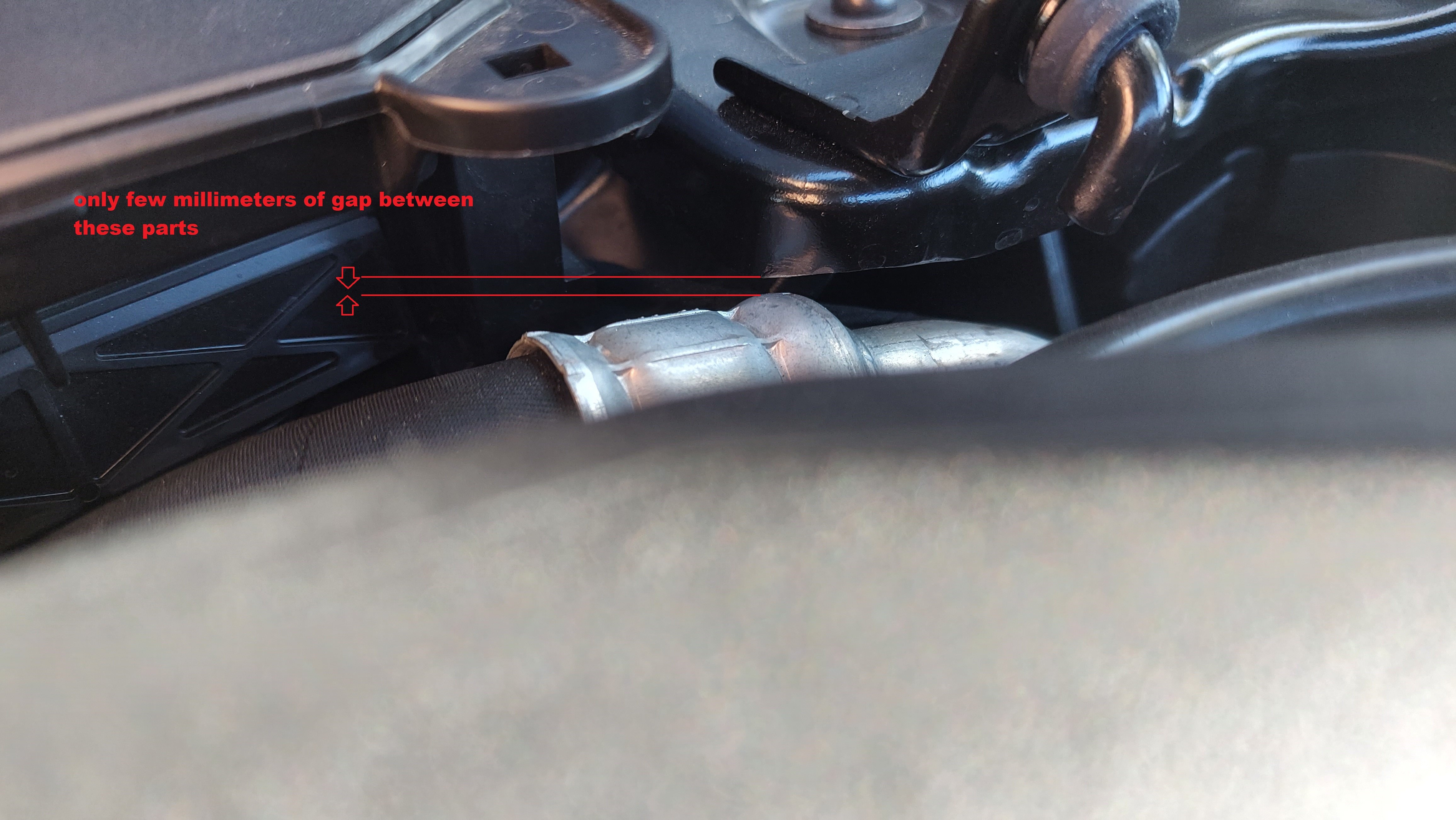

hi again lads,
yesterday, finally, i found the source of my problem (second video in my topic) on my own. i noticed that a/c aluminum pipe is loose and it was hitting to the sheet metal right under the bonnet rod root. then i followed the path of the pipe and noticed that pipe clip came off itself. it wasn't holding the aluminum pipe, which led to rattle noise. i dont know how this happened in a brand new car. so i tightened the pipe clip with my bare hands and problem is solved.😃 before that, i sent Skoda Czechia email about my problem to show how faulty car they have produced. now i am gonna also send email to Skoda Czechia regarding of solution about my problem. thanks for your previous answers.
also i really dont like the design of the pipes, hoses and cable under bonnet. they are too close to each others. tolerance for the gaps between parts are too small. in any kinds of failures just like in my car, it can lead to rattle noises.
