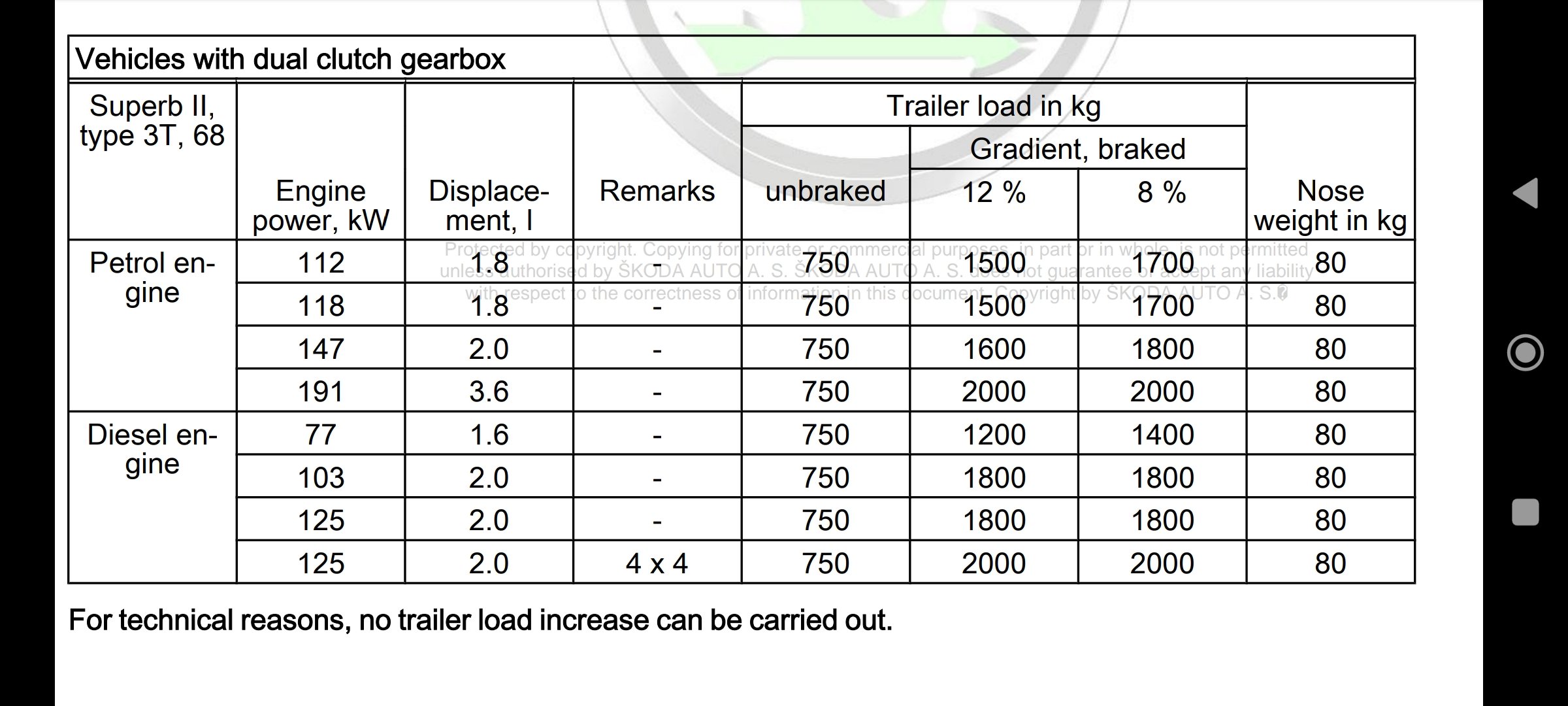

Hello, can any one advise on the towing capacity / limit for the Superb 2.0 tdi 170 DSG. There is so much conflicting advice. A lot of the web sites including Skoda advise of a maximum of 2000kgs, but the V5 shows 'mass in service - 1594', then is the permissable towing mass 85% of the cars mass? This would work out to be 1354 - is this right or where am i going wrong.
Thanks.
Official document here
2,000kg is for braked and 4x4
1,800kg for non 4x4
Both 750kg unbraked
Nose weight is 80kg

Thanks, just confusing about details on V5 about 'Mass in Service'

Technically the manufacturer will specify a limit for the vehicle and this must never be exceeded. This will be in the handbook, and in this case is 1800 kg for a braked trailer or 750 kg for an unbraked one. This is the maximum weight Skoda rate the vehicle to tow under any circumstances.
