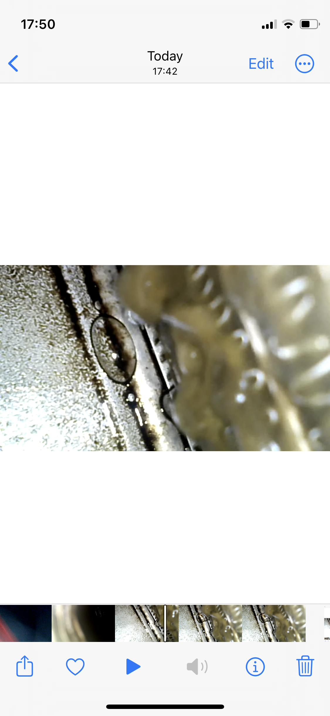

So my apparently trained Vw mechanic couldn’t find the leak. Ordered an endoscope, removed the intake air temp sensor and had a nosey. Whilst looking inside a few drops of water rolled past the camera, so looks like it’s my charge air cooler leaking! Easy to check with a wee endoscope if they can’t get to the bottom of it.
