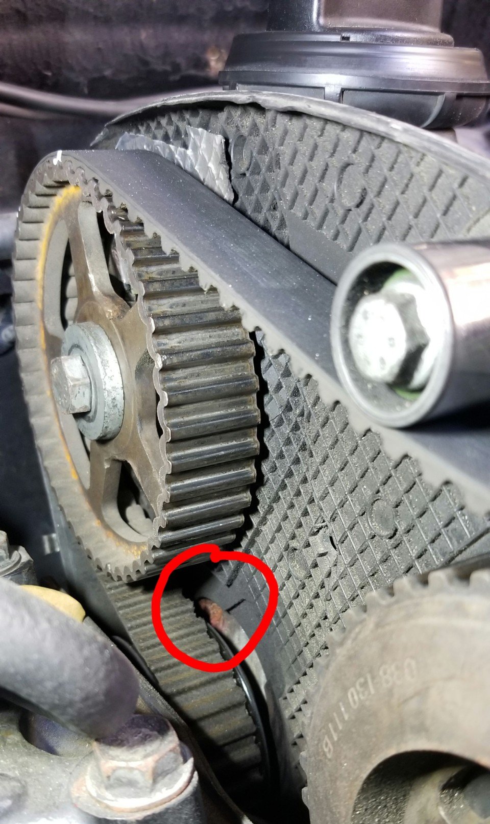

after leaving the car parked for one month, when i used the car some days ago, all good, but the next day the coolant level light bring up, in effect there was no coolant in the reservoir, i found there a leak from below the car, i pour some demineralized water just for the moment, and i used the car and all good, and when i turn it off two minutes later then the start to leak fluid, i tried to follow where the fluid was leaking from, and i notice it came from the cramfhasft pulley...
i did remove the timing belt cover to see if i see something regarding the water pump, and i saw no much but i saw a rusted area that was moist (like if the water were crossing over that area from an upper part... maybe fromthe pump, but that area is not directly below the pump....

before attempting to disarm i notice there was a leak below the camshaft pulley, so is not the water pump
