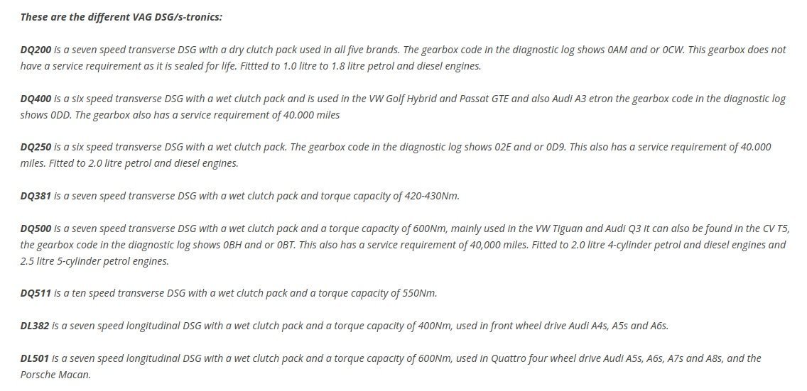

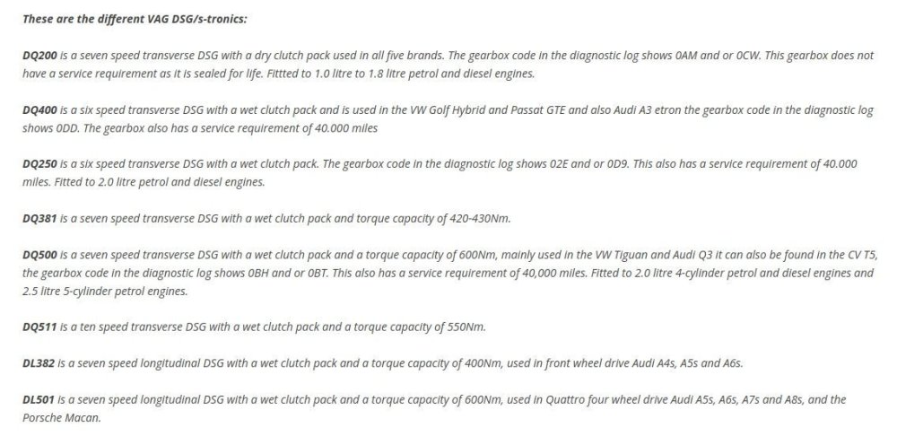

so i heard at some point the dsg dry twin clutch plates were given 'oil' to run in ?
when did that happen and can i tell if my 12 plate has them ?
the oil plates are apparently more reliable
any thoughts please
tom
ok i now know from the haynes autofix on-line only manual
2.0 TDI or TSI never had DQ200 Twin Dry Clutch DSG's.
Just cars / vans with 250 Nm or less.  1.0, 1.2, 1.4, 1.8 TSI's, 192 ps or less FWD or 1.2, 1.4 or 1.6 TDI FWD,s.

toot ... thank you ... i know have all the info on the DQ250 ... so many possible numbers for this stuff
