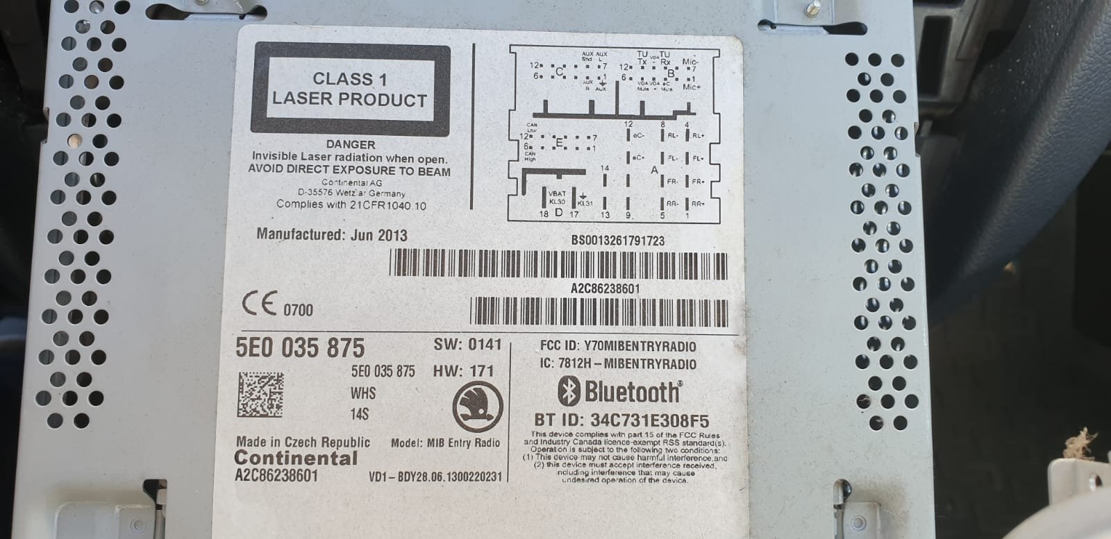

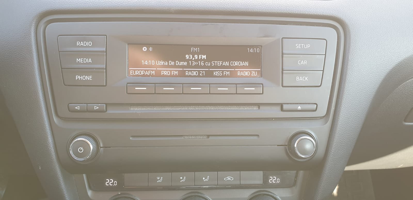

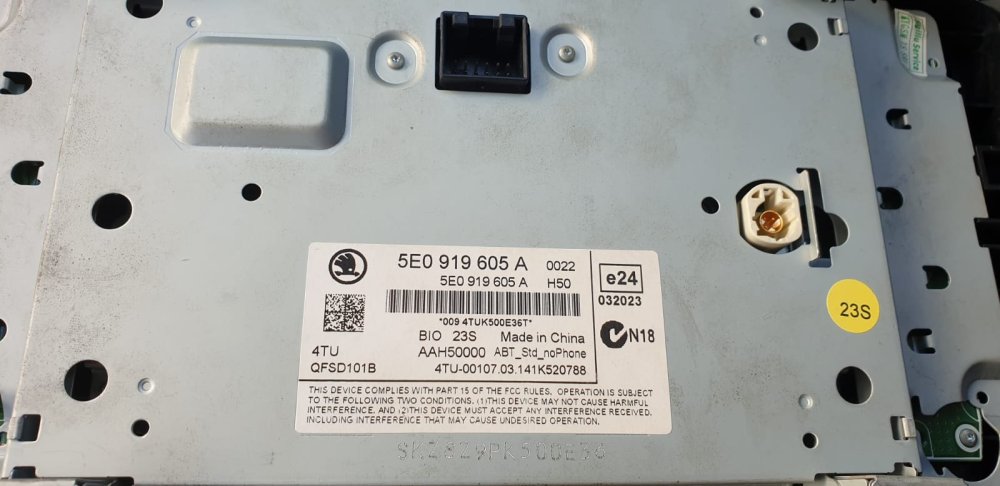

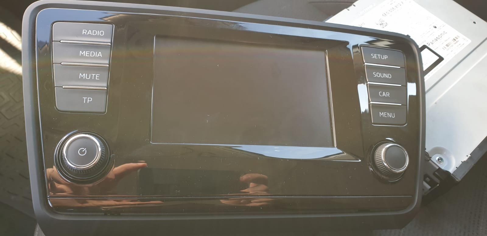

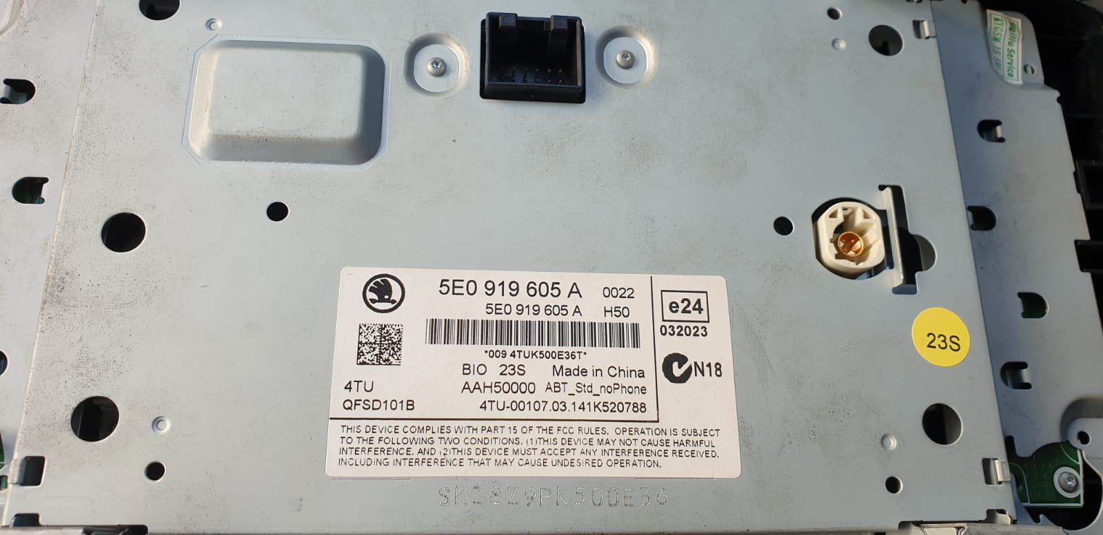

Youll be moving from an all in one system to a mib2 system.
For this youll need a fakra hsd cable, a mib extension cable as well as a new glovebox.
I hope youre also aware its far from plug and play - component protection needs removing, swap codes, correct datasets, correct adaptations
