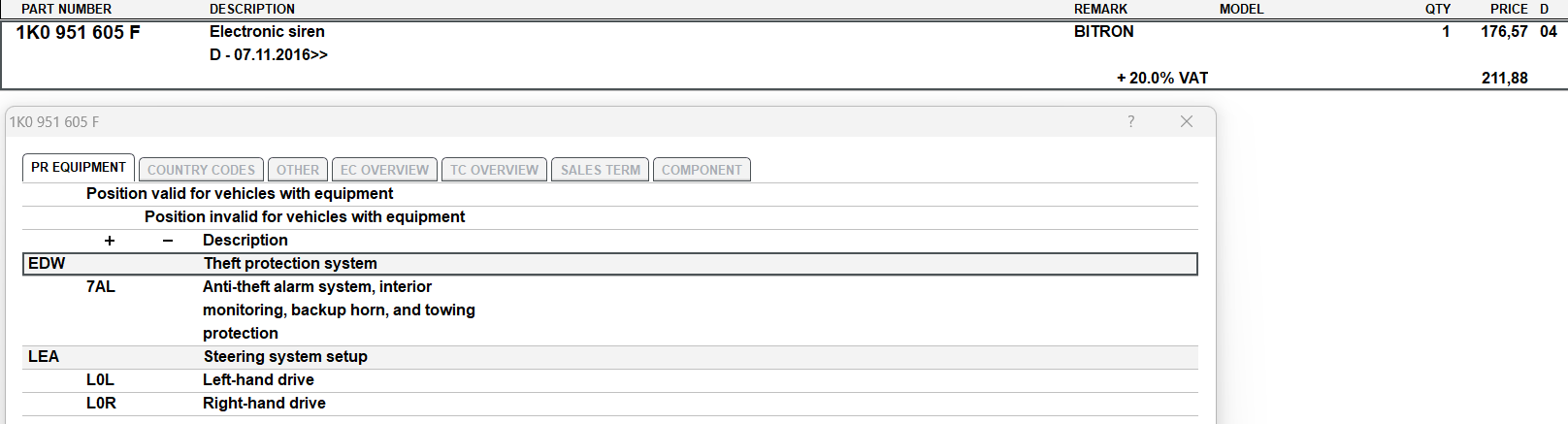

Both original and new parts are using the same PR-Code 7AL
So that means interior monitoring is supported.
I'm wondering what can be the problem then.
It would appear the sensor is not picking up things inside.
How did you test the interior sensor?
Nevermind, I was just too impatience when testing. There is a delay after lock/display off before it activates interior monitoring. It works perfect. ✌️
