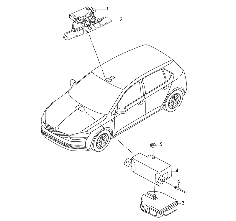

  5. Hello. I need help with replacing alarm/siren module on my Seat Ibiza 2011, which uses same components as whole VAG group including Škoda so you may help. Originally manufacturer installed 1K8951605B. As I understood it's been later replaced with 1K0951605C, then 1K0951605F. I replaced my B version with this new F version. Lock/unlock beeps works but interior sensor wont trigger the alarm. I've checked options with OBDeleven and all seems OK, enabled, configured, but alarm doesn't work. May it be that this F version I got doesn't support interior motion sensor? Can this be checked by hw/sw versions or other codes on the device? Any idea?

  7. When I trigger alarm on my car only lights are flashing and no sound. DTC stored: 1134 Audible Alarm-H12, Alarm horn-H12 Anyone knows if this could be the battery only? Or sirene is dead?

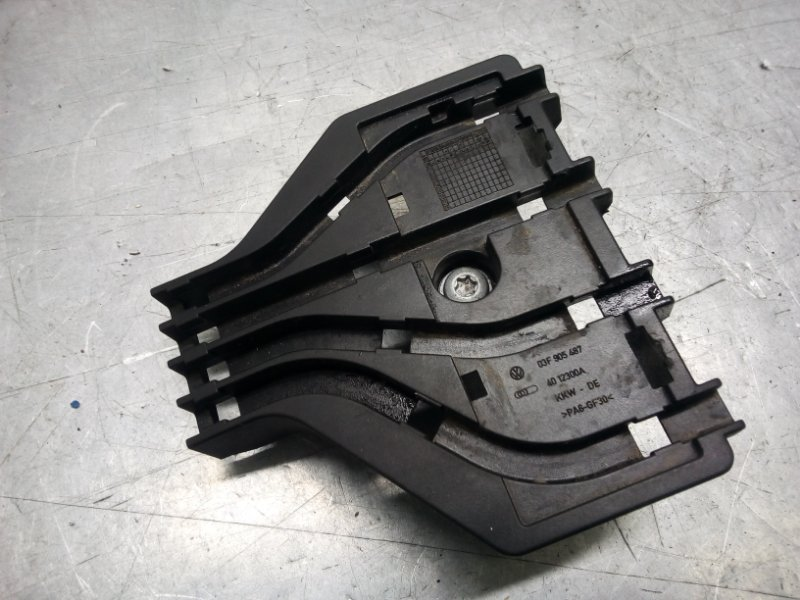

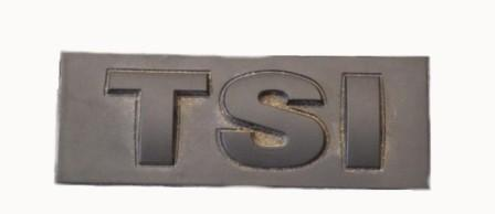

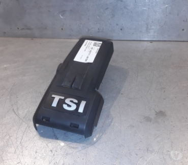

  9. I've lost my Ibiza 1.2 TSI 2011 ignition leads cover / cap 03F905487B [IMG]https://i.imgur.com/ANZecq7.png[/IMG] Can I replace it with 03F103935 which is used on 07.11.2011>> produced cars? [IMG]https://i.imgur.com/AxkR35D.png[/IMG] I believe it fits on the same ignition cable holder but need someone to confirm this [IMG]https://i.imgur.com/zUONF3J.png[/IMG]

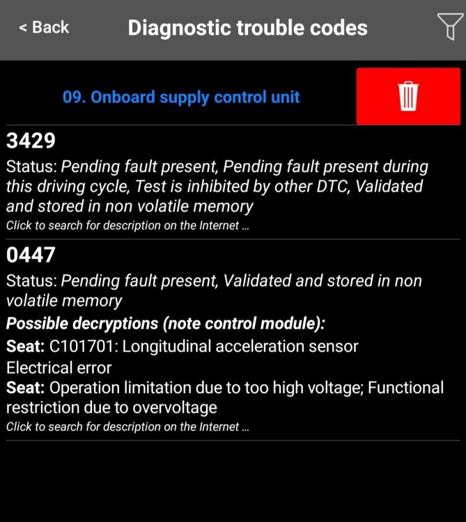

  10. Just scanned my Ibiza's ECU for errors, no DTCs found. Mentioned errors are gone for now, not coming back after last deletion. I hope it will stay like that.
  11. Hi @KenONeill I've checked voltage as you suggested. This morning, when the engine off it was 12,3V. After starting the engine it was 14,7V and stable. So I guess it's everything allright. I'll just forget it for now as there is no check engine light nor any noticeable problem with the car. Thanks.
  12. I had these saved in ECU, but no engine light, any warnings nor noticeable problems with the car. If deleted they come back. The car is Seat Ibiza 1.2 TSI 2011 Ecomotive. Any idea on what this can be? Thanks. [IMG]https://i.imgur.com/sYcSw6O.jpg[/IMG]
