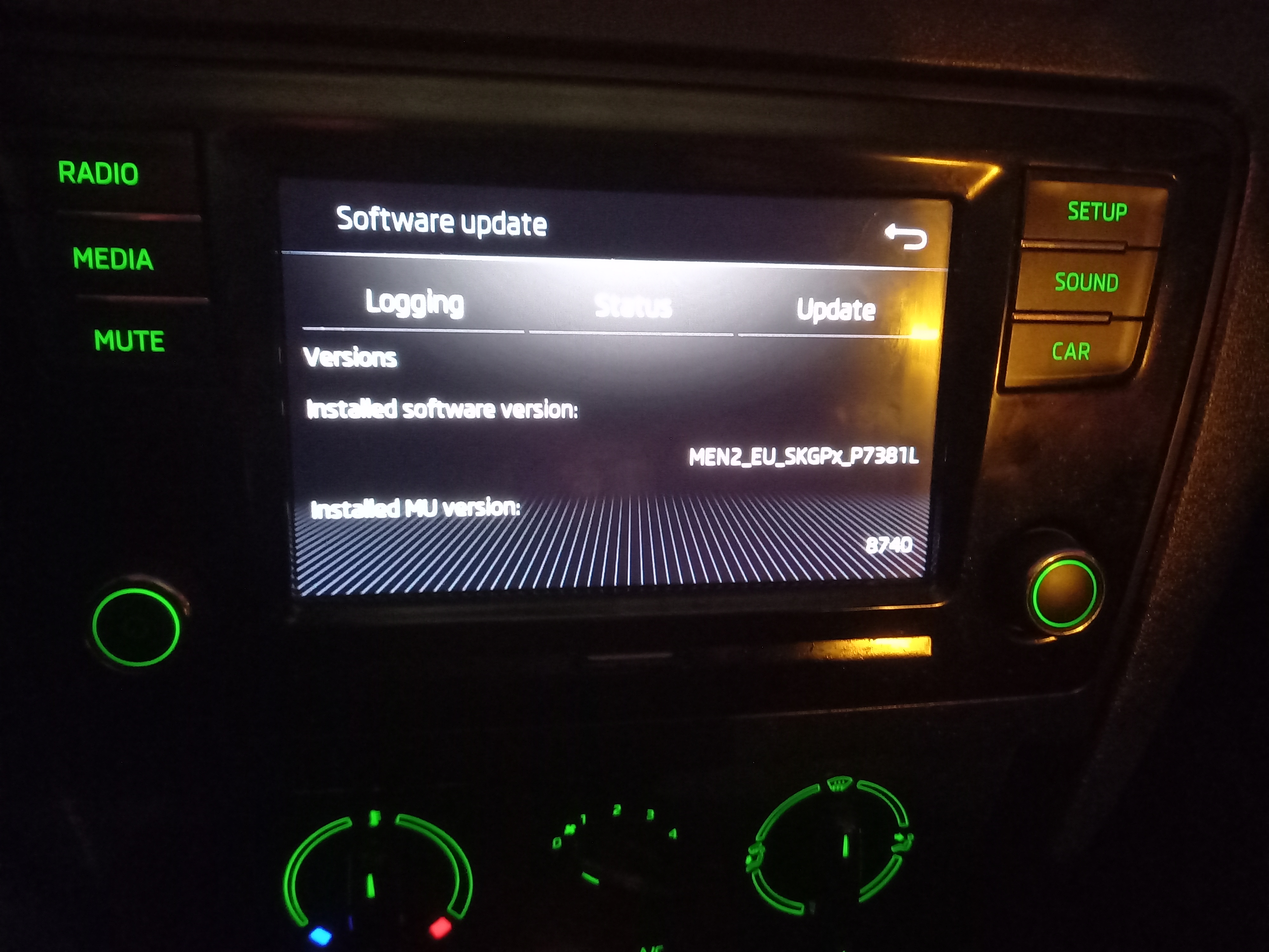

  2. how can i upgrade from 8740 to 8755?
  3. HI all I have mib2 entry, MEN2_EU_SKGPx_P7381 "multimedia" produced by LG. on skloda Rapid 2018 Device code 5ja 065 867 F hardware 680 software 8740. Is there posibility to hack it? Install aditional functions and reaeview camera? 10X

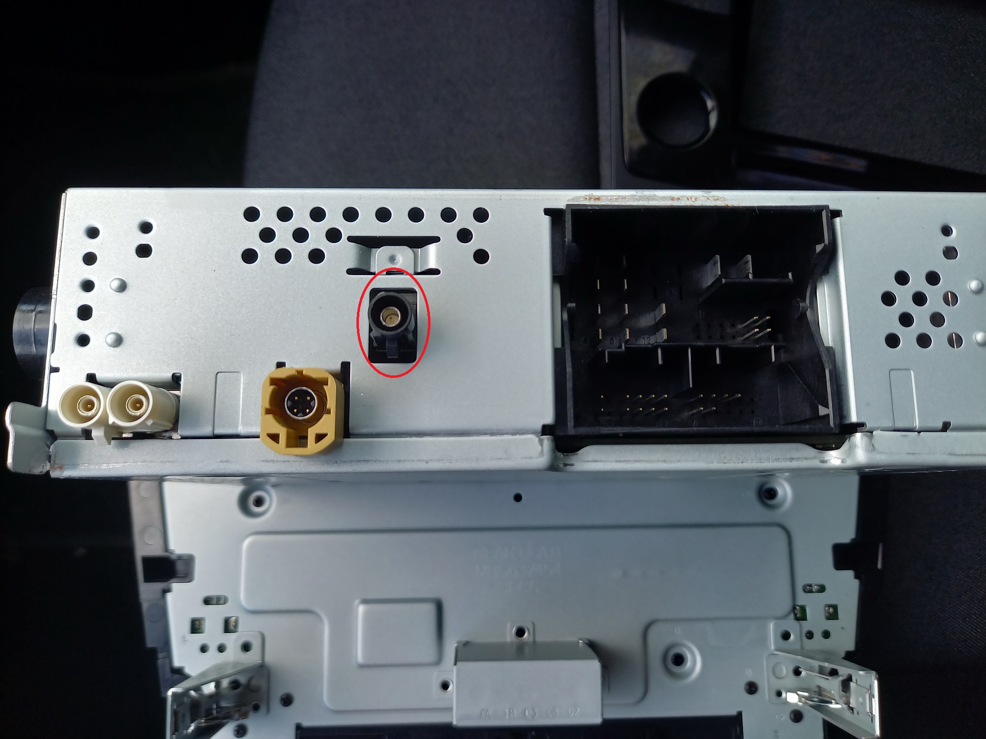

  5. Hi all, can someone explain to me what the plugs on the back are? I know quadlock and yellow one for usb, white i presume is antenna (fm and dab), but what is the one in red circle?

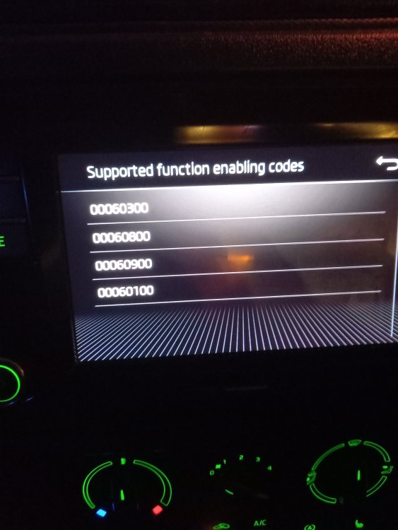

  8. Hi all, I need help to enable supported function of my mib2, and software update. 10Q
