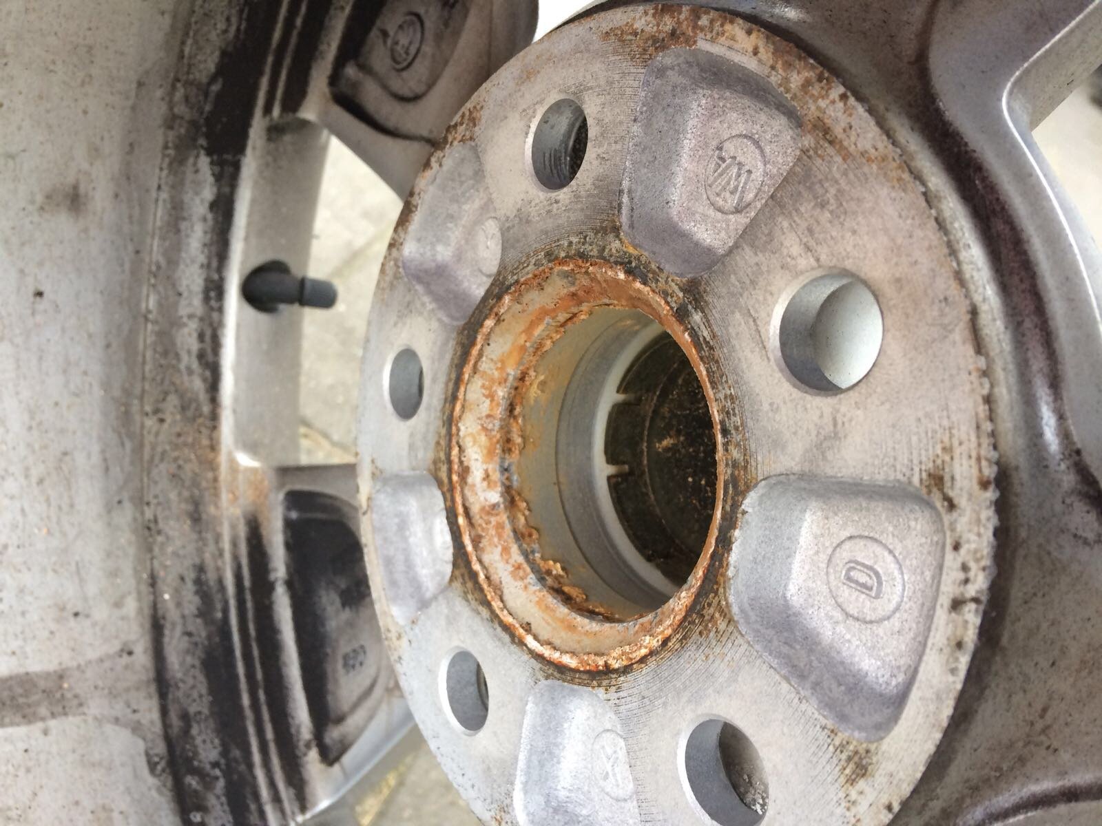

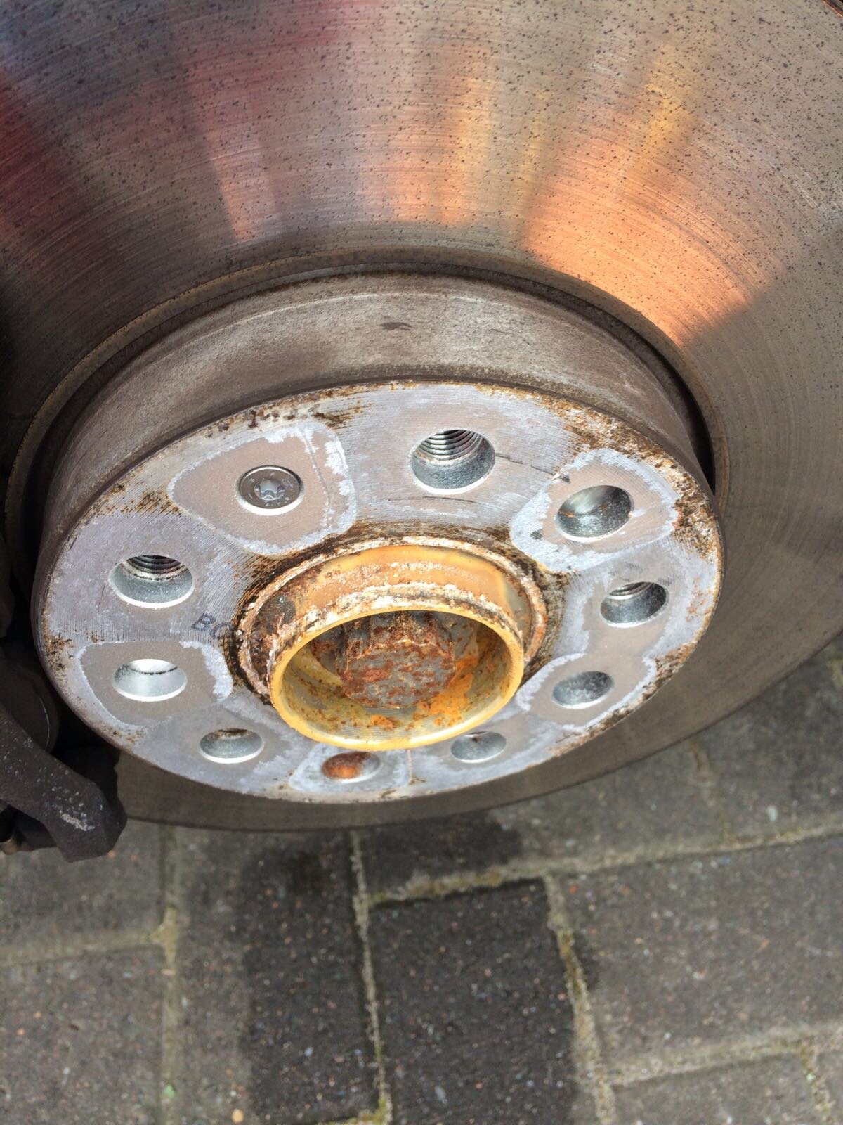

Alloy wheels tend to corrode up against the hubs.
Hence we put a bit of grease between them and do not leave them on for 3 years or more from them being fitted at a factory and even with Full Main Dealer Servicing they might never be off for even more than 3 years.
Servicing pre or post winter or both is Simply Clever and make sure with cars that if you get a puncture you can change a wheel, which means being able to get it off the car.

@Carlston That is good.   What a pity everyone has not you at their side when they find out about dissimilar metals.
I have never struggled to remove wheel spacers.   You just learn things in life as you go along.
