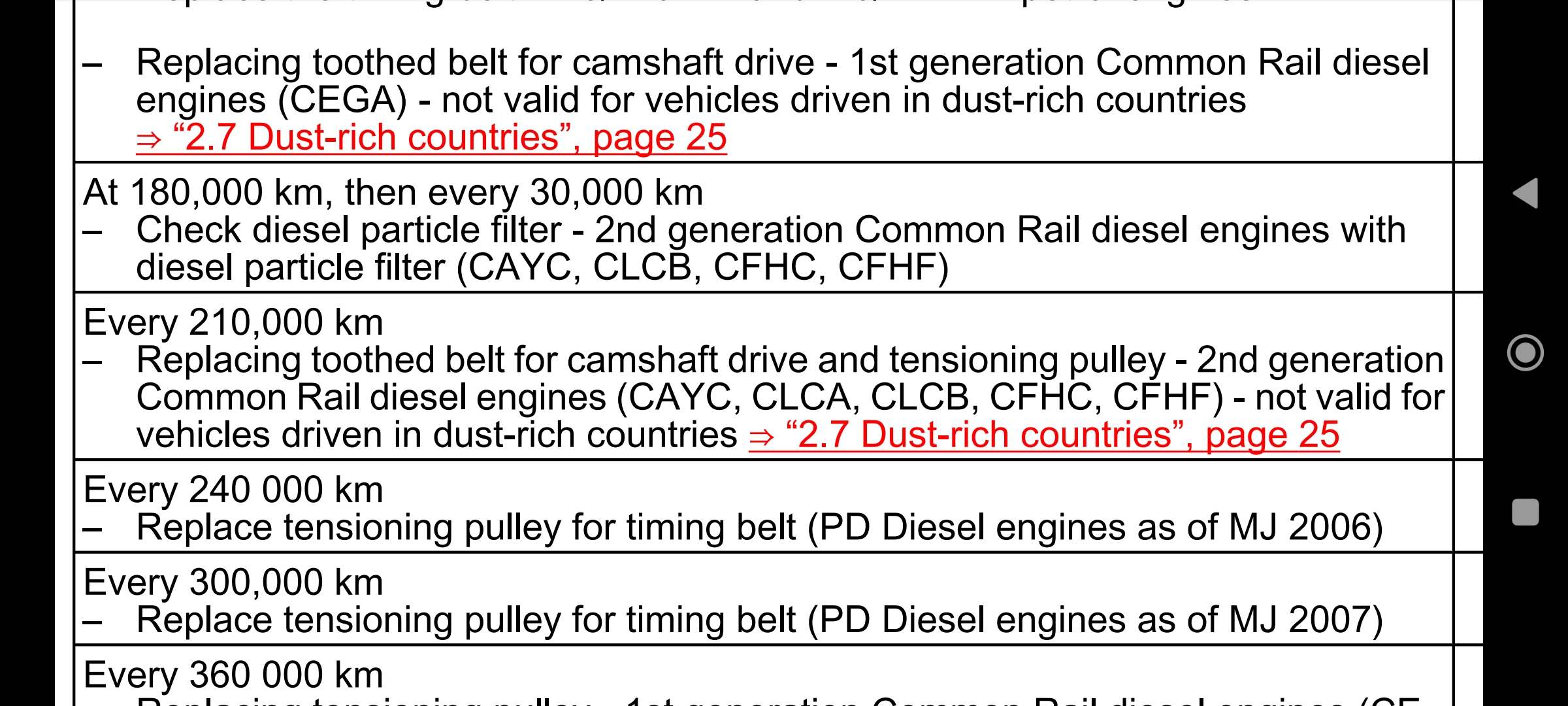

That's a CAYC engine (they are only 3-4 digits)
Answer is 210,000km, time shouldn't be a factor.
Screenshot_2023-01-07-18-18-38-893_com.google.android_apps.pdfviewer.thumb.jpg.2c203de9571001823cd977d68c107cd3.jpg
1 hour ago, varooom said:
Fantastic , so I changed 2017, don't do loads of miles then 2 years of covid so well within its life 😁
