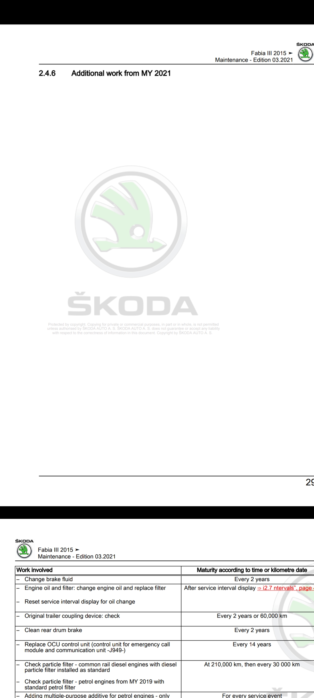

From MY2021 it's every 2 years.

Here's the document, I didn't write it, but only answered the OP's question.
Screenshot_2023-01-12-11-44-42-686_com.google.android_apps.pdfviewer.thumb.jpg.e9fb9639d807056301acb8516b291668.jpg
Edited by varooom
