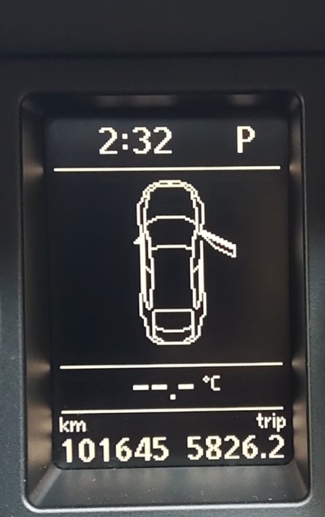

Anyone please help me my car ambient temperature is not working.

Yes sir when I on the ignition also it's same issue happening out side temperature not showing
As mentioned in your oil sensor thread, you need to really get a good fault code reader on the car to show wiring defects (short to Earth for example) VCDS is a good scanner, but there are alternatives.  Cheap scanners are only good to be used as a hammer, as they often cannot read the codes correctly, if at all!

Now I've rectified the issue problem is sensor wire is damaged due to rat bitted the wires. And the sensor location is left side bumper grill
