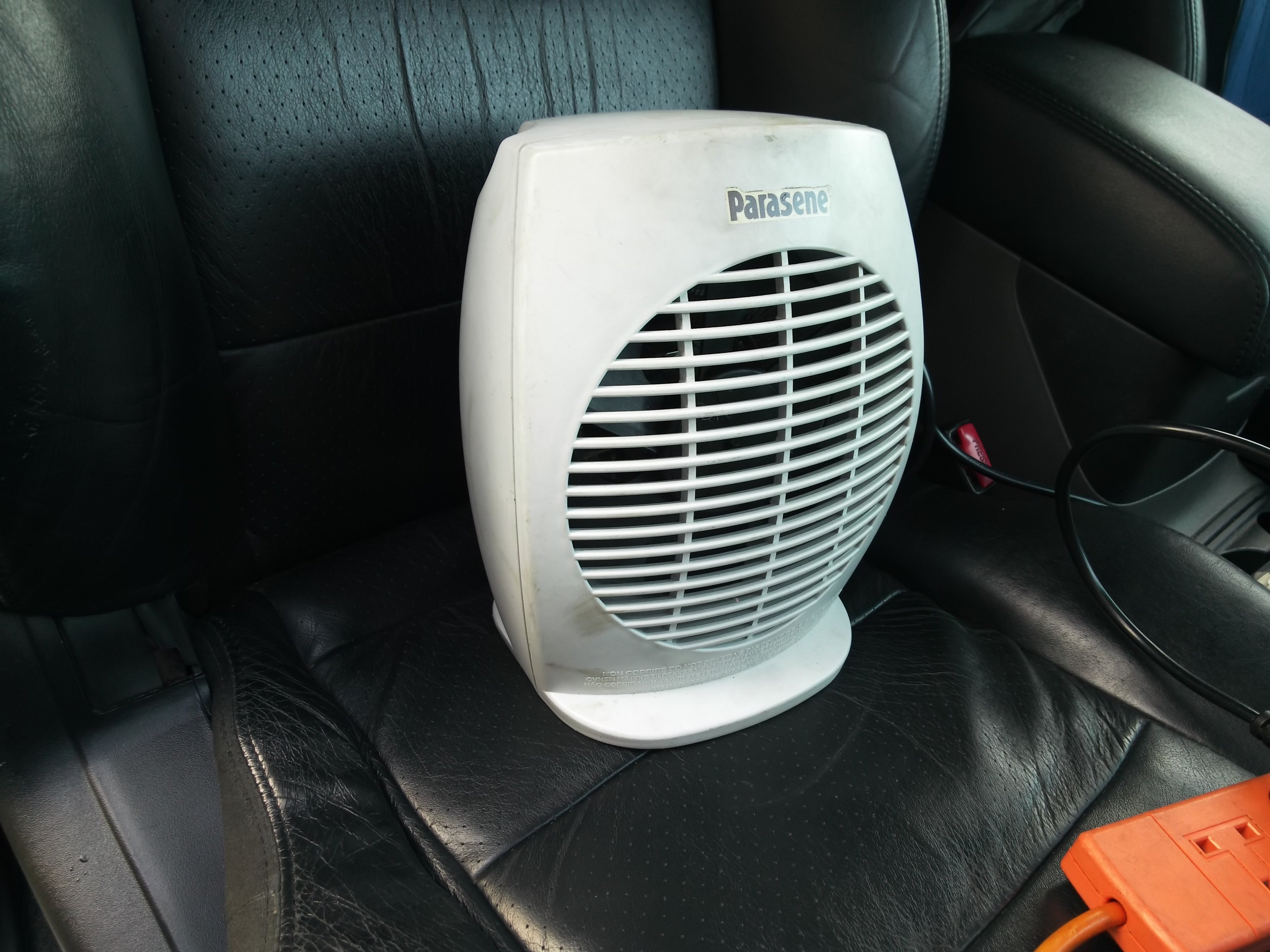

Use a greenhouse heater inside with the windows a little open when parked.

DSCN4339.JPG.1597a7d34cbd994683a480bf945b374a.jpeg.f0f748bb61c39e3da4e3ba327c9be896.jpeg
DSCN2443.JPG.94768b4a6a1110d290932694524a3b7b.jpeg.bebb2c277f3890cd70d2a2b77f6d424d.jpeg
