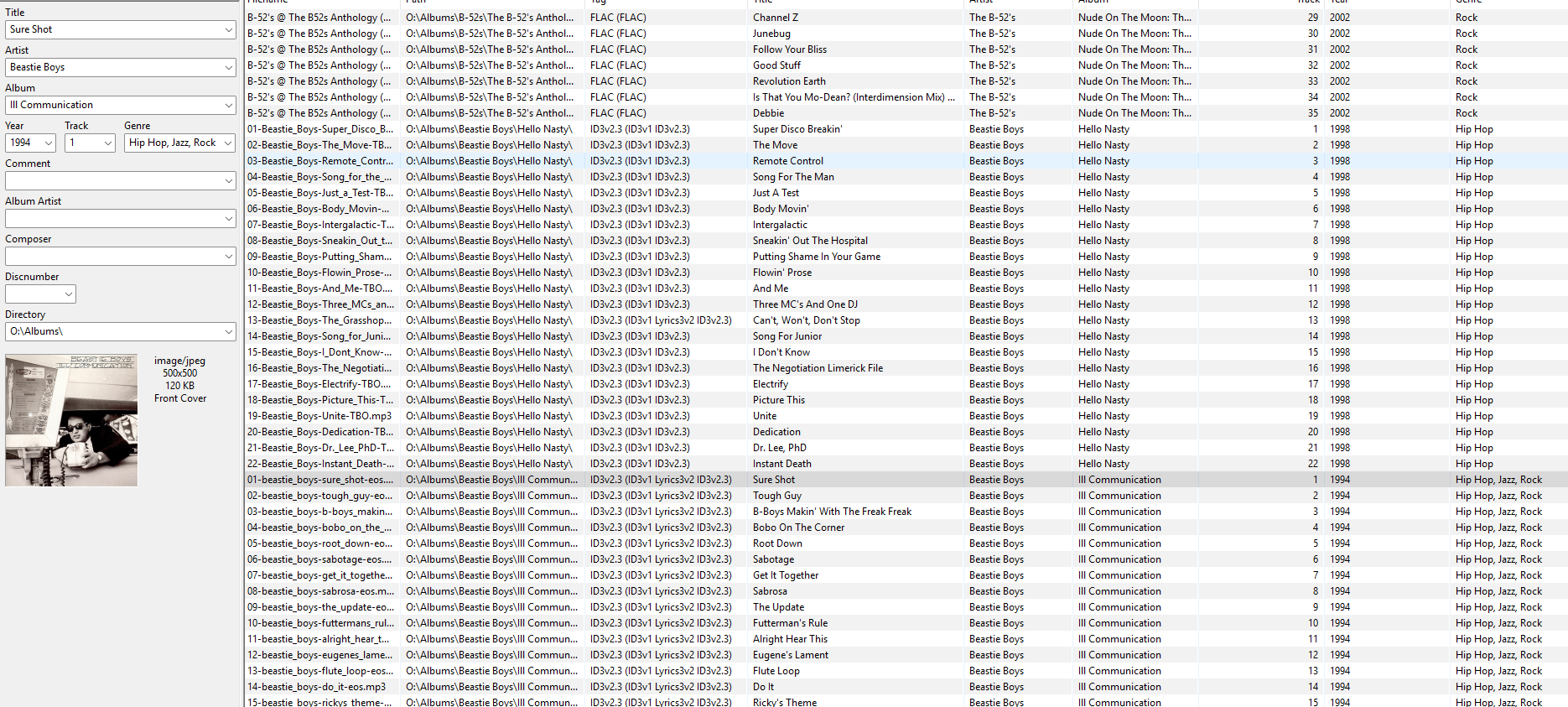

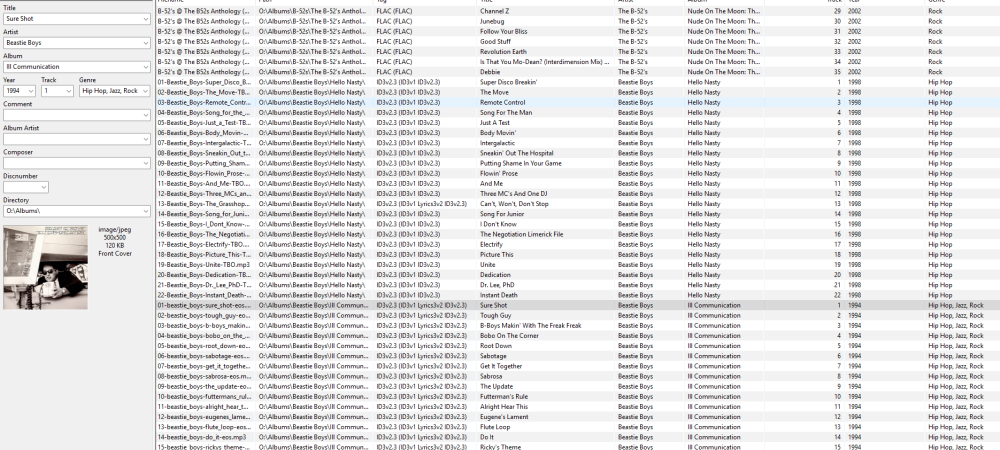

  4. I've got about 200 albums setup on mine and not using album Artist for at least 90% of the tracks I've been using a Kingston Data Traveler 80 USB Stick (256GB) formatted to ExFAT with single partition. data is in the below order: \\Albums\Artist\Album name \ Tracks i.e. O:\Albums\Beastie Boys\Hello Nasty\01-Beastie_Boys-Super_Disco_Breakin.mp3 O:\Albums\Beastie Boys\Hello Nasty\02-Beastie_Boys-The_Move.mp3 ....etc O:\Albums\Beastie Boys\Ill Communication\01-beastie_boys-sure_shot.mp3 O:\Albums\Beastie Boys\Ill Communication\02-beastie_boys-tough_guy.mp3 ...etc O:\Albums\Biffy Clyro\Only Revolutions\01-biffy_clyro-the_captain.mp3 O:\Albums\Biffy Clyro\Only Revolutions\02-biffy_clyro-that_golden_rule.mp3 ...etc MP3 tag is setup with just the below metadata Title Artist Album Track Year Genre And Tag type is mostly "ID3v2.3" Normally if I remove the USB and plug it back in it can take a couple of on/off times of car ignition (getting in/out) to index all my tracks correctly into the sub menu's "Artists/Albums/Genres" on the media centre lists. If your setup matches that I would say its either the USB Stick your using or something wrong with car infotainment. When I was first setting mine up for my Mk4 after moving from Mk3 I was trying to use an external M2. SSD drive and that just would not work at all properly. think there was some incompatiblity between the SSD drive hardware and car. Just wouldn't read correctly. I read a few forums where there was a lot of discussion about different USB stick models. Some would work, some wouldn't
  5. In terms of the formatting I never found NTFS to work well when I was setting up my usb stick when I had to move from my MK3 to MK4. Most usb chatter on internet state FAT for up to 32gb and exFAT for anything bigger. As a general question. Have you set the Meta data clean and correct for every single music file? I use MP3tag to make sure each track has the right data as the car uses it to index. The key items I make sure are done are Track name - track number followed by track name Album name Artist Track number Genre Add 500x500 max size art to track (instead of album picture in usb folder) This will then allow car to index tracks correctly into the folders Albums Artists Genre Etc I would then access via media folders by going into the album folder and all tracks from folder would play in right order. Or while my voice worked say Play album "Queen's greatest hits" Play song "Free bird" I had loads of issues with the metadata to start with. If it's not correct it sticks loads of tracks together and your issues sound more like metadata problems. P.s. it can only handle 1 instance of say "greatest hits" in album name and groups all albums together no matter artist. So you need to make sure every album name is different Using the above mine works on a 256gb usb on both my Skoda and new VW ID.7 Hope this helps
