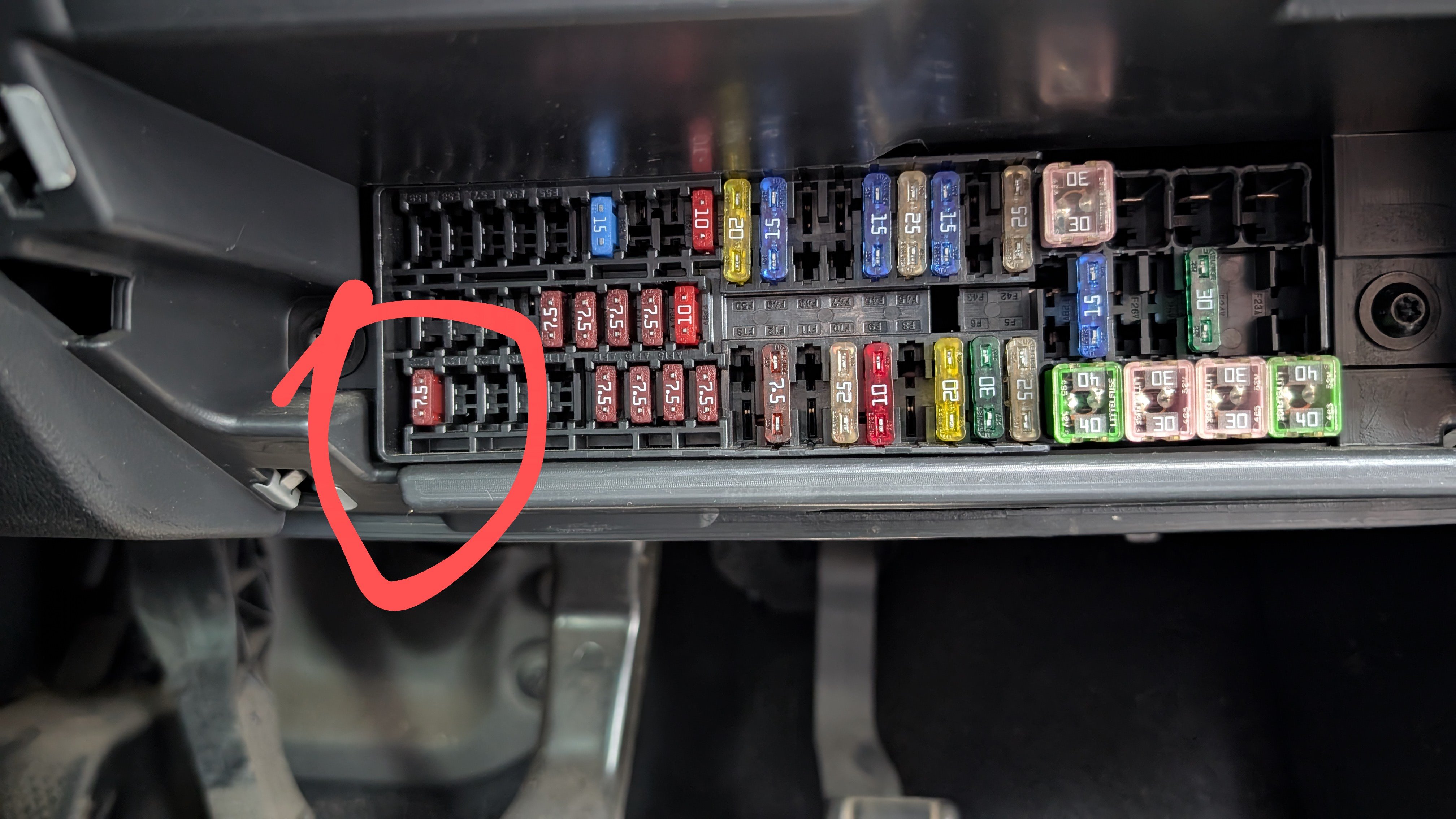

I have a Skoda Rapid 2015 UK. I spent some time finding the issue. After changing tea pump, it didn't run. So I assumed that it doesn't get any power. The fuse diagram from the car manual is useless. After hours of tempering I found the fuse that was blown.
I hope it will help someone.
