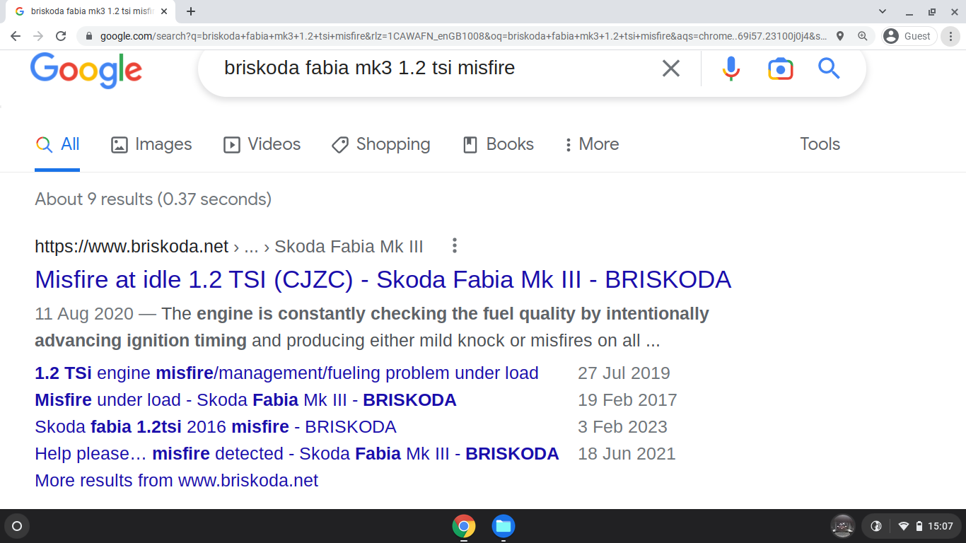

http://briskoda.net/forums/topic/506382-12-tsi-running-rough-after-cambelt-change
