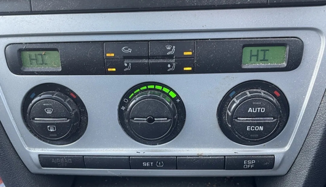

Have you got automatic climatronic or manual AC controls?
You can swap to the facelift climatronic onto the older cars with just a pin swap on the wiring harness.
This is the unit in my vrs.
