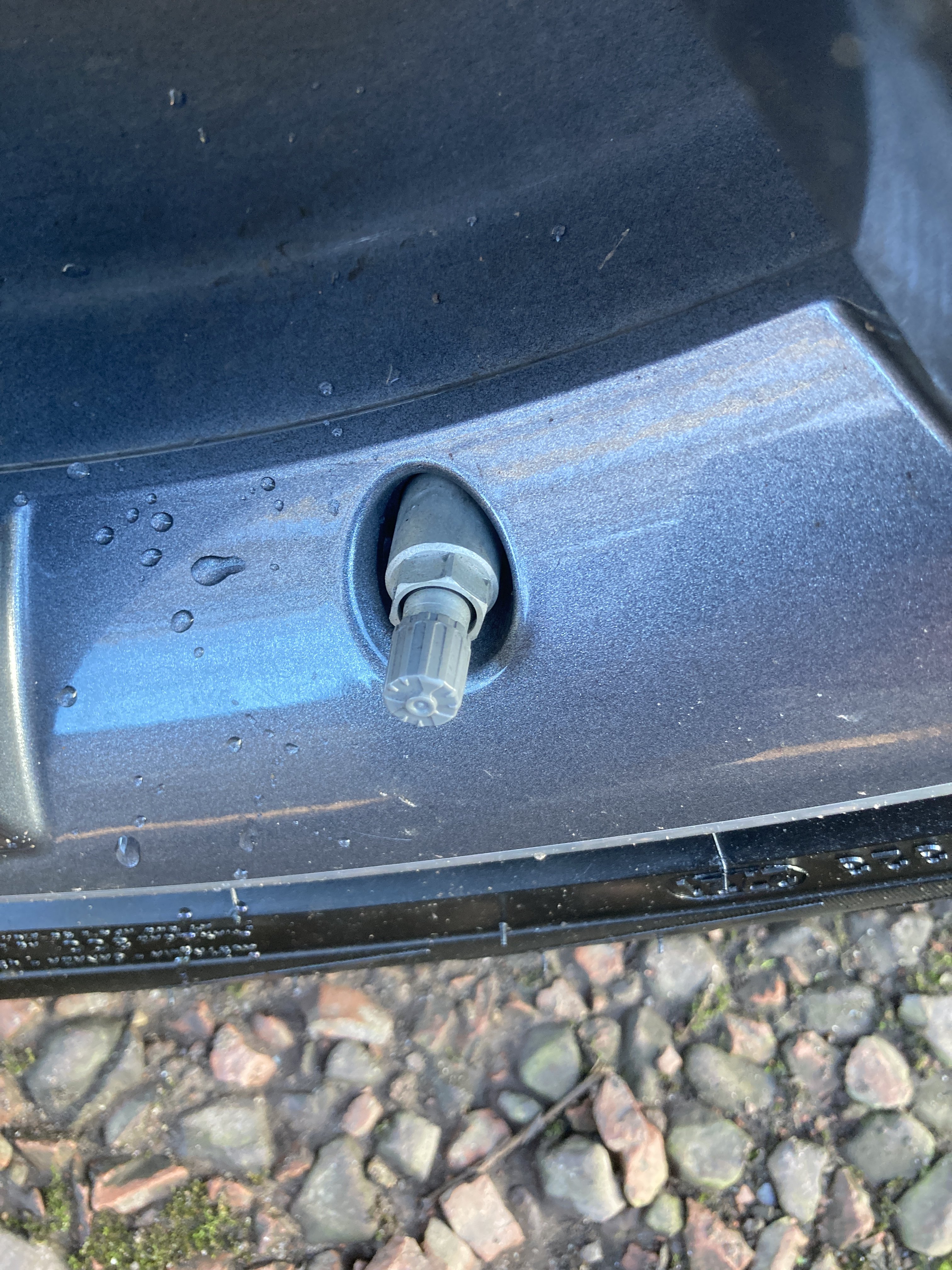

TPMS - how do I tell which type?
I have a 2018 Mk 3 Fabia. How do I tell whether the TPMS is ABS type or sensors inside the tyres?
The TPMS is standard and does not come as sensors inside the tyres with a Skoda Fabia.
You get that sensors in the tyres more recently with a Kodiaq or Superb. You can identify that by how the valves look.
Picture pinched from  a post by@Kenny R
