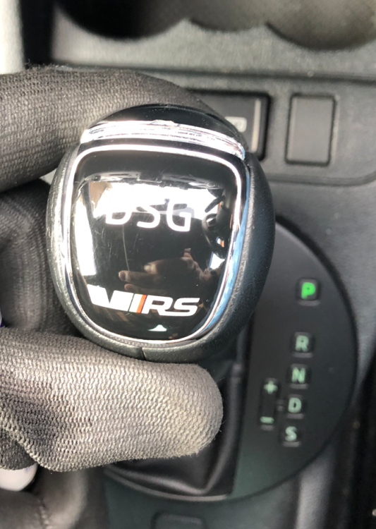

2014 1.4 dsg vrs gear lever knob and gaiter swap ??
Before I proceed to renew my worn knob and gaiter I'm researching how to remove the existing knob and gaiter, I know how the gaiter un clips around the base what I'm finding difficulty in determining is how the actual knob and chrome lever are removed, Haynes manual is just generic poo on the subject.
Anyone have experience or knowledge how to remove it.
As ever any assistance welcomed 🙂

unclip the gaiter, lift it as high up over the handle, should reveal a clamp as in piccy above, then also disconnect the plug to the selector indicator.
